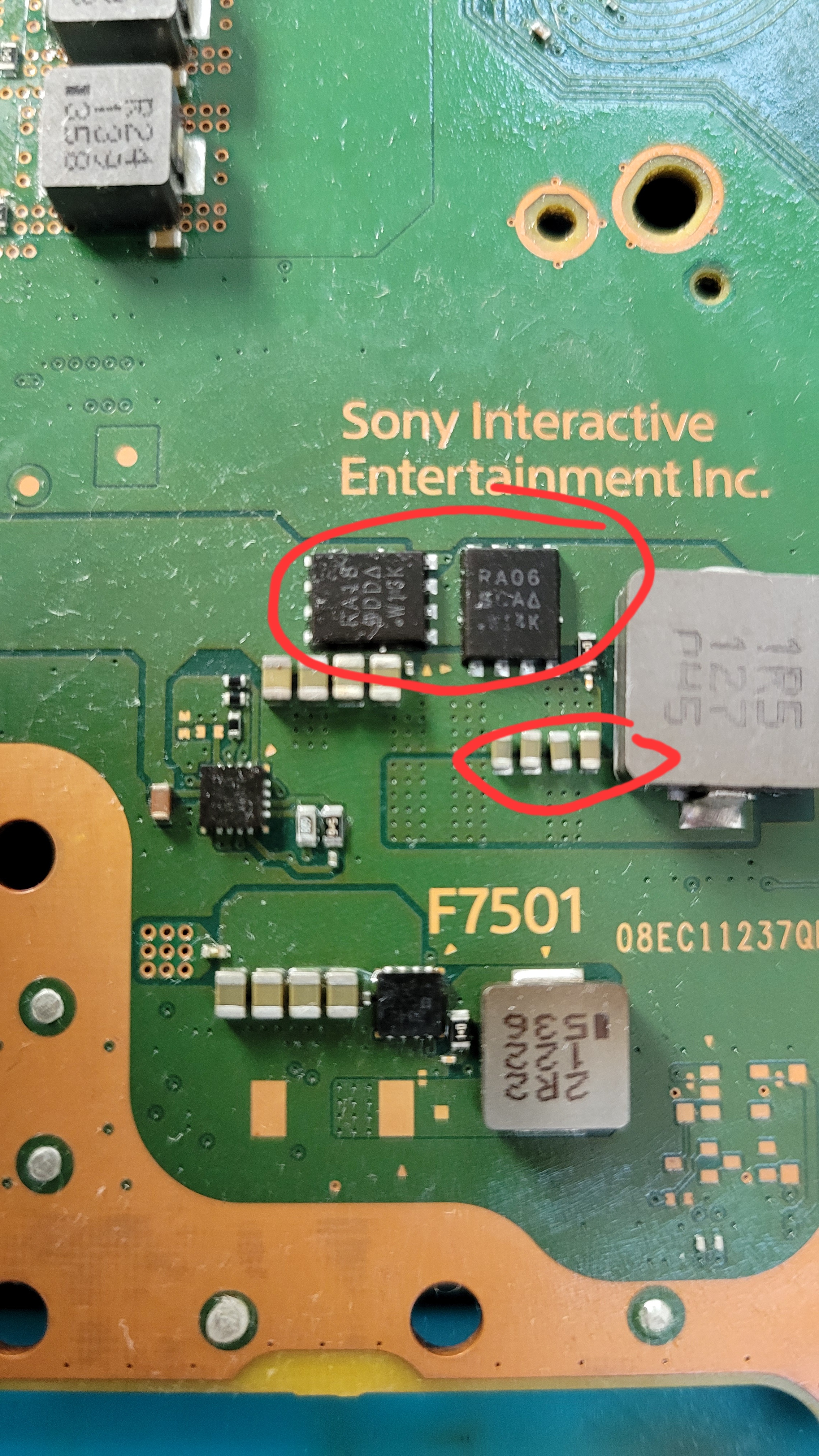

I have a short on my 5v rail. It is showing on the 4 caps shown in picture 1. I have seen these caps go bad often but my issue seems different to others!
What I have done is inject voltage 1.5v up to 2v but nothing gets warm (tried on both sides?)
I removed the 4 caps to test, tested good and still had the short on the board.
Removed the 2 mosfets above and still had the short?
On the other side of the board the two caps circled in pic 2 show as short, I removed them and the mosfet and the short is still there?
I have checked around the board but cannot find anything else shorted? I have checked all fuses and all test good.
I am now out of ideas so any ideas would be great thanks!

Are you sure you have a short on the 5v rail? The first picture, I believe that is the 12v rail on the 4 larger capacitors circled in your picture. On my edm-010 board the 5v is generated at F7001.
You might be right, I thought it was 5v? But I still have a short unfortunately.
Check on diode mode, red probe on ground (use one of the dots on the side of the board) and black on those capacitors (non ground side). Do you have a short? The 12v can show up as short momentarily but that's normal.
I did check my edm-010 board and in your first picture, the smaller caps are indeed 5v.

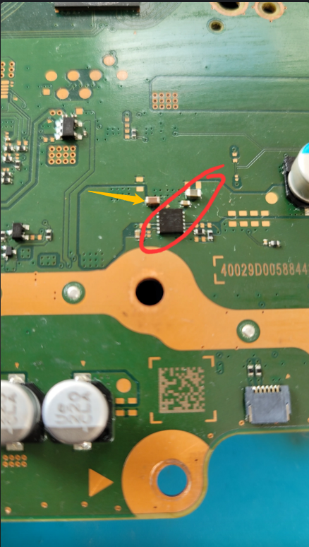

pic1 2x mosfet gens 5v from psu 12v through 1R5 inductor and those 4 caps in a row. Then this 5v goes to the pic2 IC and become 5v source for the front USB I/O panel.

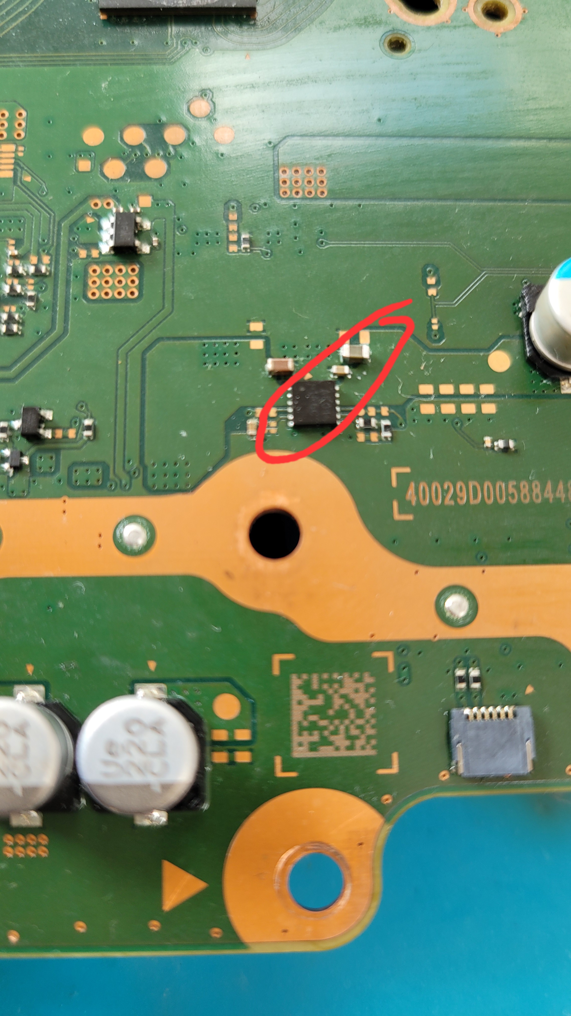

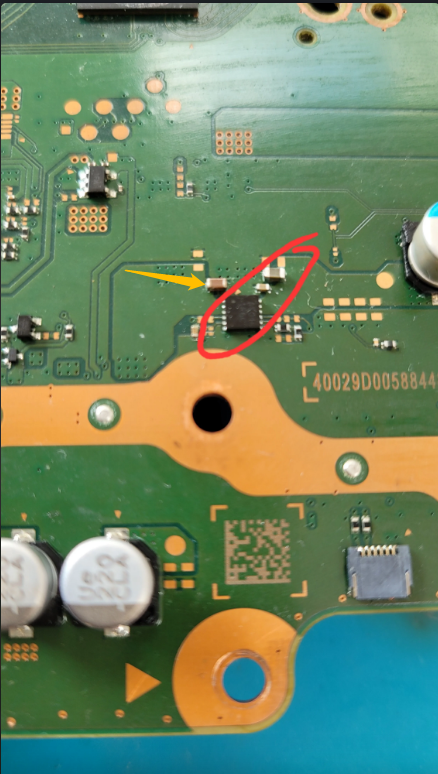

check yellow arrow cap if any short and remove picture2 black ic and see if your 5v short gone.
