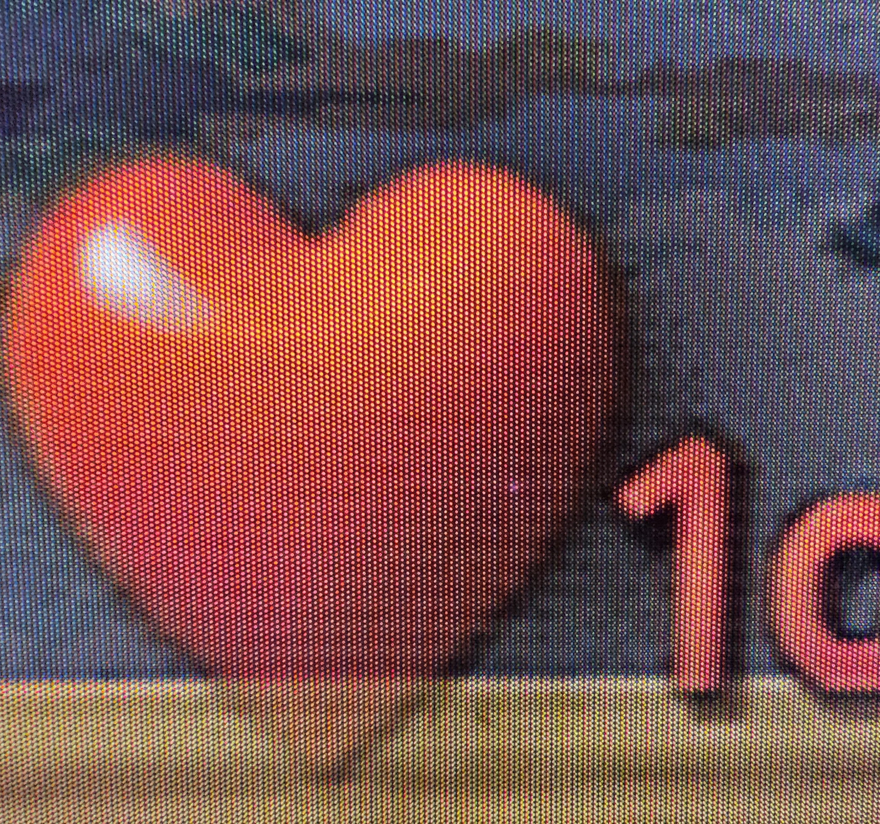

After reading about newer Wiis being unable to display 480p correctly, I dusted off my old RVL-CPU-01 models of which I have two and fired up 240p test suite. And sure enough, the 480p patch works.
But now I noticed some weirdness when red objects are being rendered.
I made some comparison shots:
RVL-CPU-01
RVL-CPU-40
RVL-CPU-01
RVL-CPU-40
Note: this is with the 480p patch disabled on both Wiis
I tried my best with the photos. In person it's much more obvious.
Red text and sprites look much smoother on the newer CPU-40 Wii. Anybody else noticed that behaviour? Is there a fix?

This is a zero-order hold on the subsampled chroma. I had used an optimized setting for 4:2:2 component video decoders.
There is a setting that applies filtering to chroma, but it complicates the logic as it makes 480i/240p blurry.
