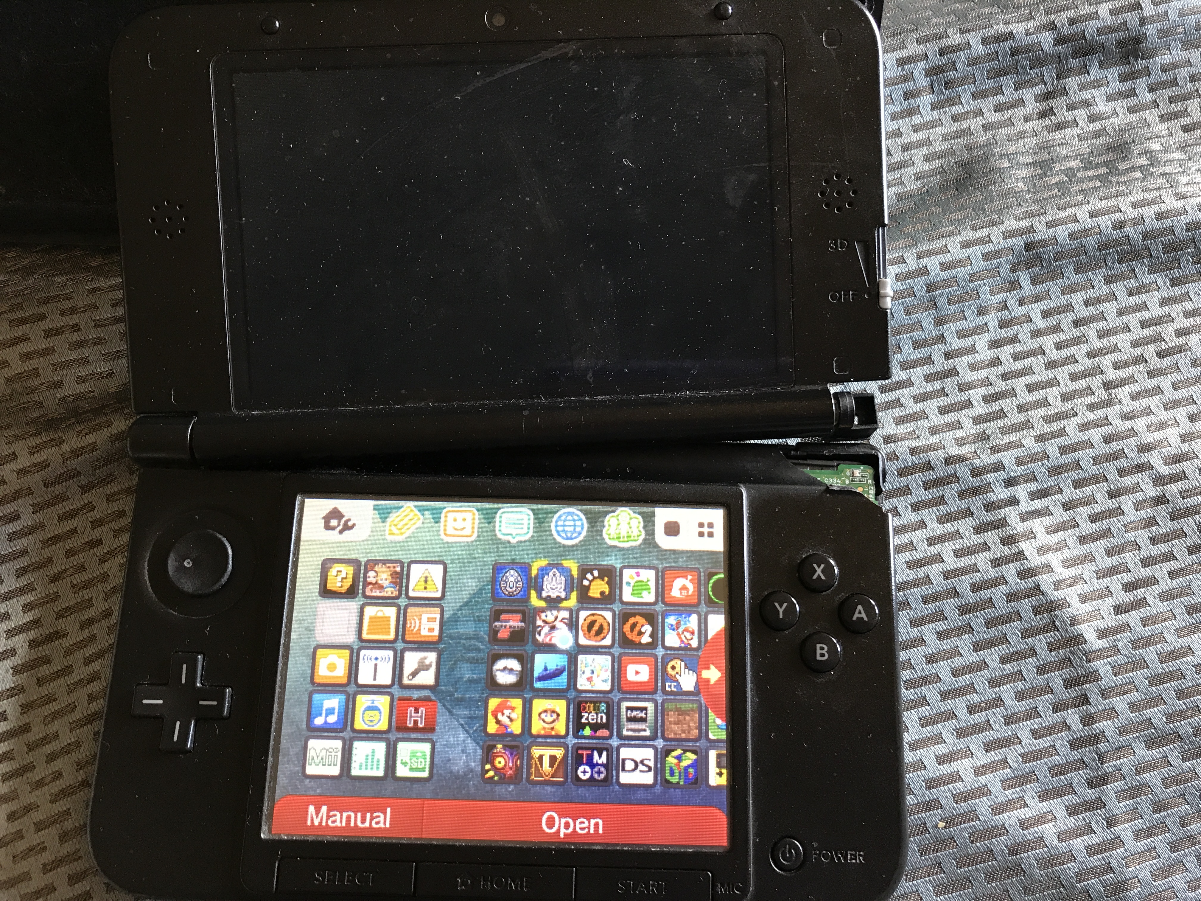

I've owned my Nintendo 3DS XL (Blue, serial starts with SW) since 2014 and today it has taken another drop (on carpet) and now the top screen fails to turn on. I've tried to leave the 3DS off for a while or reboot it, but those don't work. Do I have to take this apart to see what the issue is?
The 3DS is currently in rough shape, it's been through a lot since I got it.
I have to replace the bottom screen with deep scratches, the battery (since it's getting a bit puffy), and the shell. I've uploaded an image of the current state of the console.
EDIT: I've noticed that there is a backlight to the top screen, but other than that nothing else.

Either the cable for upper screen picture is loose/torn or the screen gave up because of the hit (in most cases there are visible see cracks and strange colors, but not every time when a screen fails because of drop damage).
First thing would be carefully opening this thing to reseat the cable.
Backup any important data BEFORE attempting a repair.
Since 3DS are out of production it is worth trying to salvage every single one of them. Parts, even if you need multiple at a time aren't too expensive. (replaced upper screen, touch panel and loudspeaker cable in one console and this made sense from financial point of view; for the case somebody answers with: Just buy another one)
Be aware that a shell swap is difficult. Refer to ifixit.com for repair guides. There are some usable videos out there as well -- good in addition.
Good luck!

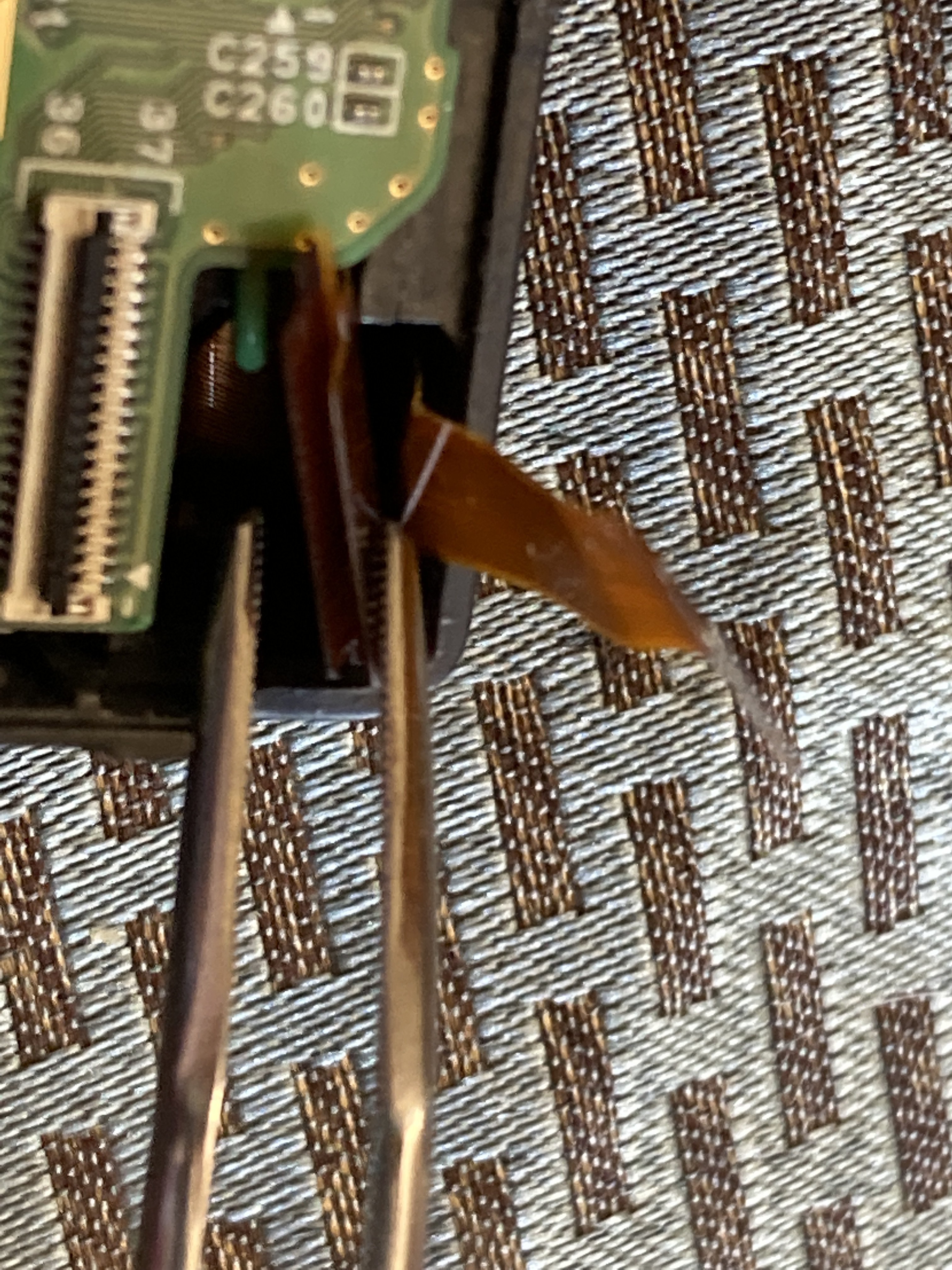

So I am trying to put my 3DS back together. I know where one of the three ribbon cables go back, but I don’t know where these other two go.
