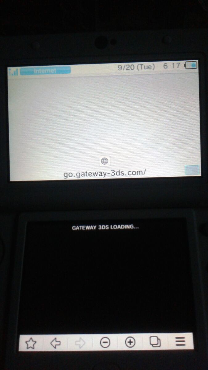

My console isn't bricked, I completed the CTRnand transfer and my browser is still on the latest version. I'm going to run downgrade checker again
Downgrade check is saying the same thing as in OP

Please give me a noob friendly explanation of what to do now

I'm being 100% serious, I still have the new browser after the ctrnand transfer. The downgrade check is giving the same errors
In your current situation it may not be possible. If a CTRNand transfer did not work you're kinda boned. You could try updating sysnand after the a9lh install, creating and emunand, downgrade your emunand to 9.2 then swapping your sysnand and emunand.
