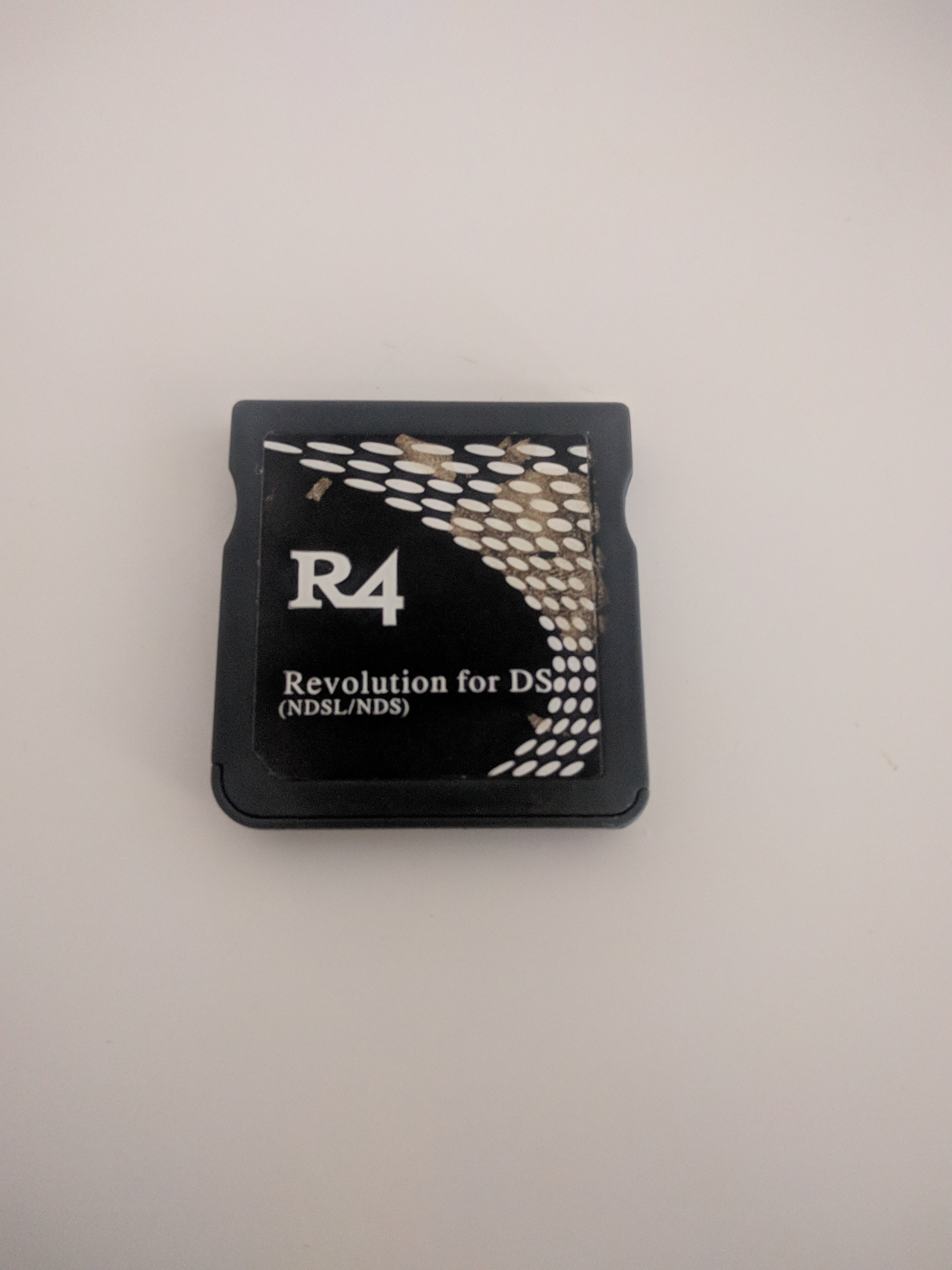

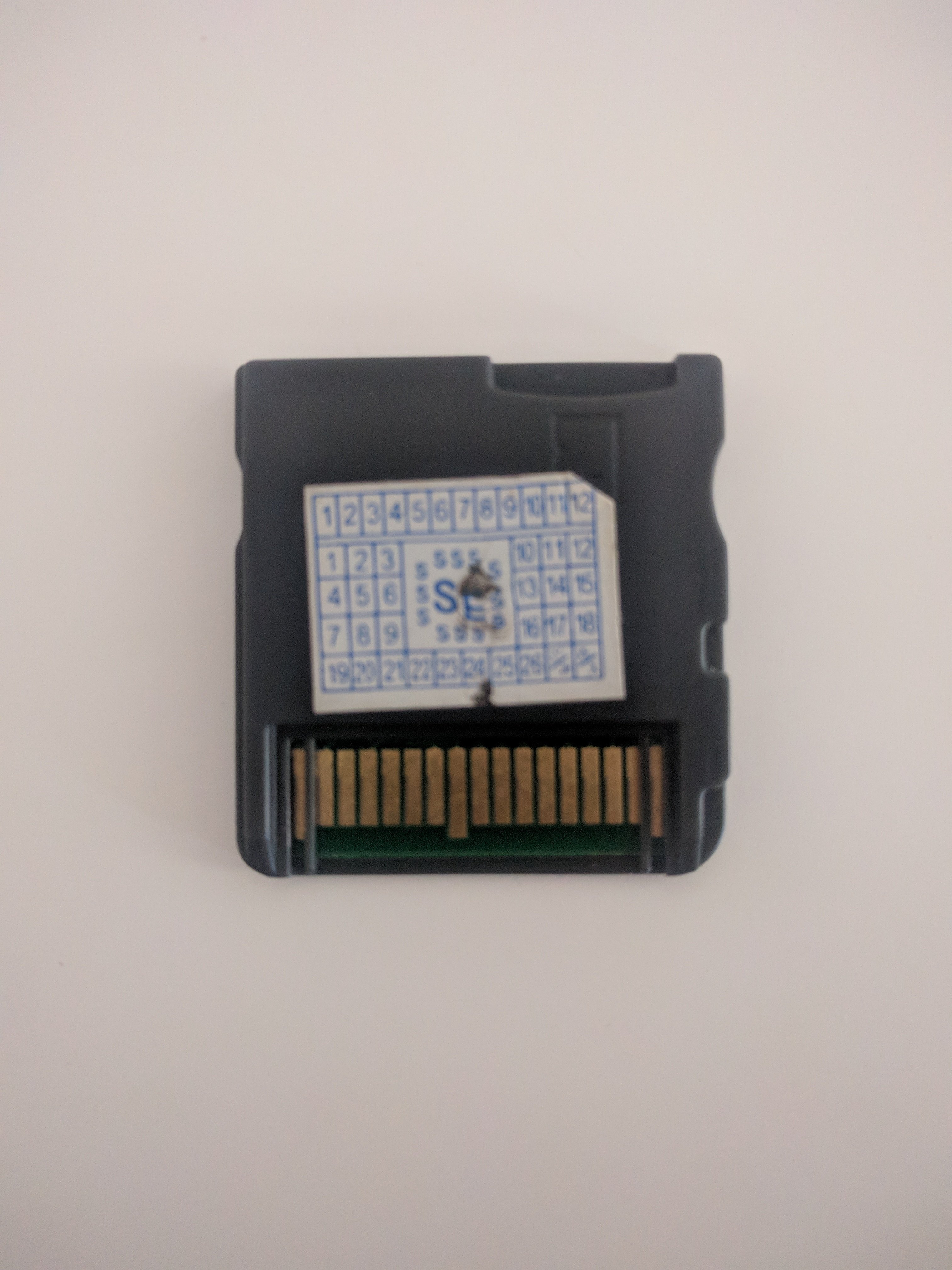

Mind providing a picture of it? I can tell what works with it just by looks.

Here you go;
Yes, I know there's nail polish on the front, I have a couple, and it's an easy way to tell between them.

Here try this, I hope at least one of these works, if not then let me know.
Primary Boot Kernels:
- R4 v1.18 English (You need to set the date backwards)
- Wood R4 v1.62
Dual Booting Kernels:
- R4 v1.18 + Wood R4 v1.62 (You need to set the date backwards to boot into the R4 kernel)
- R4 v1.18 + YSmenu v7.05 (You need to set the date backwards to boot into the R4 kernel)
Triple Booting Kernels:
- R4 v1.18 + Wood R4 v1.62 + YSmenu v7.05 (You need to set the date backwards to boot into the R4 kernel)
I have listed the kernels above and all the boot methods for each, for the dual boot and triple boot methods, ALL of them will boot into the regular R4 kernel first, due to the kernel "expiration" error, you need to set the DS console date backwards. Once you are able to access the menu screen of the flashcart you are able to choose between one of the NDS files to load into another kernel. It is preferred to use Wood R4 over everything else due to its compatibility and reliability. Once you download one of the methods be sure to extract everything inside the 7z file and stick everything onto the root of your SD card. I really hope this helps, have a good day!
