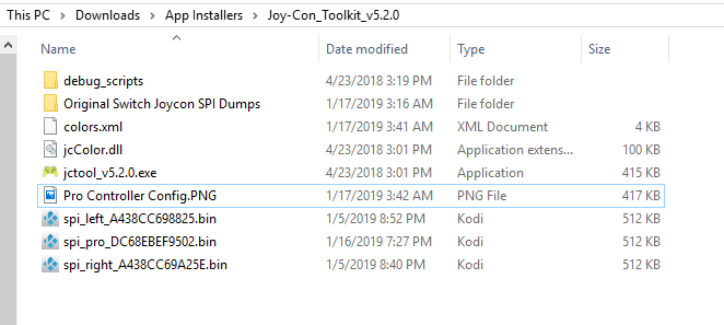

So if I wanted to restore my SPI, where can I find the file for them?
You can find the .bin files in the folder where the program executable is found. They show up as right/left/pro
So. I dumped the SPI of my Pro controller before changing the colors. Since I will be getting an aftermarket shell for my pro controller. So I changed all the colors, the program wrote them to the controller and everything is fine. If I reconnect it to the program, It shows as the colors changed, however, the switch doesn't reflect the color changes. It still shows up as a black controller with white buttons (The original coloring the pro controller had when first connected). Am I doing something wrong? Or does the switch not show the colors of different pro controllers? If the switch doesn't show the change, then why offer this feature at all?
