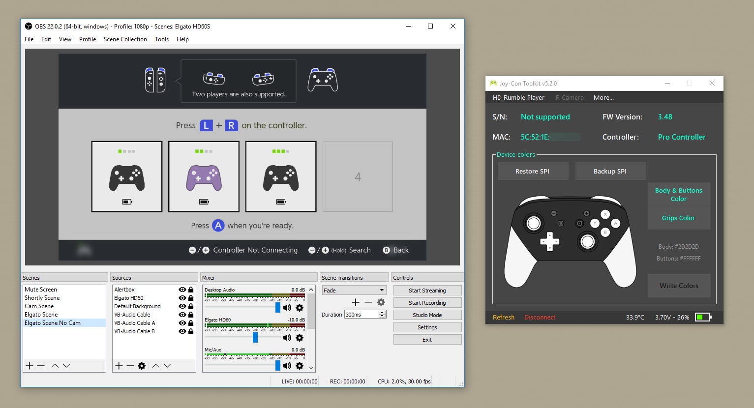

Pro Controllers are definitely struggling still
Joy Con Toolkit: v5.2
Latest Nintendo Firmware: 7.0.0
All of the controllers I have are stock pro controllers, and normally have a black shell (#323232) with white buttons (#ffffff)
I modified the shells. One with Let's go Pikachu & Eevee handles, another with smash colors, and the last has a purple shell replacement.
I am only able to update the body color wholesale for the purple shell... this is OK enough for me I guess... I'd rather have purple shell + grey grips, but I'll take what I can get.
As for the two other pro controllers with handle swaps, I can't even change the grip colors if the shell body is left default (#323232). Either Toolkit v5.2 has a bug that won't allow me to change grip color, OR the software is trying to guard against it... I'm not sure. I have to change the body color to something else (I chose #2D2D2D) which allows me to set grip colors correctly... but then after writing the colors, the switch software seems to simply ignore everything except the body + buttons color.
Are there any workarounds? Or is there something I'm missing?
(Joy cons work great!)
