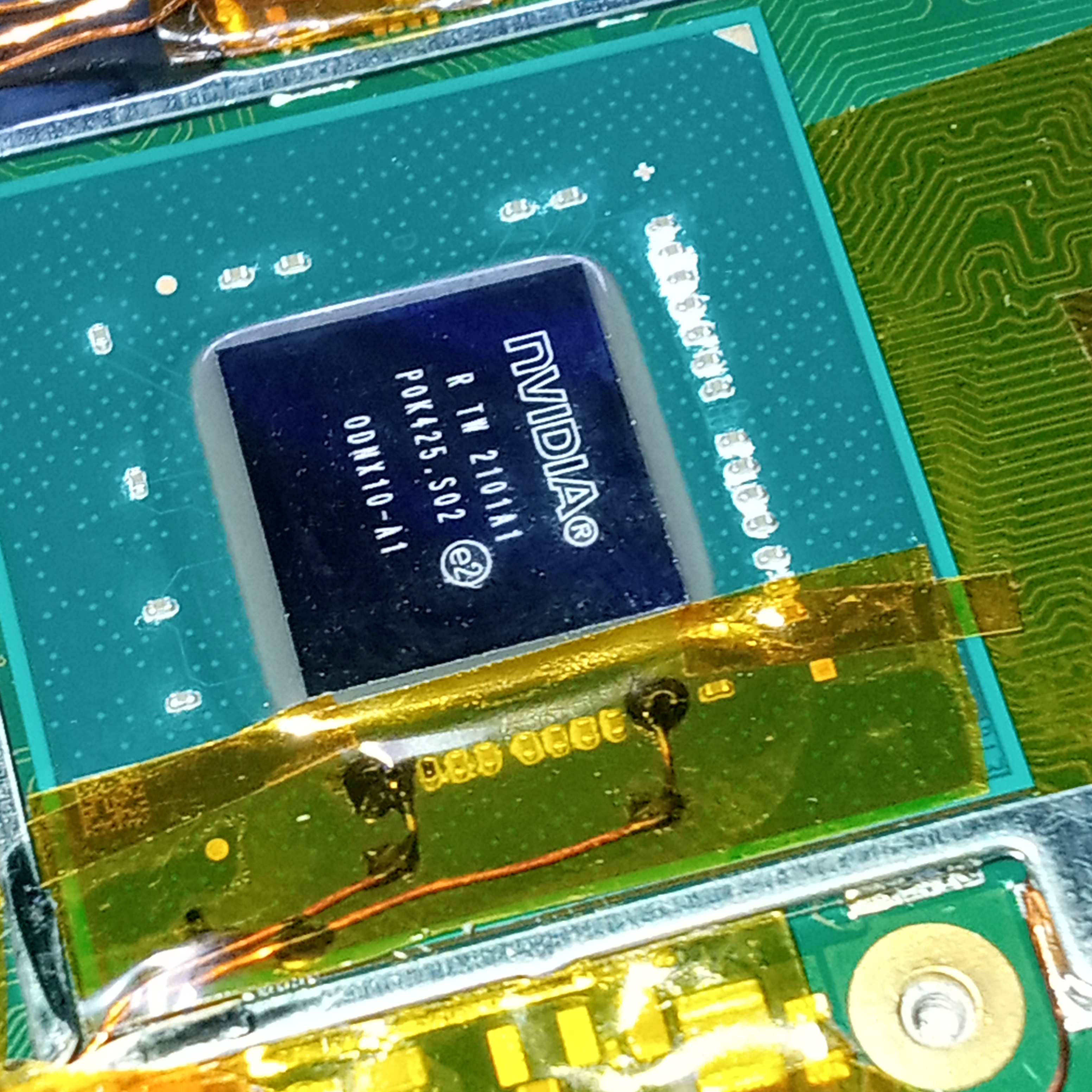

which spot gonna be hot on the apu???
middle (nvidia square)?
the green chip?
if i place kapton like this, is it goin to hot
or just warm on the green
is it safe to install kapton like this ??
cuz i didnt wanted the thermal paste spread to the joint-caps(diy mosfet)
you know, cuz lazy to cleanif spread
thats why i place kapton there

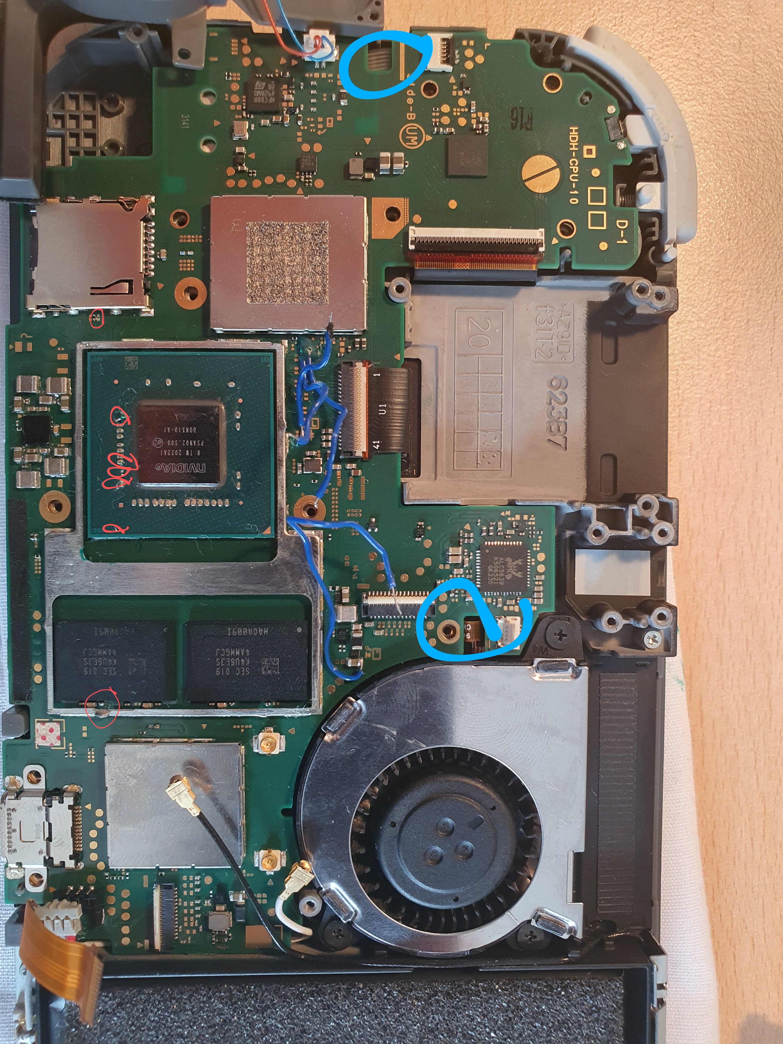

For the video: 2x long pulses should be a CLK issue.
For the picture: The 7x red circles are concerns and the 2x blue circles are 'eh, should be fine but try not to let unconnected wires lay under motherboards ever' View attachment 373173
Red circles from top-down:
1- Missing resistor?
2-4: Lots of mess, hard to be sure what's going on. Recommend trying to get back to factory here.
5. Sign of solder splash\balls? Flux\lighting can throw pics\vids 'off'.
6. Did you pry here? Maybe the caps\traces broke?
Pro tip: use heat to save your liquid damage stickers BEFORE you do work.
