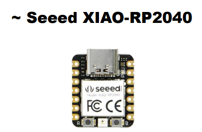

board pins:
Waveshare rp2040: SDA=12, SCL=13
Pi Pico: SDA = 19, SCL = 20
XIAO 2040: SDA=3, SCL=4
ItsyBitsy 2040: SDA = 18, SCL = 19

Q: rp2040 boards support
A: WaveShare 2040-zero/one, xiao-rp2040, adafruit itsybitsy (Pi Pico is not supported for now)
