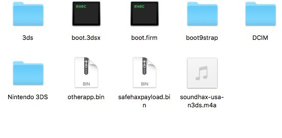

I have a new 3ds XL. FW 11.2.35 U.
I was following the 3DS.GUIDE
In the: Section I - Launching SafeB9SInstaller, after 3- Launch safehax from the list of homebrew
The 3DS doesn't start anymore, just blink blue led for 1 second.
No error was showed in the screen, every pass was checked in green.
Attached the image of the root of the SD card.
Can anyone help?
Thanks

Blinking means it can't find the right boot.firm, it is not bricked. Either your SD card is not working, or you have the wrong boot.firm, or your boot.firm file is corrupted.

Yes, it should. If your LED is blinking blue for a second and turning off, like @Quantumcat said, it just means your console can not find the HAX payload on your SD card. That means, it's either not there, the file is wrong/damaged, improperly named, your SD card is faulty, or the card reader in your console itself is going bad. 9/10 it's just a bad download, or a complete overlook.
Just redownload the "boot.firm" and put it on the root of your SD card. DO NOT USE Wi-FI to trasnfer the files, do it manually to preserve the integrity.

Try downloading Luma 8.1.1 boot.firm from https://github.com/AuroraWright/Luma3DS/releases again, and if that doesn't work, try a new SD card. You can also try GodMode9.firm renamed to boot.firm on your SD card. If that doesn't work then there's definitely something wrong with your SD card.
You were right! The file was corrupted.
