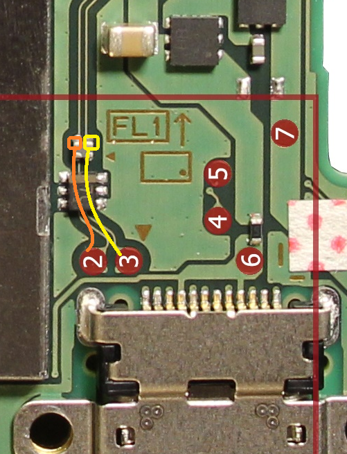

check diode reading at test pad 2&3 first, normally should have about 0.6XX~0.7XX mV.
if test pad 2 or 3 has ground or very low diode reading, remove the esd filter in yellow box and test again.
If no reading at all(OL), check on the red arrow from top of the choke filter
First, i dont have reading on 2&3.
2nd, 2 or 3 has no ground so i did not remove the esd filter is that right?
And the the two you pointed with the red arrow has no reading either.

Different from resistance reading, diode reading is always red prob to ground and black prob point to the test object.
Mate, can you check this? You can correct me if im wrong, im just using an analog multimeter. I did what you said and this is what i got. Btw, this is just my extra switch so i can learn how to fix it on my own.

you need a digital multimeter to approach diagnostic these days. Analog meter can only do basic resistance reading or simple voltage reading.
Good day mate. I just got a digital multimeter today, and i have to do the reading again so i could tell you. Test pad 5 has 490 - 540, please see attached photo. Test pad 2 & 3 has no reading and no ground.

Do you have continuity/beep from orange to test pad 2, or from yellow to test pad3?
you need to test the top two silver point on that tiny choke filter, some time they blow up and leads to test pad 2&3 having no reading.
I dont have continuity on orange to 2 and yellow to 3. If thats blown up, could it be the problem why payload won't push?
