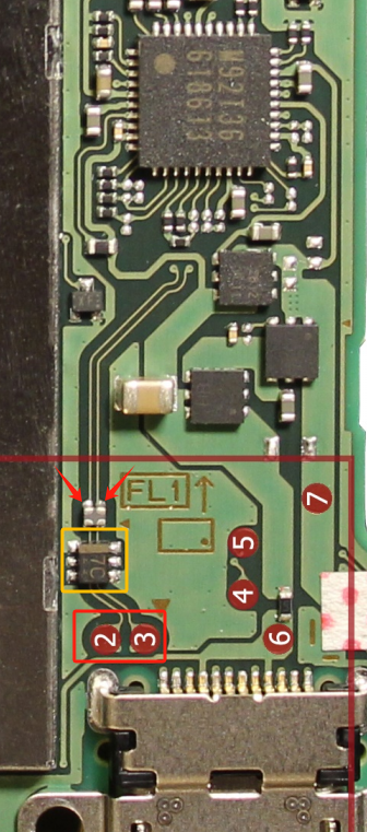

Sounds like your USB port is bad. Check D+/- on connect if you have a tester.
Good day mate. May i ask how exactly do you do this? I have type c test board with 13 test point. I plugged it on switch and test it with analog multimeter but no contact.
Either your USB-C port is dirty or damage. To make testing the port much easier, I prefer using a simple USB-C breakout board with through-hole points. Otherwise, teardown the console and check to see if the pins might've come loose.
This is how i test the usb-c port. Each pins on the red box has contact with each holes on the yellow box but not shorted with the others, so i assume theres no problem with the usb c port, or i am missing something? By the way, my unpatched wont boot to hekate, the rcm loader won't push the payload. Tried using usb c cables with tegra, change cables but tegrarcmgui cant detect my switch. I have the driver installed, No luck.
@jkyoho Do you know which chip controls the data from usb? Thanks for helping. @Deadkid21 Wait for his response, he is very wise. But it sounds like that chip is bad. He prob won't respond tonight but will later I'm sure. Good luck!
Only half the pins are accessible, the other half are hidden underneath the port, but half the pins should be enough for USB 2.0 data. It's unlikely the soldering would have issues, typically the pins inside the port are bent or the port is simply dirty, you can check with a flashlight.
When you plug something in try to plug it in both ways, in case pins on one side are damaged, since most of the pins are mirrored on both sides.
Try multiple cables, if you have a cable you know works with data (check with your smartphone) try with that, since many cables are charging only, and cables tend to get worn out, that is the most likely culprit.

check diode reading at test pad 2&3 first, normally should have about 0.6XX~0.7XX mV.
if test pad 2 or 3 has ground or very low diode reading, remove the esd filter in yellow box and test again.
If no reading at all(OL), check on the red arrow from top of the choke filter
