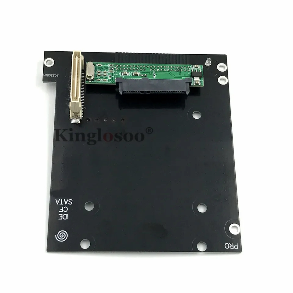

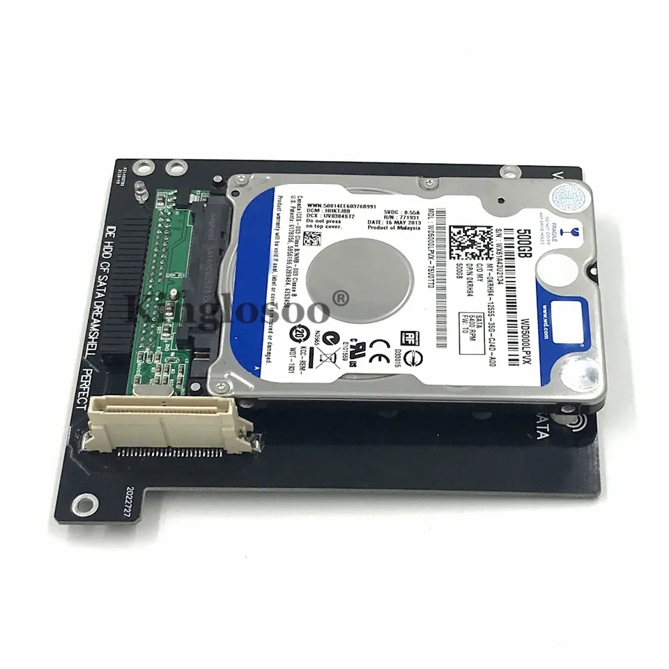

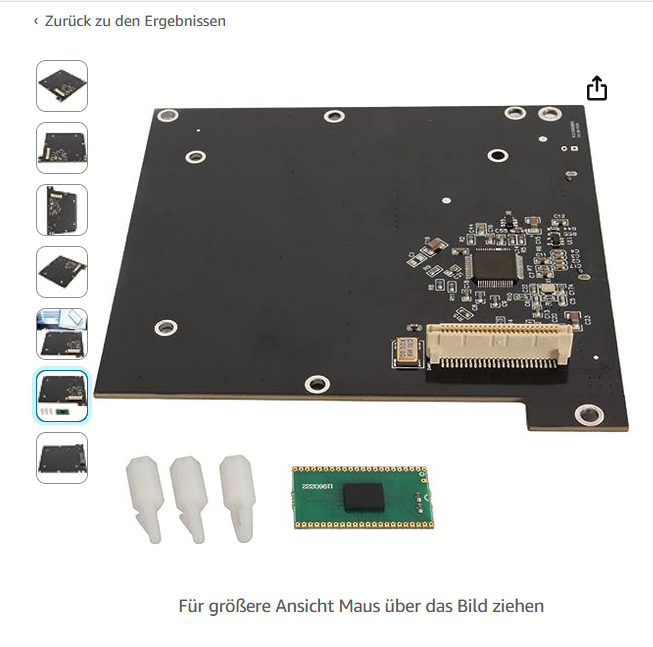

I have 3 dreamcast all of them has working orginal gdrom drives, my main one is modded heavily, i have a v1 console with dual bios both stock and japanese cake bios and overclock mod , a internal serial sd adapter, and the old school ide mod that boots gdi's from a compact flash adapter with dreamshell. It plays all the games i have no issues so haven't seen a need for a gdemu. i still recommend the ide mod if you have the skill to pull it off as it isn't expensive to do. One is a v0 console that is only bios modded so far, and lastly a completely stock v1 console.
How is compatibility with Atomiswave games? Did you have to mod your case to fit the IDE? Could you elaborate more on the cake BIOS and overclock; do those increase/decrease compatibility?
What's your thoughts on a throughput SATA adapter? https://aliexpress.com/item/1005004117158852.html

It looks the same as the ide mod but uses a board with a ide to sata adapter built in, the bios is probably just mooded to auto boot dreamshell, probably required because it romoves the gdrom drive to be installed. I used a ide cable and solder the points to the motherboard by hand so i could keep the gdrom intact. I use 32gb compact flash cards with a cf to ide adapter, most sata adapters the dreamcast is extreamly picky about, i had one out of 3 diffrent ones that worked most the time but was iffy on speed. compact flash was a lot easier at the time, more consistentread write speeds and used cf card where cheap. i got two 32gb card for $10 on ebay, but this was about 3 or 4 years ago not sure if they can still be gotten for good prices.
More information on the ide mod here, https://www.dreamcast-talk.com/forum/viewtopic.php?t=11540
Compatability for dreamshell and retrodream
