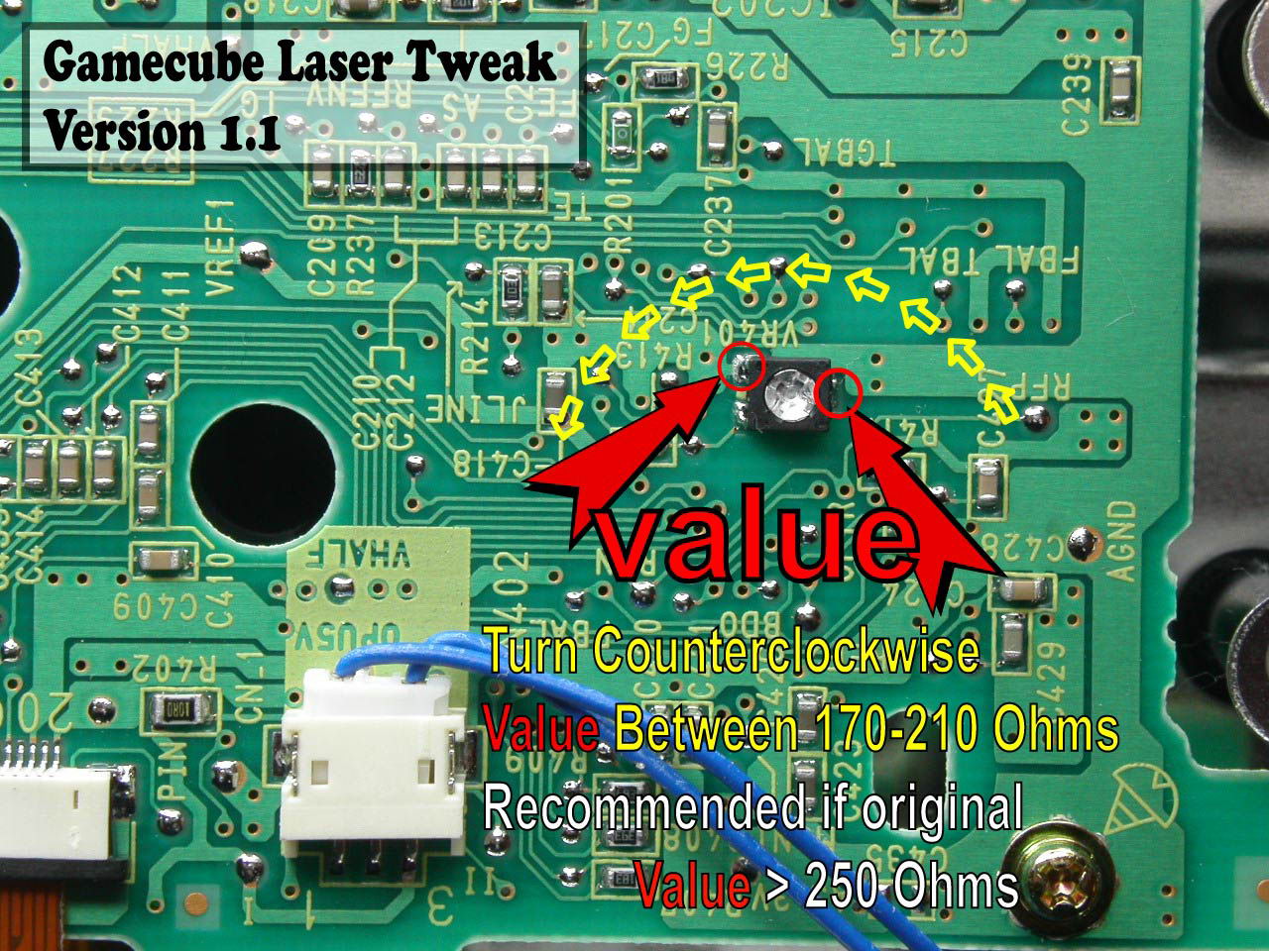

Hello. :)
It is difficult to say because of not 100% sure if original games works BEFORE the ModChip install.
First please check all your soldering points (did you solder it DIRECTLY or as recommended with short cables ?)
It is maybe a high possibility that the Drives DVD Laser needs to be adjust.
Here is a little help to show WHERE to "tune" it - it is on the under side of the Drive:
Note:
Please make slow and little steps/adjust turns and test it after every step.It is a little of TRY and ERROR.
Better mark it on the point where you begin to adjust.
Goo Luck.:)

It would be a good idea to make sure the disc is good before doing anything to the console. I once spent hours trying to tune the laser for a particular game only to find out the disc was the problem all along. If most other discs work then that is a clue.
Also, I would recommend getting a multimeter to anyone who is thinking of doing any pot tuning. It makes life so much easier than doing it blindly.

I was using my work bench with a multimeter, I do a lot with small electronics just never modded a console before so I had a good idea what I was doing but I did make sure every time I made a small adjustment I would check with the multimeter. I'm kinda thinking it's the game because of the fact the rest of me games work once they boot past the gamecube logo, but mind you I only have a small handful of games so what I'm going to do is try to find a friend who has on old one sitting around someone and test it on his and see if it's the game or the gamecube.
