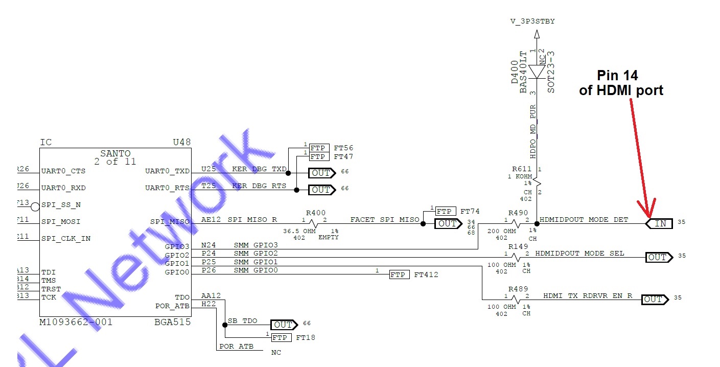

Hello all!
I just replaced an HDMI port on an Xbox series S and pin 14 is showing a value of .786 when it should be showing OL. I made sure there was no bridging and there is no connection between that pin and any other pin. Not sure what could be causing this to show this reading, but I have had the same issue on two Series X consoles but the issue only appears when the Southbridge board is attached. What could be causing this issue? I am not sure where to check, so if anyone can at least point me in a direction to start looking, I would appreciate it!
EDIT: After thinking on this, I realized that all of the consoles that have had this issue also had to have pads repaired by running Jumper Wire to the pins from the traces. I am using UV Mask but it is not contacting pin 14. Just some more info for you guys.

Pin 14 shouldn't be OL on Series S/X systems, and the diode reading you're getting is normal, see schematic
