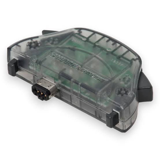

I aware of the bulky wireless transmitter. I would like something smaller that would fit inside of a gba shell.

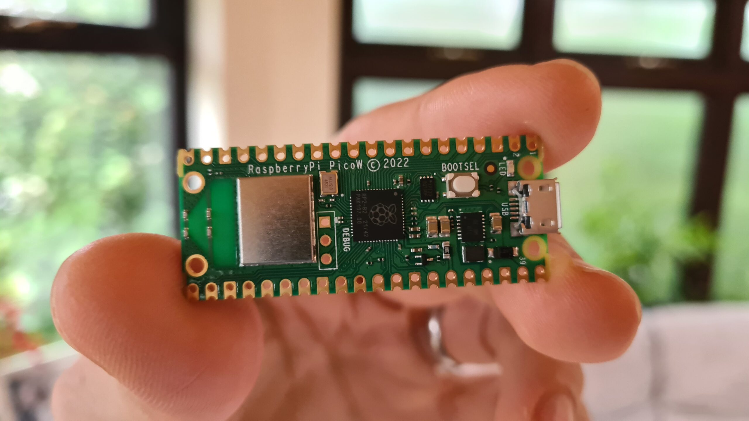

honestly after looking at the Pico w im thinking it's a better pick due to both wifi and Bluetooth support
The original Pi Pico also got many smaller, more compact versions of the board made, I'm curious if the W got the same treatment (or will) to save on internal mounting space.

Sorry to burst your bubble but the reason why no one did this yet is because link cable communication requires extremely low latency. Not even USB is fast enough. The best you can really do is emulate the wireless adapter. However i don't think you can get much smaller than the original wireless adapter. That being said it may work with certain games as GBARunner2 proved but the majority of games don't work correctly or have frequent connection issues.
The problem is that wireless adds some unavoidable latency and games expect pretty much instant responses. If you want to connect to other GBAs over the internet not even the wireless adapter may work due to the high latency.
