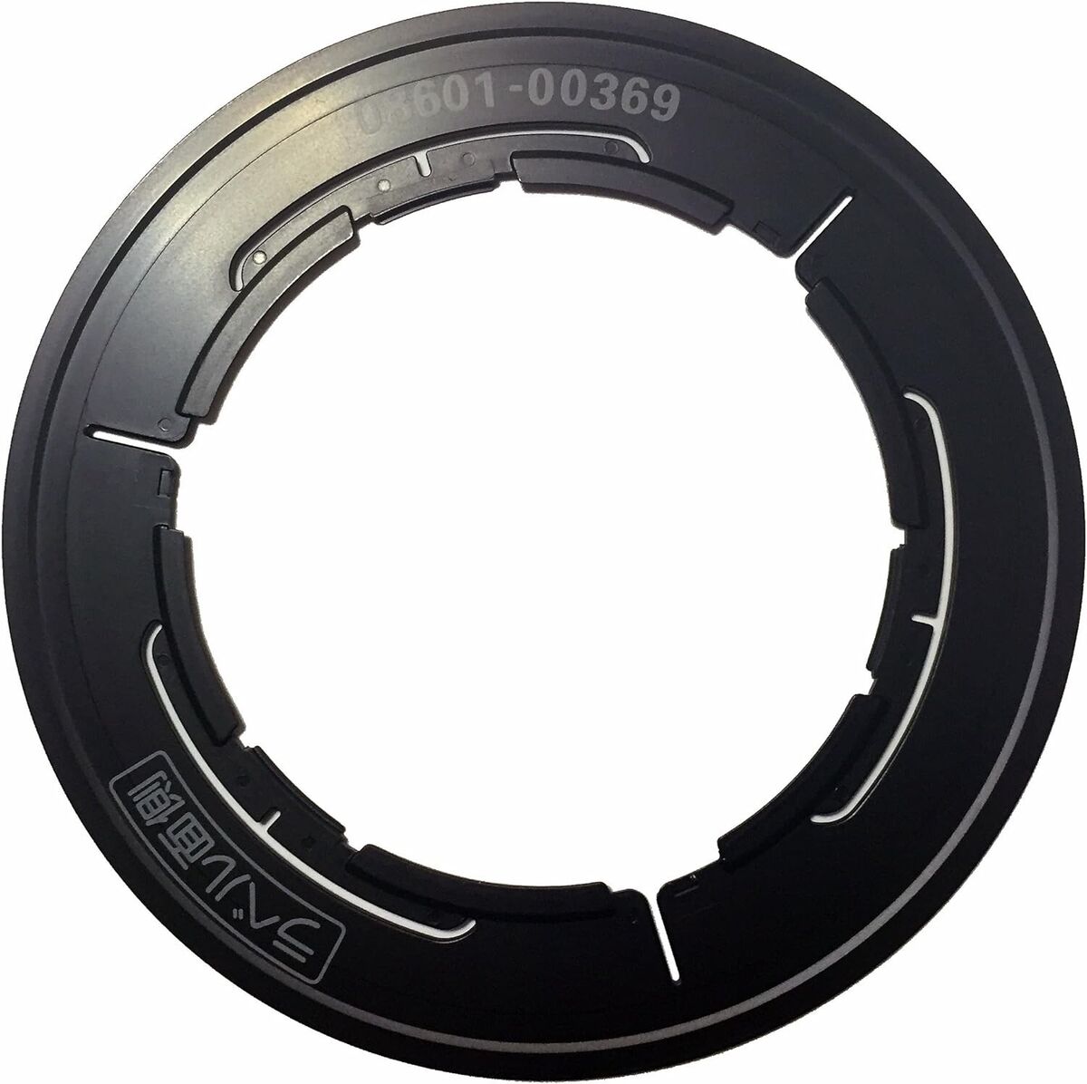

Recently picked a wii mini with bluebomb, was thinking about how to get physical GameCube disks working. I can see that the wii mini disk drive will not grab the gamecube disk due to its size, could a 8cm to 12cm mini DVD to DVD adapter, like the one pictured? obviously for use with Nintendont. What about an external USB DVD drive with Uloader, possible?
