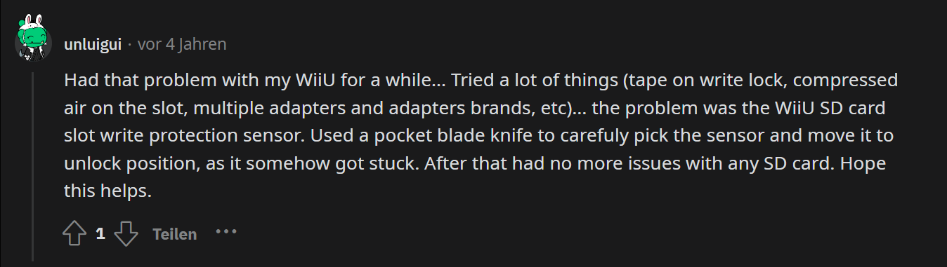

I have a similar problem as this:
On Reddit, unluigi said this:
I could not contact him. Does someone else have an idea how to fix this problem? I already searched through the complete web.

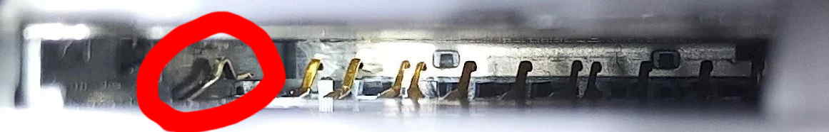

This is from a 3DS with smilar Problem with the SD-Card writeprotection, the pin might been bent. Maybe you find some more tips in the original thread: SD Card Errors. He had to adjust the pin with thin tweezers.
Info: To disable the writeprotection, the single pin with hanger on the far left side have to be pushed down by the switch on the SD Card.

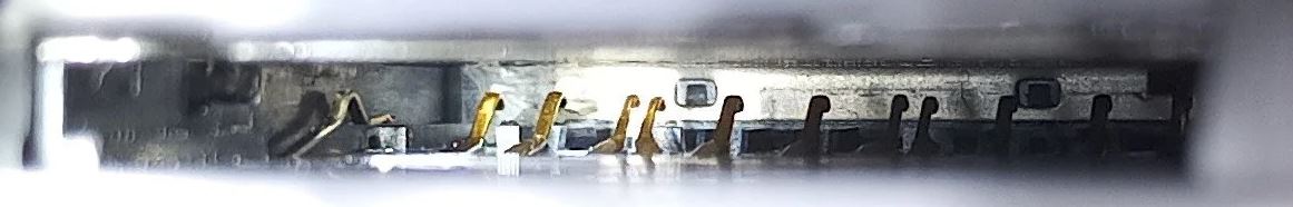

I don't want to bend the false pin. I know the picture is not very good, but can you see the switch?
Its to dark, you need a (flash-) light and shine in from the right side. Or with the flashlight of your phone by taking a picture.
There need to be one single pin on the far far left side directly at the edge.
Reactions: jeannotte
I think best, ask someone for help. Because i cant give a suggestion in this case. If there is no pin or broken, there is nothing to bend. There will be no contact where the power can flow. You will need to replace the cardreader if possible or soldering/bridging the contacts inside the WiiU.
As i say, if you look from the right side there must be seen this pin with hanger, as on my pic and same size like the others.
I found it! I was just confused about the dimensions of the picture. I bent the pin, and it works fine!
