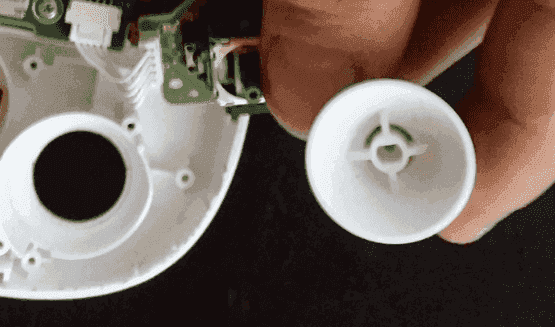

    first off i would like to say.....this is my spare gamepad. i originally got it because i wanted to try to make a portable ouya from it.
    but anyways, the handy thing about these joysticks is that they are in there like russian nesting dolls. its immediately obvious where each piece goes. but once you get the back off everything is mounted to the front face of the gamepad. to get to the joysticks there is the bigger white housing.
    this covers the joystick's board, but also the d-pad (left side) and the ABXY buttons (right side)
    the final little board is what holds our joys. 2 triwing screams and it is all yours.
    the joy stick itself is literally held on by nothing
    if i remember correctly i think that the ds4 joys had a ever so slightly different shape to the hole that holds into place. but none the less it work flawlessly.
    i hope that this helps anybody thinking of doing something similiar. one thing about a ds4 controller is they have TONS of cool and original joys all the time that you can use to customize you gamepad.
