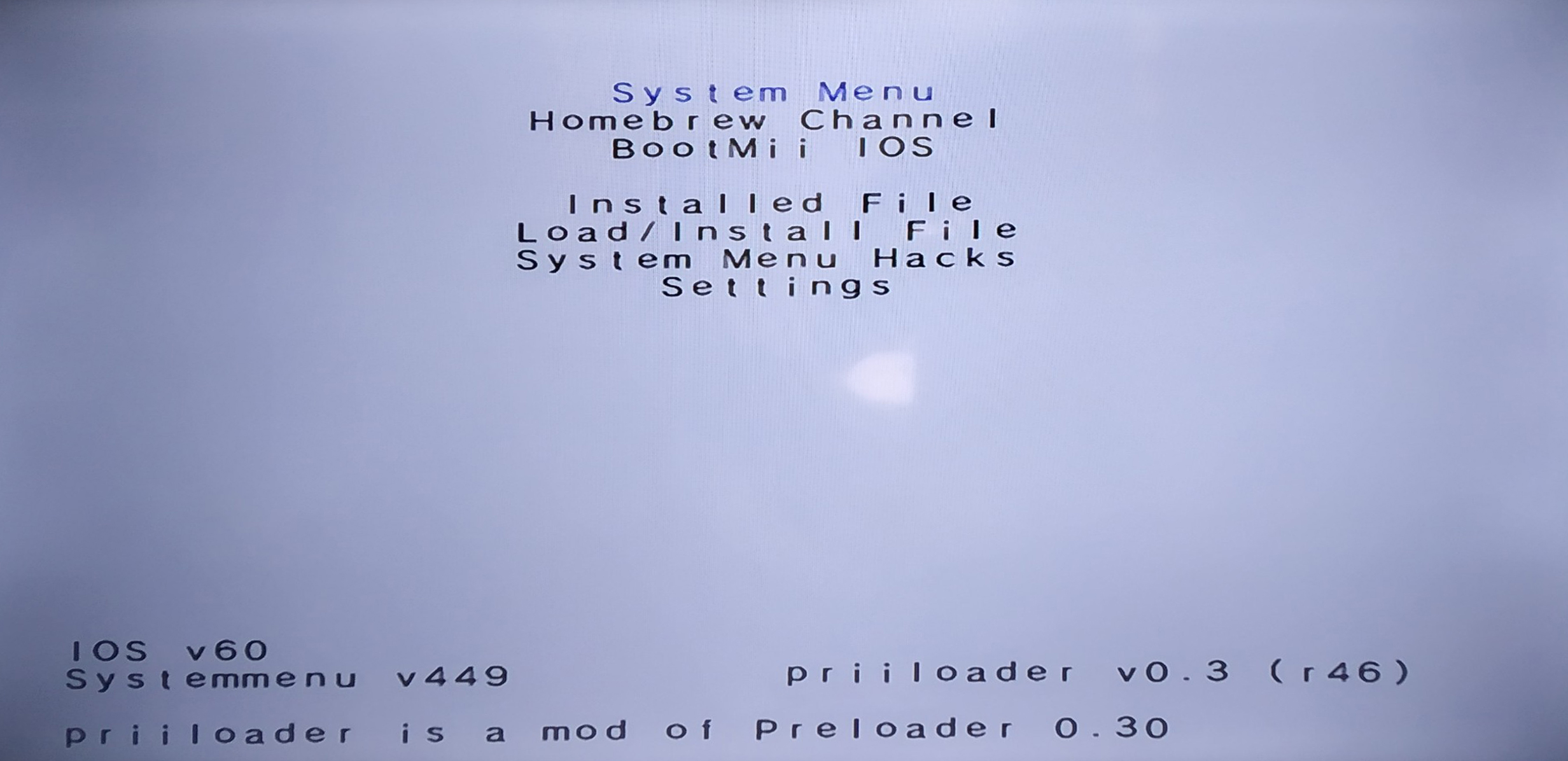

I recently bought a modded wii(4.3U/no gamecube controller ports)and decided to format to delete all save files,but after a system format,my Wii was stuck on preloader menu and i can't sync any of my wiimote.I also pressed every button(power + reset button,eject and sync button) on my wii but nothing happen.badly need your help.thank you all peeps.

Hello.:)
To be honest,I have no good News:
Without Gamecube Ports/Controller there is almost no possibility or do something.....:(
And unfortunately if that would not have been enough bad luck you have no BootMii installed as it seems.
Did you have an SD Card in your Wii ? Is there any Sign of a "BootMii" Folder in the Root ? :mellow:
Or in the "apps" a Folder called "BootMii-Config" ?
What happens please when you boot a Original Wii Game ?
Put it in when your are on the Priiloader Screen and turn the Wii off and then on again please.
I am Sorry....I do not have many Hope for your Wii....

Yeah.no bootmii installed on my wii and only a while ago that i put bootmii and priiloader on my sdcard after it was stuck on preloader screen.many times that i turned it off/on after loading and unloading an original wii games but no luck.still doesn't boot.anyway,thank you so much for your time.
After watching the videos about soldering a gamecube controller ports to the RVL-101 wii,gave me a glimmer of hope.i'm very interested now on a wii surgery.(gamecube controller ports transplant).My friend has a broken wii and he is willing to give it.all i need now are a few tools to start the operation.hope that i may succeed.
Bravo, that's what I call entrepreneurial Spirit. Good luck to you.:)
And if you be so kind can you give us Update(s) on your Adventure please ?
Thank you.:)
Just disassemble my friend broken wii to get the GCC ports.Any tip on how to easily remove solder.?Could you please give me an idea if there's a slot to place GCC ports onto blue wii(skylander edition) main board?TIA
Doesn't the Preloader boot to the System Menu when you hold down the RESET button pretty long (1 minute) while in the Preloader menu? Or has that feature only been added in Priiloader?
The location of the Gamecube Controller pins on the blue wii mainboard is exactly the same as on the normal Wii. Also, you'd only need to solder in one port, not all four of them,
Reactions: Jacobdan
You're right.one port will do.thanks for the tip.i'll try to hold reset button for a minute.hope something positive wii happen.thanks again.

dear Jacobdan,
had you fixed your Wii error?
today (july 20,2020), my Wii console have the same error after my kids touched anywhere :( so sad
if you fixed your Wii, please teach me how to do that
dear all: can you help me and Jacobdan? thanks
