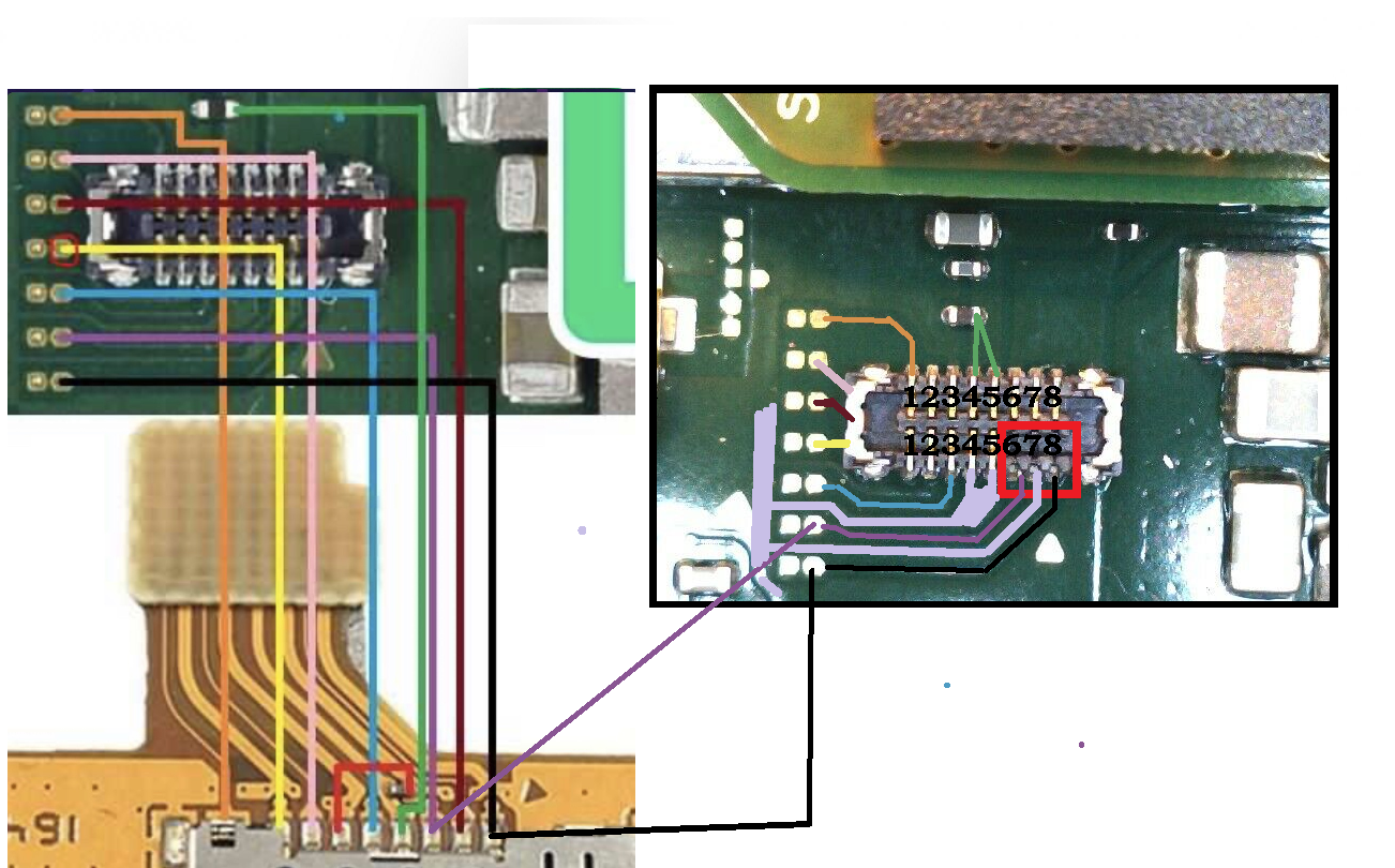

My switch has hekate w atmosphere my question is my sd reader pin socket is broken and wanted to know if custom firmware still be removed
IS there a way to remove and bring switch back to normal factory setting without the sd card.
Reason I want to sell it as a broken sd card but if i sell it like this people wont know how to use.
thanks
Does it work? Sometimes it works but is in 1 bit mode. It will work but be slow as hell.
Are you sure the mother board pins are broken and not the sd reader board pins?
how you know if missing pins when i look at it zooming in it might be missing pins hard to see. i got 2 pack new sd reader both dont read it wont stay plugged in firmly i noticed
Just look at the pins, since you take the SD card flex off, if you are missing pin it won't be running at full speed, you might be in 1 bit mode, just look if you are missing any pins, if no missing pin, you might want to use a multimeter.
