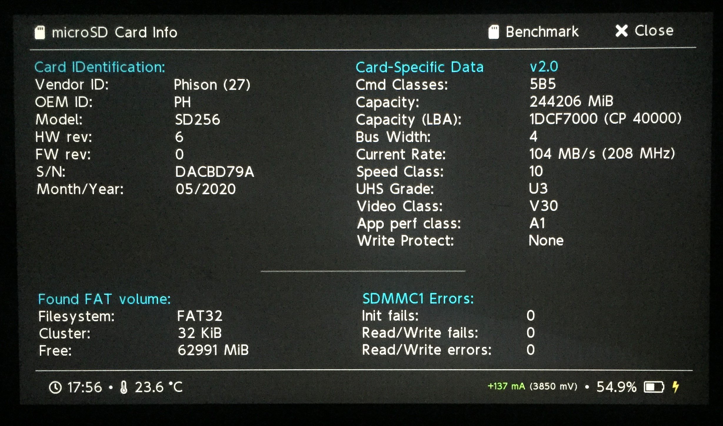

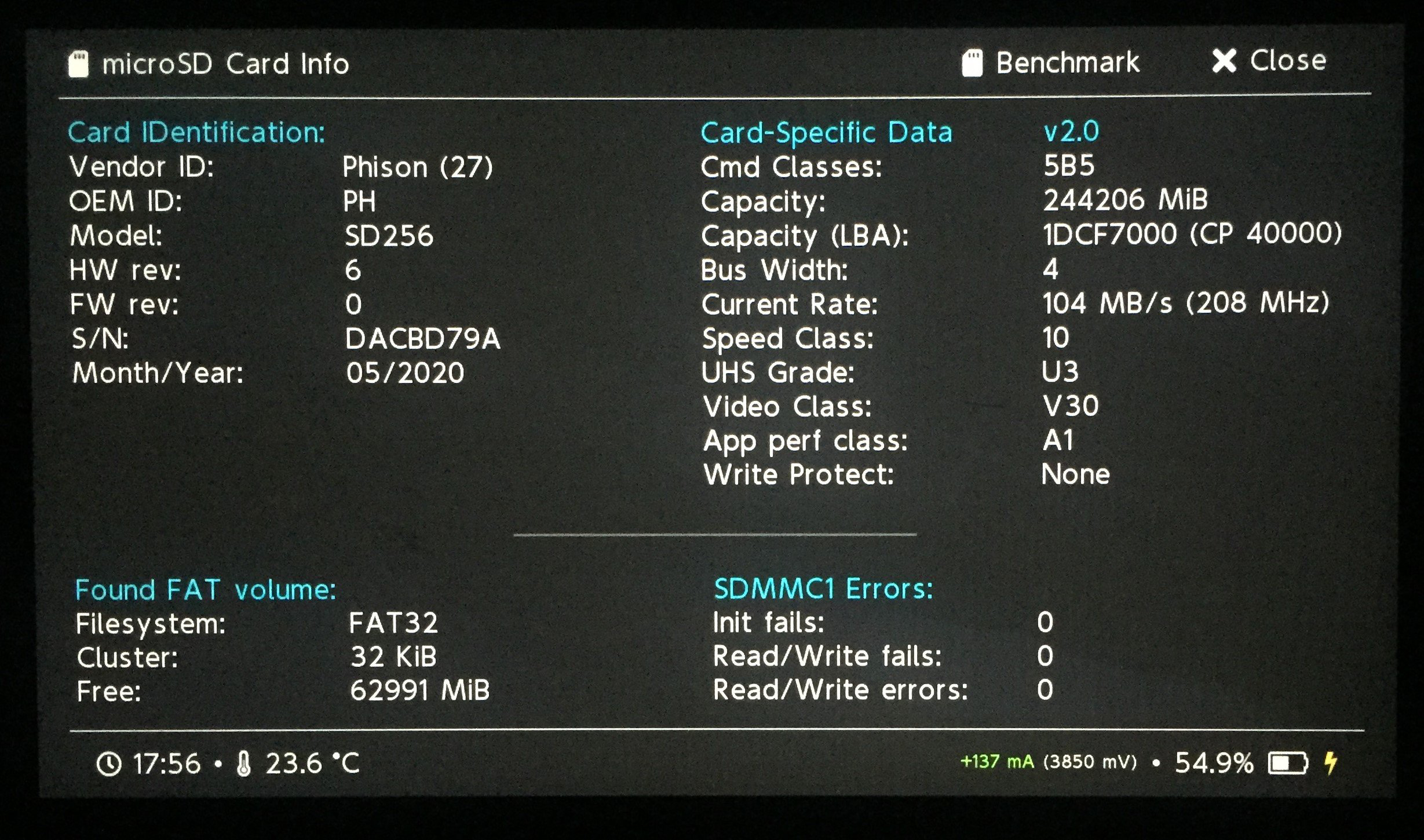

In Hekate -> Console Info tap MicroSD button wait for it to load fully and post the screenshot (will look something like this)

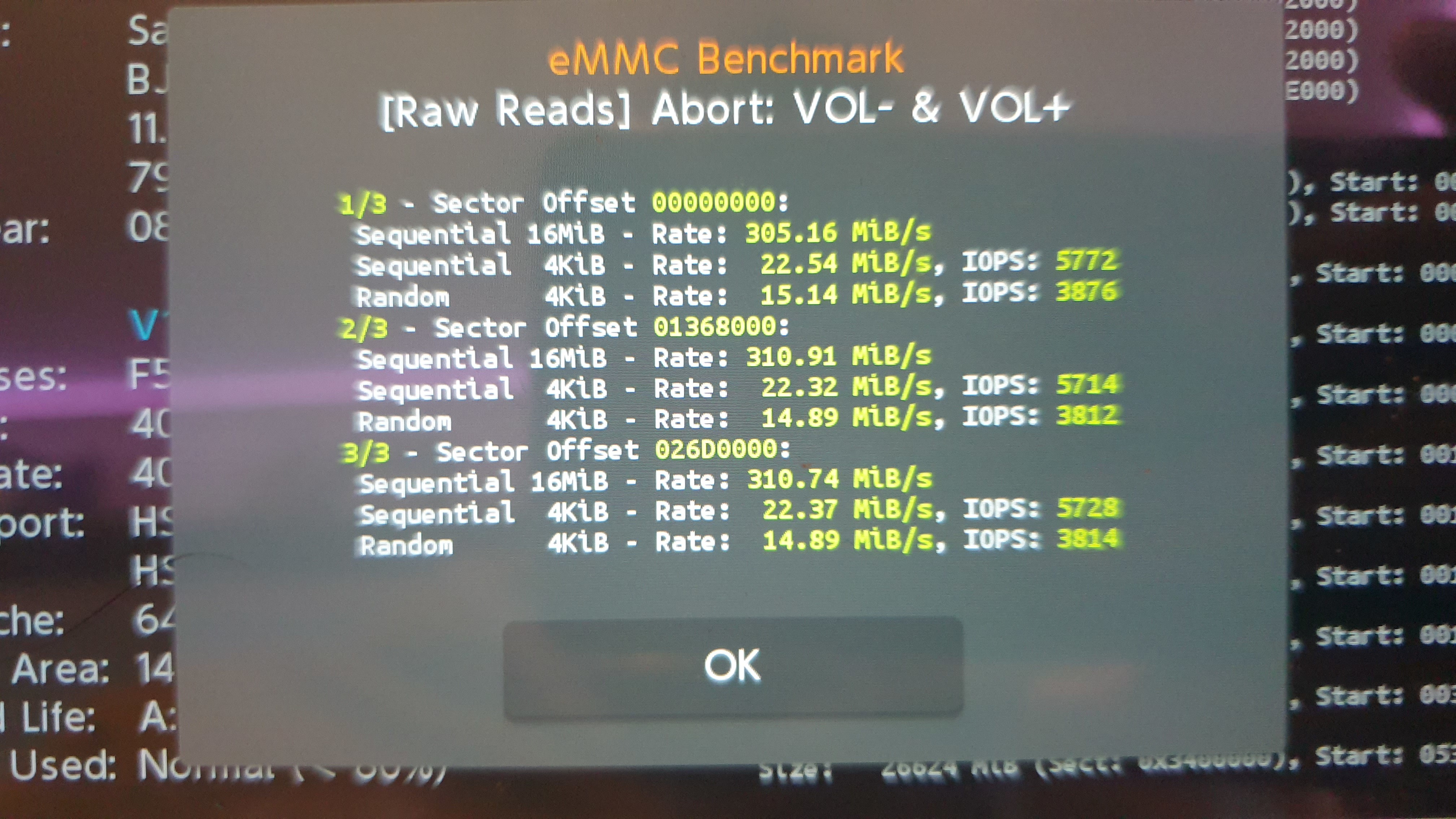

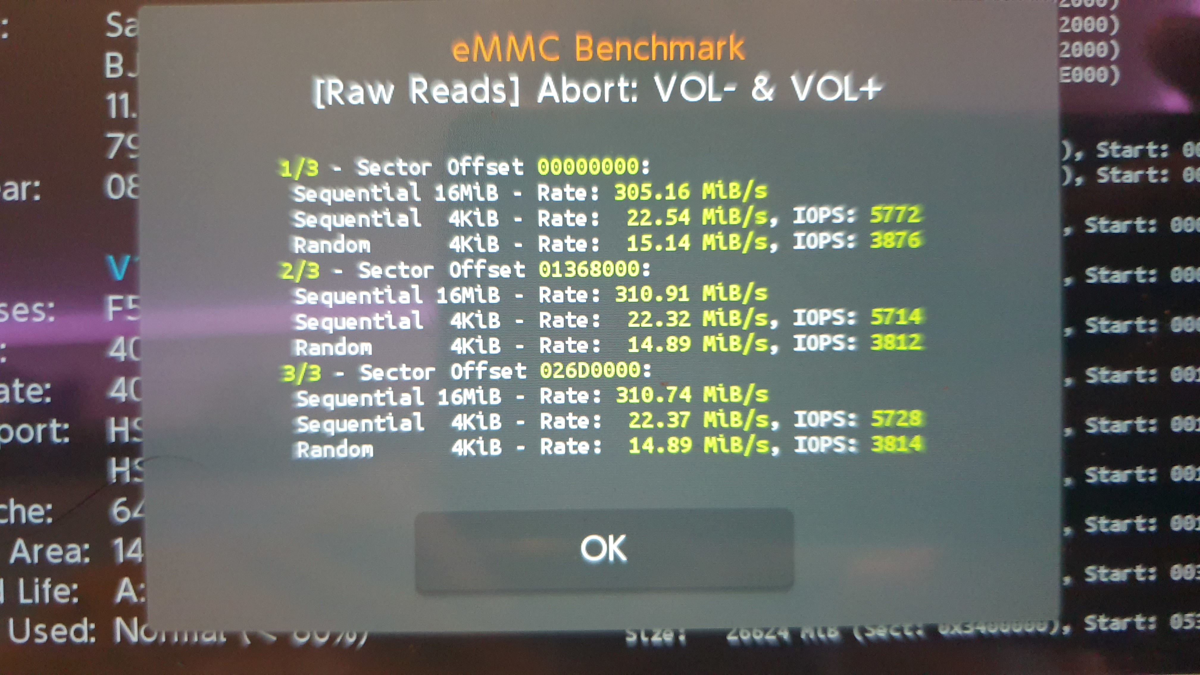

Also tap benchmark, wait for it to finish, and then post the results here (it will look something like this)
