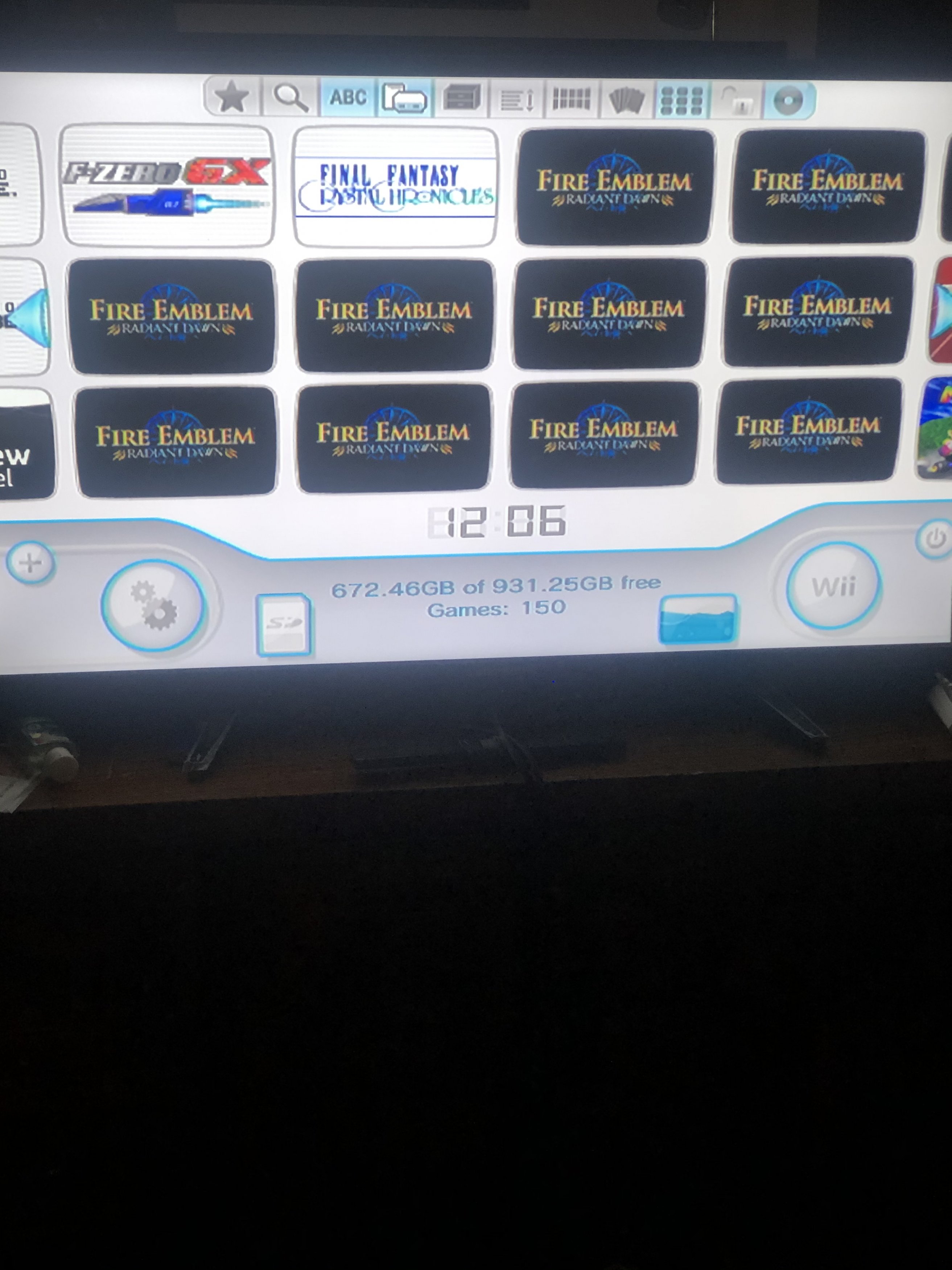

Hello, I kind of ran into a huge error. I’ve had my system hacked for about 2 years off of a guide here with little to no problems. Recently, however after initializing my HDD and loading up the channels and games like normal, everything was all glitchy. Many of the banners were all displaying the same game and many of the games were either cloned or mislabeled. After about 10 seconds of me trying to boot something, I got an ERROR: EXCEPTION DSI message. I deleted, reinstalled, and set all the settings to default for USBLGX and it’s still doing the same thing.

on the screenshot I can see it's only partially wrong, there are other games before and after that group of identical games.
Do you have missing games in that list? or just duplicated Fire emblem without missing games?
if your drive is not in WBFS partition format, could you check your /wbfs/ folder to see how Fire Emblem is stored on your drive?
If all your folders are properly named, you should see quickly if there are any missing games by sorting the list alphabetically and comparing them both (loader and hdd in your computer)
you should have only one folder, not multiple.
/wbfs/Fire Emblem Radiant Dawn [RFEE01]/RFEE01.wbfs
If it's not like that, let us know.
if you have modded version of that game (I don't know if there are, but some games can have modded versions), and you have multiple folders with multiple TitleID, then it's what's causing it.
edit:
Also, just by curiosity : do you have the same problem when listing games in "List", "Carousel" or "Wall" layer mode ? not using channel layer mode.
If you are using r1272, and it crashes again, could you take a screenshot of the dump numbers? thanks :)

Sorry it took so long to respond, still had to go to work, All of my games are there, it’s just that the display is messed up and no matter what I pick, it will crash. I took another pic as an example.
Everything on the drive seems normal and it is set up in wbfs, I did it all using this guide a few years back and had no problems up till now:
https://gbatemp.net/threads/the-definitive-vwii-hacking-guide.425852/
I don’t have any modded games besides a separate wbfs of project m that I made myself. I changed all of the values so that it doesn’t match up to vanilla Brawl.
I changed to all of the layouts and they aren’t even displaying an image anymore besides the channel layer. List doesn’t even load up. I took a pic of the crash as well.

Sorry I took a while to respond I had work, last I checked I had it formatted in FAT32, should I reformat it to something else? I do run everything as a wbfs and .game for GC. Currently it is running ver 3.0 1260 and I already checked for updates with no results. I can’t run a syscheck until tomorrow, my PC is currently getting updated and it has a few hours left on it.
You don't have covers displayed if you never downloaded them. there's a download menu in the loader (1 or 2 on the wiimote).
But you said the List mode didn't even load at all? it stays on a blank/empty window with no games?
Ah, I thought you said your drive was WBFS. now you say it's FAT32.
and you say you run "as" .game
I think you mean your games are "inside the folder" named "wbfs" and "games" ?
because gamecube work as ".iso" not as ".game"
thanks for the revision number and the code dump screenshot.
you can't update from 1260 inside the loader, but it doesn't mean there are no new revision.
latest official revision is 1272, you can find it in my signature, or on sourceforge.
but you don't need to update, it should work with 1260 as I don't remember that version having a listing problem.
Keep your drive as FAT32. do not change it.
Maybe the game list or cache is bugged, you could try to reset the cache.
You can delete a specific file on your SD card, but maybe, if you don't even have any covers for the games, it's easier to simply delete the entire usbloader_gx folder and reinstall it again using r1272.
it'll reset all your settings, game cache list, etc.
If your drive is in FAT32, please verify your folders INSIDE the wbfs and inside the games folder.
be sure they are properly counted, named, etc.
try using wiibackupmanager to confirm the game list.
I'm curious to see your hdd structure, you might have issues on your hdd.
in the meantime, I'll check your dump to see if I find something, but as it's not the last revision it's maybe already fixed :p
Edit:
it seems to be a memory management issue with decoding the animated banners.
Probably because the loader reports more games to list than the actual real game number, so it tries to load banners past that number, finding nothing.
There's no failsafe to check whether the banner number matches the game number, the loader expects the proper number to be loaded. your bug triggers another bugs.

OK, so for some reason after I did a little bit of tinkering, I replaced my sd card and everything seemed to fix itself. I don’t know what exactly made my old sd card so faulty to actually corrupt the apps but it seemed to resolve itself. Thanks for helping though, should I still update just to be on the safe side?
