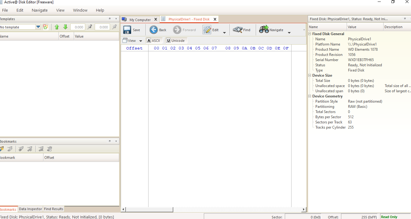

DiskEditor ended up showing the drive.
But when I choose "Open in Disk Editor" the only thing that appears to me is what is in the image:
Any tips?

I have an external drive with Wiiu games hidden by ustealth. It worked fine for years. Now on Wiiu I don't see any games. When I connect the disk to the PC it is not recognized, which is normal as it is hidden
First of all, are we talking about a HDD for storing and playing WiiU games from it? This drive is encrypted and uses a filesystem (wfs) that is not nativ supported by any Operating system (Windows/Linux) and therefore will not be recognized and readable by a PC at all.
Ustealth is not intended and makes no sense for using it on a drive thats formated by a WiiU for storing WiiU games on it. Its to hide a drive thats used for the vWii, with GC and Wii games on it. So the drive will not recognized in WiiU mode, to stop the format nag. Alternative exists USBHide on Wiiu wich is more uptodate.
Changing the MBR Signature by Ustealth or other programms doesnt destroy your data on the drive. It simply changes a value that it will not recognizeable as drive that uses a MBR with its information about partition tables on it.
If the drive uses GPT partition table, the MBR might be empty. (MBR is located in sector 0, GPT in sector 1) .
The MBR or GPT can be restored normaly without any problems by some partition programms or recommended TestDisk. There exist some called superblocks with backed up MBR information on different places on the drive (only known by programms). Also GPT has a backup which is stored in the last sector of the drive. The WiiU drive is encrypted, so iam not sure if restoring the boot sector will work properly, all data may get lost.
In last case use a partition programm or Device management in Windows, it should show the drive even if Windows doesnt detect it directly and possible to reformat it completly (all data will be lost).
And like already mentioned, use S.M.A.R.T to check the condition of the drive.

Drives dont live for ever, some die earlyer, some later. There are lot of possibiltys what can corrupt a drive, e.g. internal damage or wear out of components.
//Edited: If the drive is fully dead and cant be recovered, the only chance is to extract the raw data by experts which move it to a drive with identical size. If the drive isnt fully damaged, a raw copy of the data can be done.
To recover the data at least the drive must be functional a last time, so it would be possible to clone the drive on the WiiU by linux dd command or USB Guru Cloning Application. Discused here in cloning WiiU USB HDD.
In the other hand exist the WFS tools to backup the data from the WiiU drive to PC and inject to a another one, but the tool is still experimentel. The chance of recovering data from a corrupted drive was already discused in the thread recover data by WFS tools.
Simle way is if the WiiU game save data is stored on the Nand, in this case you only will need a new drive and writing the games again on it.
In last case if the drive is still funcional but dont show up on Windows. Go to device Management or use a Partition Manager where it should show up, able to format it and run a check on it.
