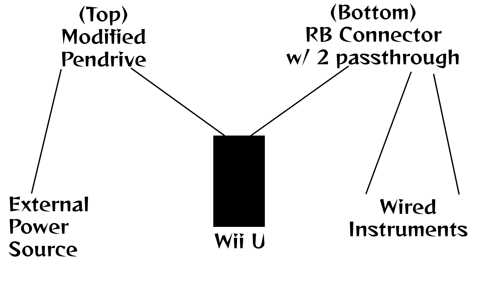

Forgot to update this thread!
Got it working, thanks to a friend giving me this setup: (see picture, uses back ports, brilliant graphic design)

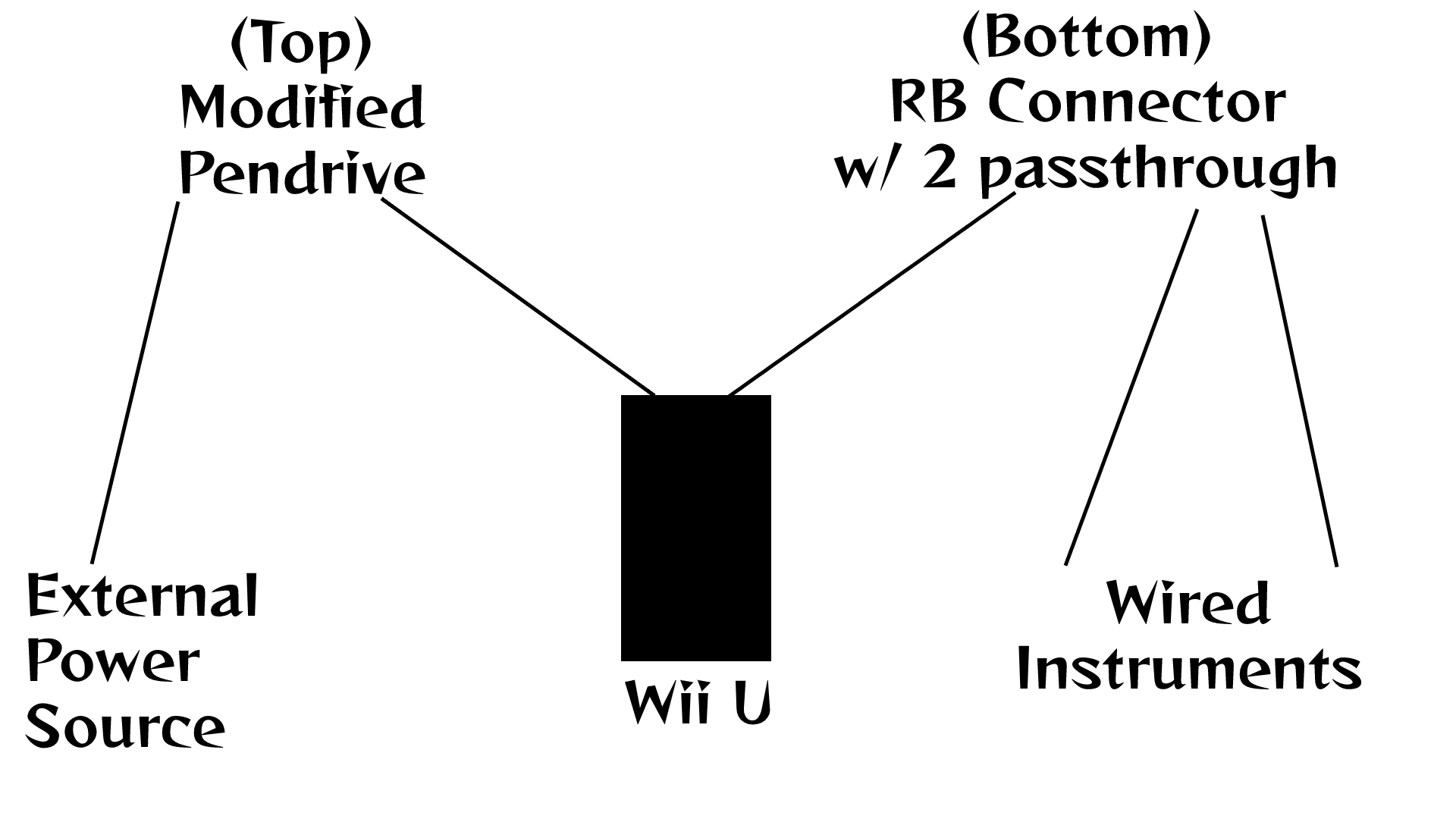

Got it working, thanks to a friend giving me this setup: (see picture, uses back ports, brilliant graphic design)View attachment 308276)
Yeah, that makes sense. Plus you should always use a port from something OTHER than the Wii U if it needs an extra port for power.
