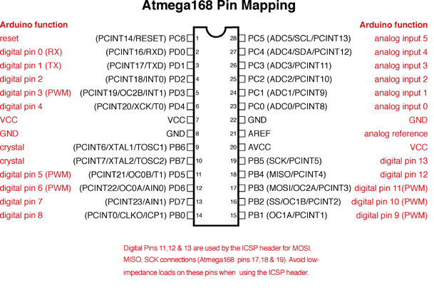

Let's talk about Arduino Uno, which is an AVR atmega328 chip.
Arduino provides libraries and abstractions, for example, digitalWrite(13, HIGH) is wired to the red LED. In reality, the AVR cpu don't deal with individual "pin 13", but rather with Port, where one port consists of 8 bit, thus 8 pins. So digital pin 13 would be on port B bit 5. So writing PORTB = 0b00100000 would turn on the LED.
Now what is PORTB? PORTB is just an addresss pointer that you can write values into. This snippet of digitalWrite should give you a glimpse on how it looks like.
Access to peripherals (such as digital pins, thus giving you LEDs) are often time achived in similar fashion. This is called Memory-mapped IO (MMIO), so anytime you have an address pointer, it doesn't have to be memory in RAM, you could be "talking" to LCD, timers, etc...

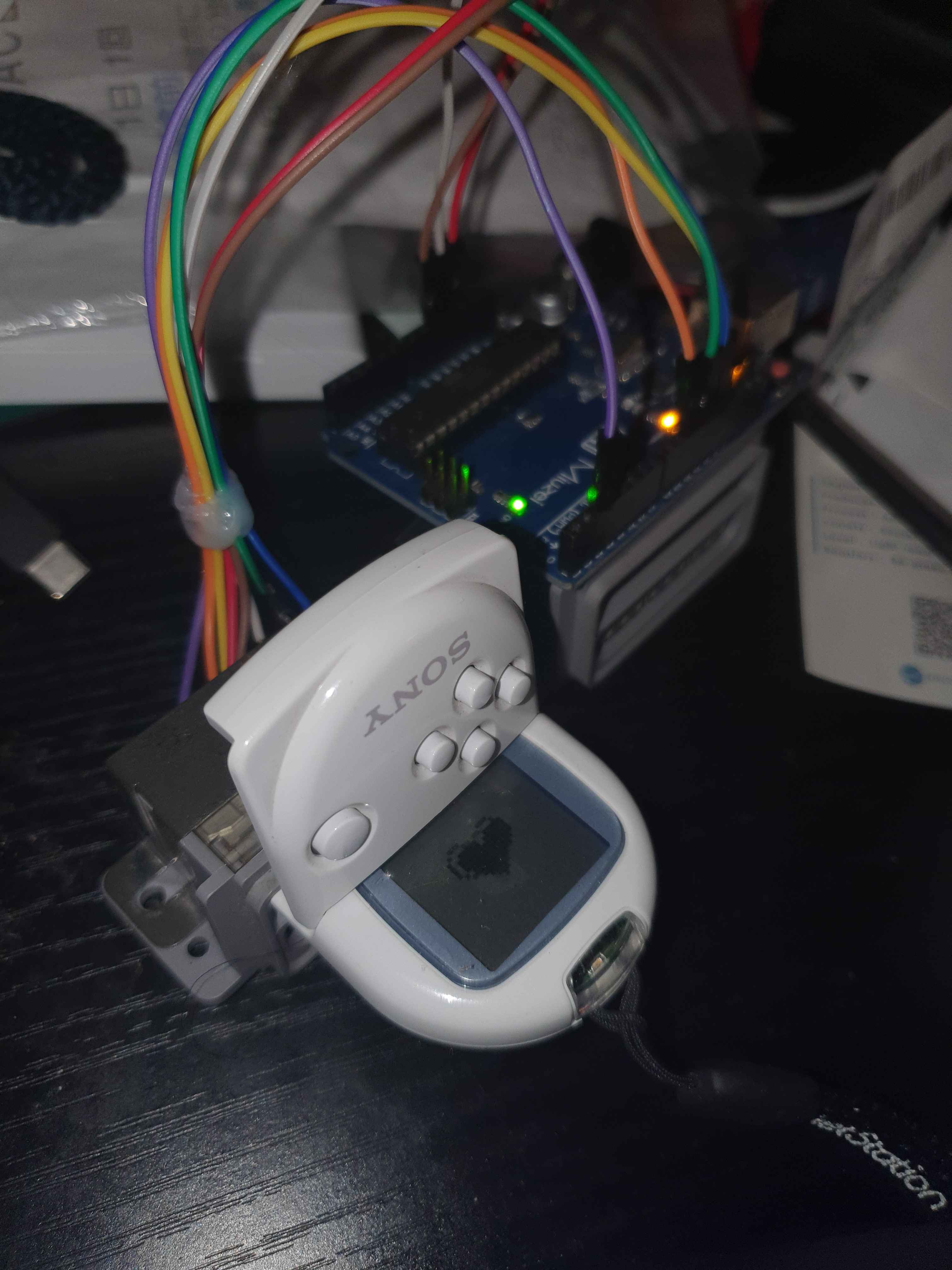

This is my setup for uploading to pocketstation!
I'm using a definitely modified playstation multitap adapter, open it, and wire it to arduino. Wiring and Program follows memcarduino
It has a python program you could use to "flash" as well as integration using memcardrex.
So... I guess the flow for me is:
rust code -> compile using cargo to produce .elf -> use objcopy to produce .bin with appropriate headers -> use psx-mctool to create a memory card .mcr file -> use memcarduino.py to upload via arduino

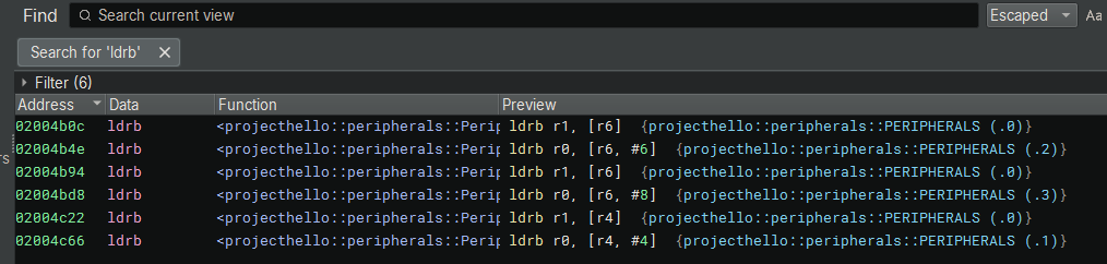

There were a couple of issues I need to fix. Some functions need to be in arm mode. (arm exceptions). Of course, I could switch between thumb/arm as I wish for the majority of the code. In Rust, I just need to use #[instruction_set(arm::a32)] for switching to arm (t32 for thumb).
There was a weird crash issue when trying to draw images. The mouse sprites you're seeing is just a bmp image, decoded with tinybmp, but due to some logic of switching images based on frame number, I'm seeing this:
Normally I'd be delighted seeing jump tables, I assume they're super fast!
But wait! Why do I see `ldrb`? I thought I have disabled it in my llvm patch... I think there's another path for lowering jump tables, and maybe it got bypassed. I'm assuming LowerBR_JT in LLVM is the culprit. However I'm exhausted of modifying llvm and would avoid it if possible.
Then I found this linker options I can pass in RUSTFLAGS: `-Cjump-tables=no` which disable jump tables.
Doing so, I got rid of `ldrb` instructions! Now all usages are from static ram (which is totally fine).
