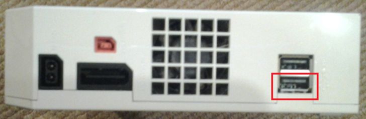

Please check if your USB Device is connected to the correct Port 0:
Thank you.:)
Thank you.:)
Assumed this whole thread was dead, didn't get an email notif. But yeah that is the port I am using, I can load GameCube games via Nintendon't fine, which is also located on my USB device, but with USB Loader it simply does not work.
