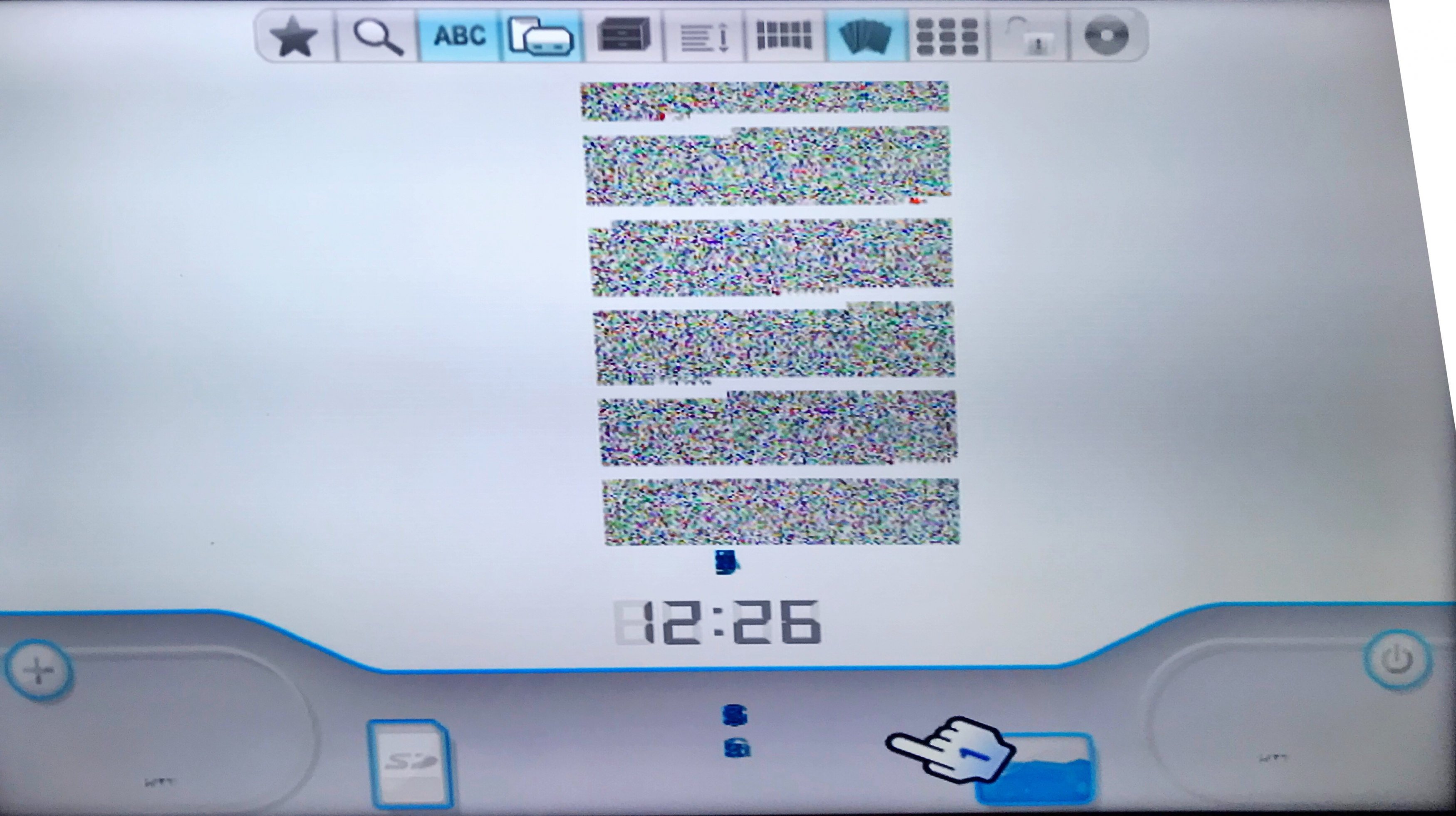

I've got a 4 TB WD Blue 3.5" drive in a Vantec USB 3.0 enclosure with external power. If I format it as a 2TB FAT32 MBR partition I can load GC/Wii games fine. However, I want to use the entire 4 TB by creating two FAT32 partitions where the first partition is for GC and the second is for Wii games. I've used many different formatting tools, but none of them seem to help in getting this working. Whenever I use USB Loader GX 1272 with two GPT partitions formatted as FAT32 I cannot load any of the games. I either get the error stating "To run GameCube games with Nintendont you need to set your 'Main GameCube Path' on the first primary FAT32 partition" for GC games or USB Loader GX crashes with the "Exception (DSI) Occurred!" error. The menu also looks messed up at times when navigating throughout it. I'll attach an image so you can see what I mean. So my question is, can we use multiple GPT partitions? I've seen a few posts that seem to indicate this has been fixed, especially if they are both FAT32, but I can't for the life of me get this to work. Here are some things I've tried so far:

Try formatting your partitions as Primary instead of GPT? I'm also not sure if the Wii can "see" a 4TB drive, even partitioned into two 2TB sections. (Mine's a 1TB drive, parted into FAT32 for GameCube and NTFS for unsplit Wii ISOs)

Hello,
Report syscheck ==> perfect.
It may be your external hard drive that is problematic, see with another external hard drive or in your surroundings.
