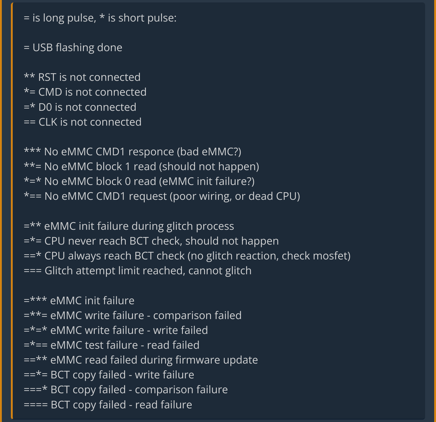

got it, if i just take the emmc and put in the original slot, it goes normally, soo maybe is the board the chip right?View attachment 456207
Your emmc (either) ribbon cable connector or board may not be seated properly.
and thank you for the help!its seated on the rp2040 just fine, i think its the install, gonna redo the soldering points
For future reference, share pics of your soldering if you're the technician installing chip. Good luckits seated on the rp2040 just fine, i think its the install, gonna redo the soldering points
