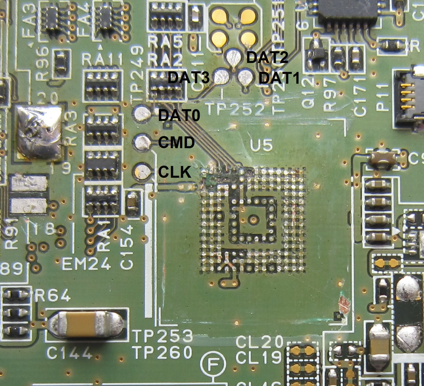

Made an emunand from the broken NAND backup, ran CTRTransfer on it and now if I NTRBoot into Luma, it actually loads the system correctly.
I don't suppose you could flash the fixed NAND image to an SD card, cut the CLK line and solder in the SD to these points:?
