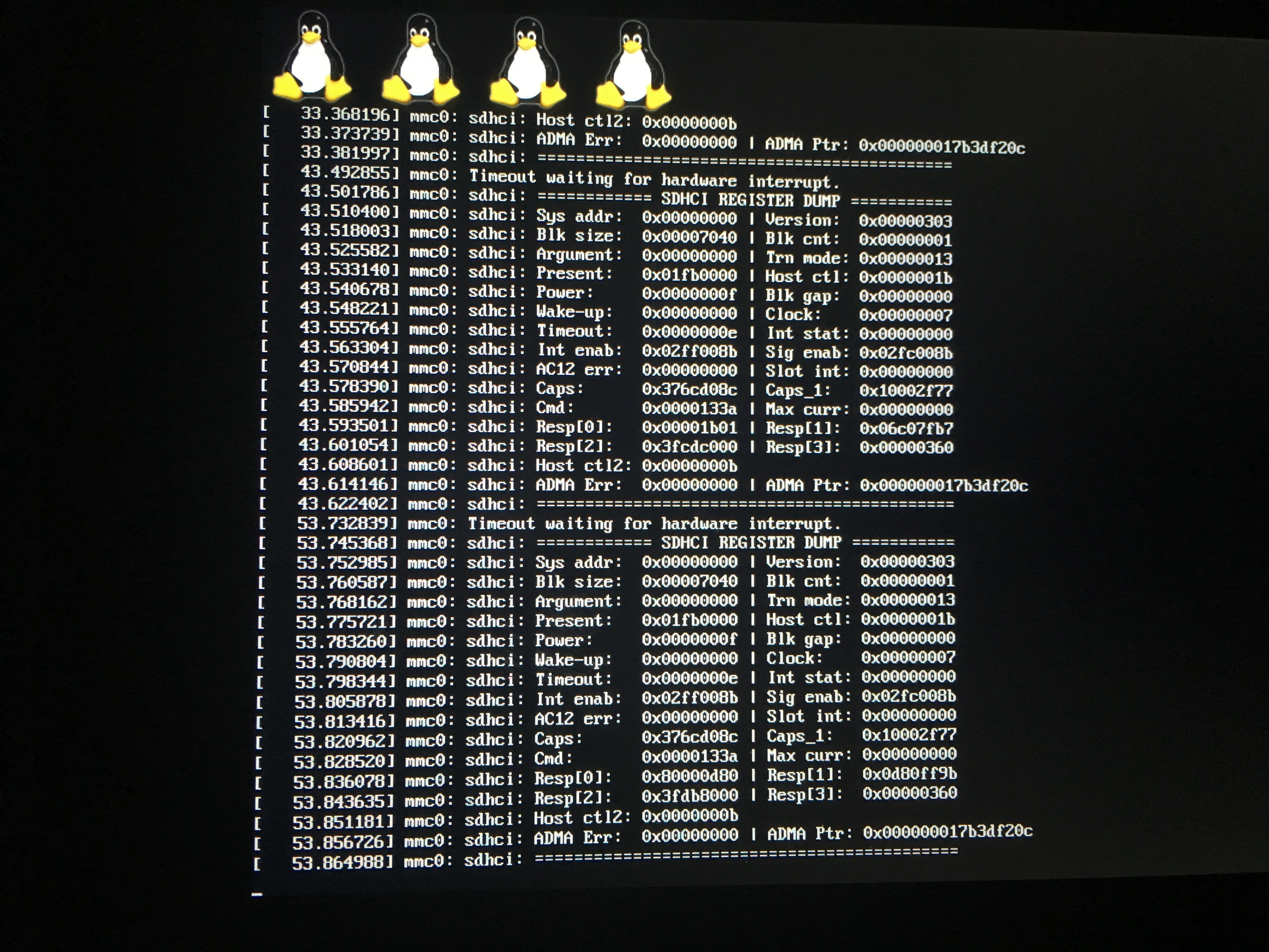

I used Linux mint to extract the prebuilt Ubuntu from your GitHub onto a 128gb MicroSD, then used tegrarcmgui on Windows 10 to run the Linux bootloader because the Linux one wasn't working, but I get this on my switch it just scrolls with the same thing over and over, any ideas?
Turned out to be because my 128gb MicroSD is SDXC and isn't supported :( next best thing I have is a 4gb lol
