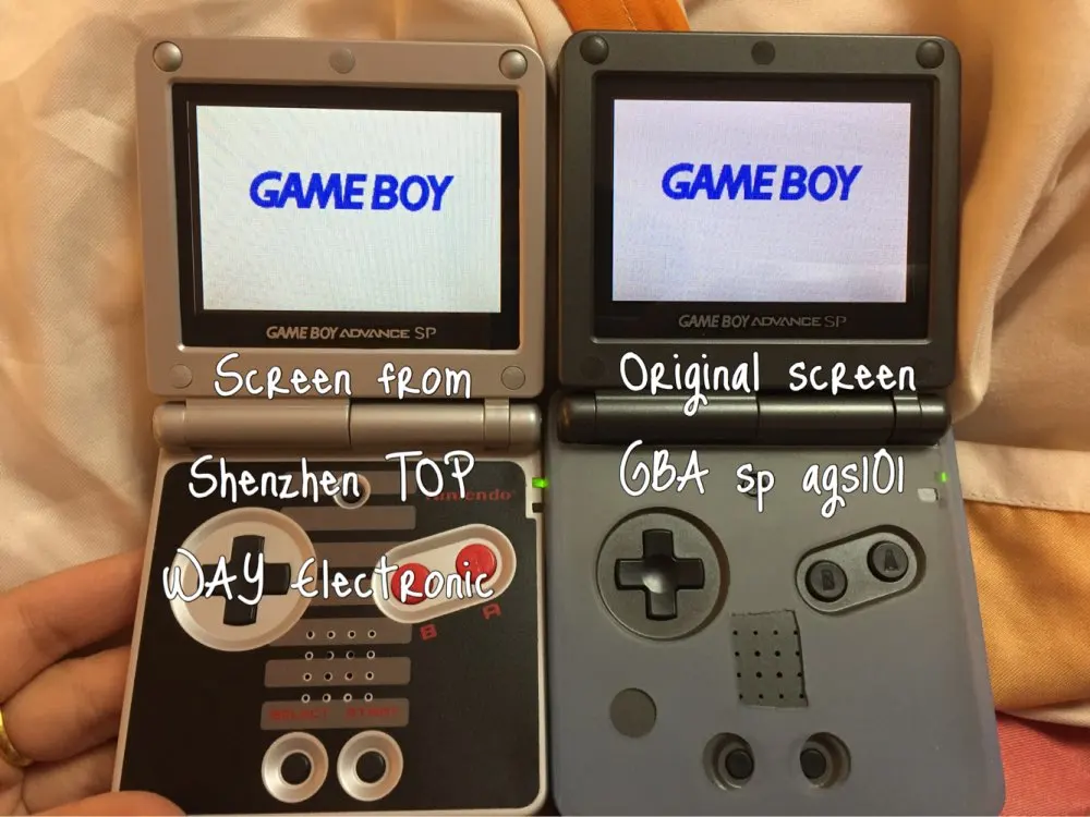

    Could it be that one of the screen is aftermarket? I recently bought an aftermarket AGS-101 screen at aliexpress
    to modify my normal GBA and one of the feedback posts had this photo attached:
    [​IMG]
    The original screen seems to be dimmer than the aftermarket screen.

    Aug 24, 2015
    As far as i can tell both screen are original, with the black pad on back and all. I had an aftermarket one for my gba 101 mod and it looked way different, but also had that screen studder hmm.
