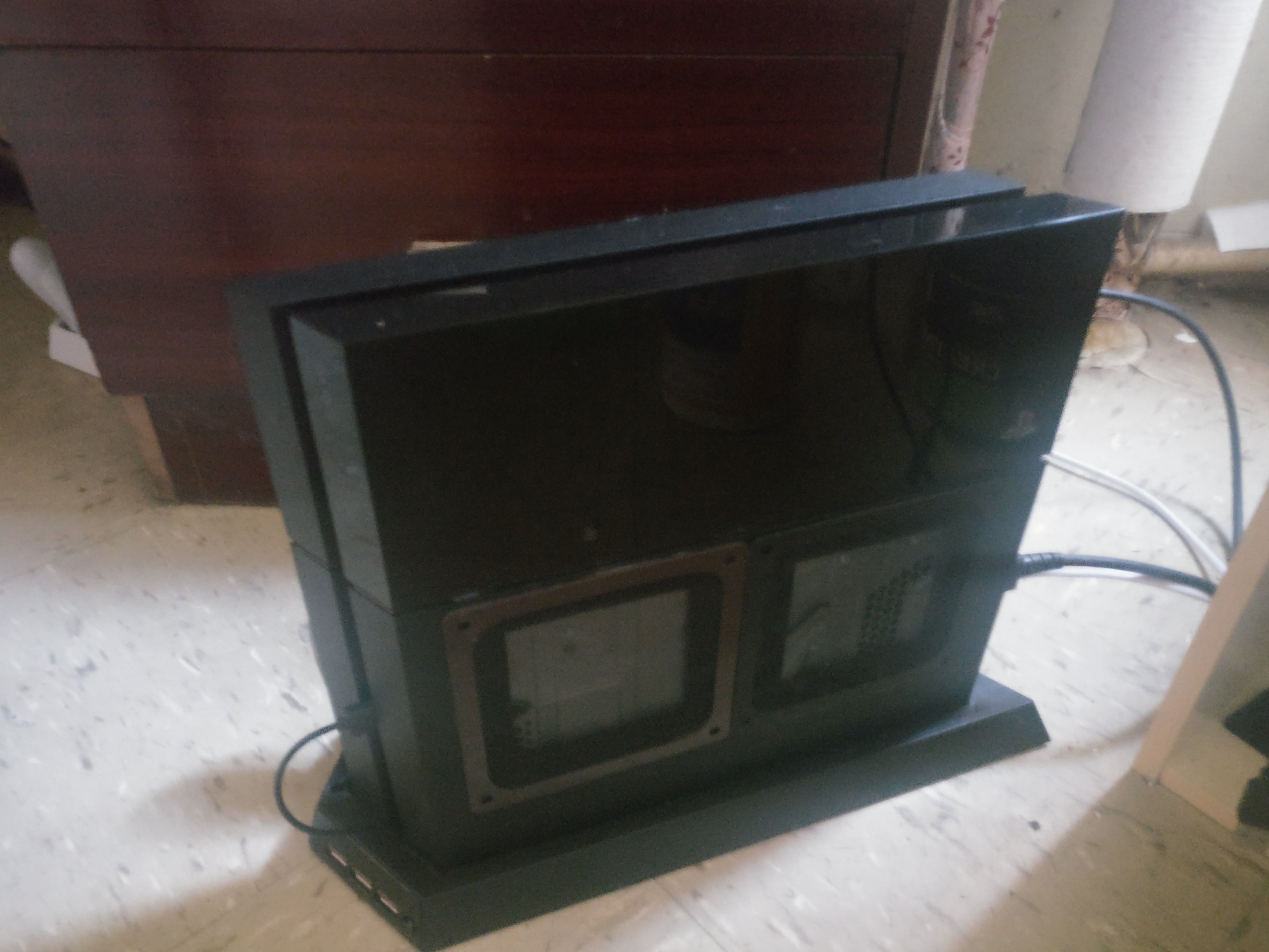

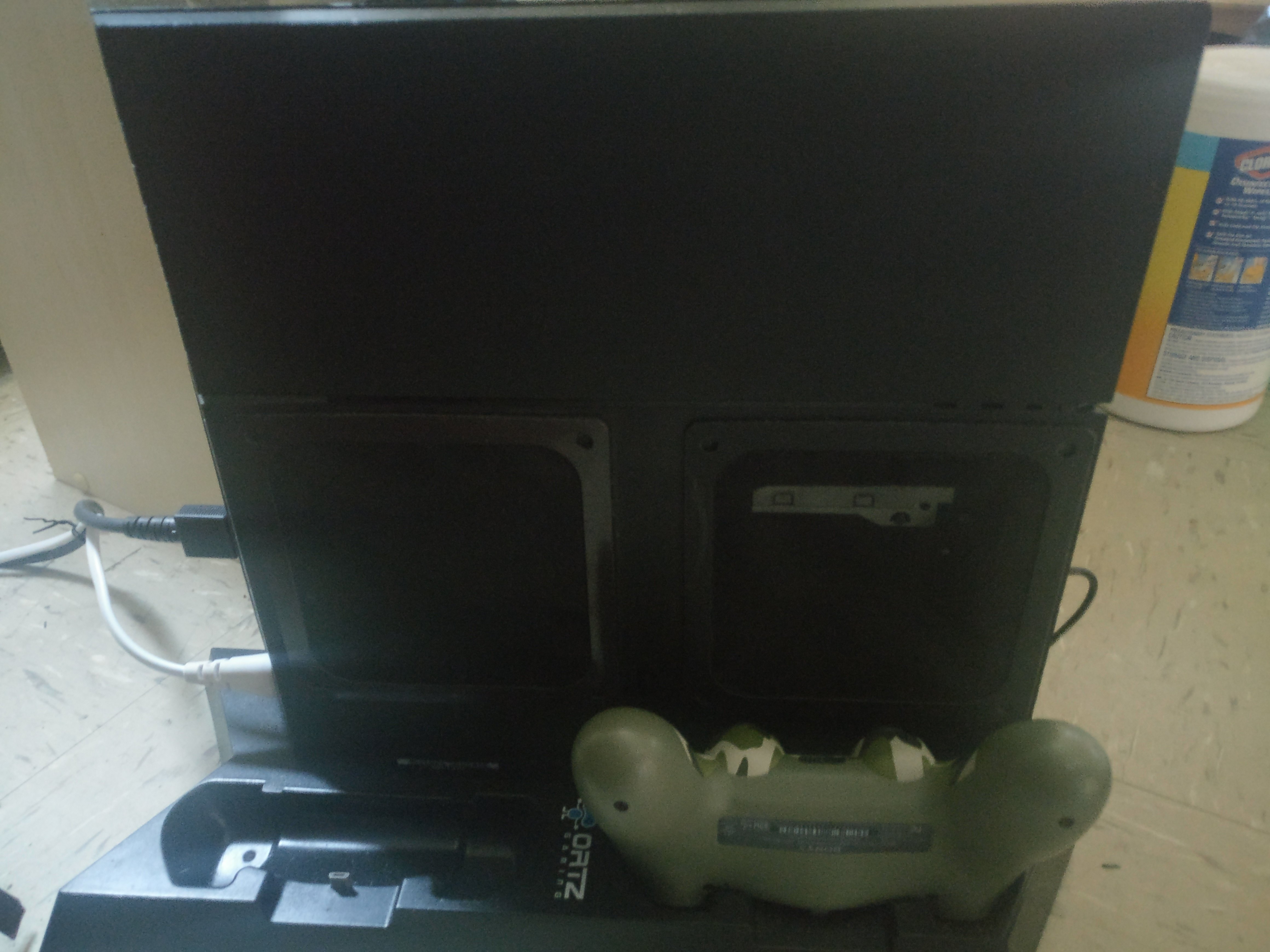

Hey @Zyvyn I'm not sure if you want to mod your casing, but this is an option, using 120mm fan filter. By the way are you using any cooler for your ps4?
no form of cooler and I have a 1215A model which is build very differently so this exact method might not work
Well probably should get a cooler if it does get hot, the 120mm thing is pretty much optional, even if you want to do you just need to figure out which area is the fan, to allow some better air flow in and out of the PS4, other areas with the 120mm fan filters is like optional to whether to have it or not.
