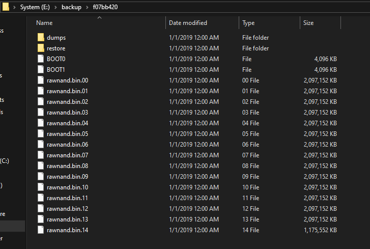

Once upon a time, Dax_Fame was switching to Atmosphere CFW emuMMC.
He did backups and they verified via Hekate 5.0.2 on two different SDs.
He then accidentally booted CFW on his eMMC but didn't do anything and immediately shut it down.
When he went to restore his backups they were not on either SD card, instead just empty folder.
TOO STUPID-DIDN'T READ:
While trying to setup emuMMC I booted CFW on my system and apparently don't have any backups to restore...
I didn't do a damn thing on my system other than shut it down because I realized what was going on.
Would this generate anything (like dirty logs) on my system nand to get me b&???
Q: How did you do something so stupid, you noob?
A: I don't know how to boot the emummc after I created it. I used sdsetup website as a guide but still couldn't boot. No boot config found. I chose the fusee payload and it booted my sysnand.
Thank you, anyone in advance
BONUS:
When I try to run another backup it says one already exists... I'm so confused. One SD is empty, the other has this (attached image) in it.
Restore>partitions directories are empty

If I remember right when i did my emmc expansion i had to copy the files from the backup folder to the restore folder did you look at this thread it might help you
https://gbatemp.net/threads/backup-...-your-biskeys-tseckeys-keys-txt-guide.513386/
Thanks.. the only thing concerning me now is it says I should have 3 files, not 17... but it is for a different version. Not even sure if I should attempt.
DAMN I so badly want to stop using SX OS but this is giving me a headache, especially since I might've dirtied my logs from that CFW boot, like an idiot
They say to use those 3 files becuase they contain everything but there should be more files when you make your backup so your backup looks good
