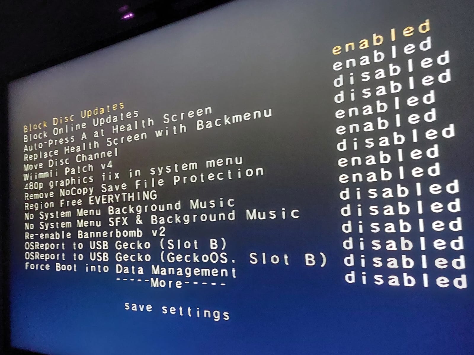

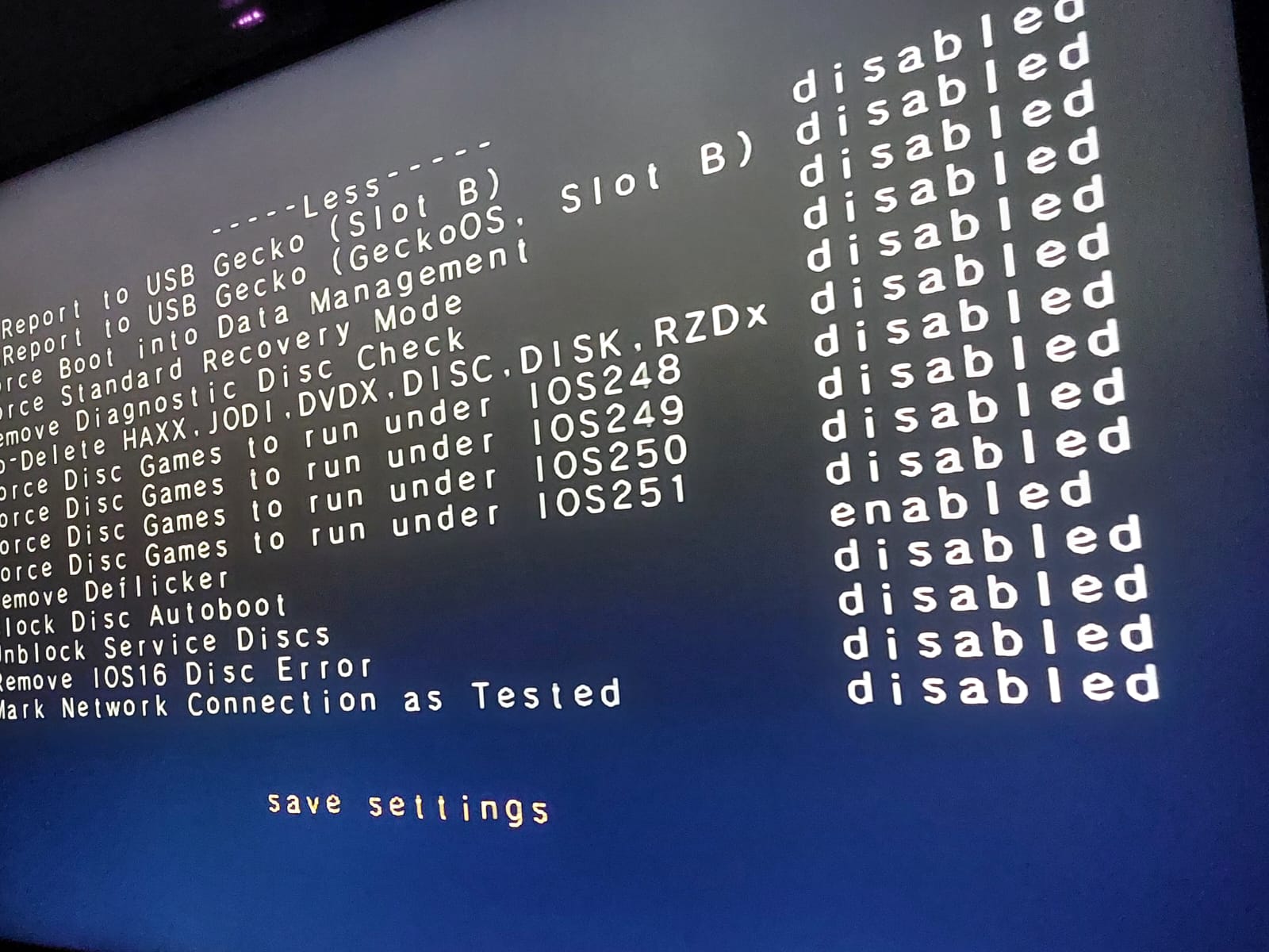

Yes, these are original discs. They get recognized by the disc channel but all I get by lunching them through the disc channel is a blackscreen. The discs run when I lunch them through wiiflow, and the wierdest part is that when I run backups via sd or usb I get a blackscreen as well. These are the patches I have enabled/disabled:

Could it be remove deflicker? It may be enabled in both priiloader and gx by default and disabled in other loaders? I'm not certain about that though
Edit: maybe a video mode issue? Do your wiimotes stay connected on these blackscreens?
My wii remotes disconnect during the blackscreen and the only way to shut down the console is to hold the power button for a while... I removed the deflicker, and when I tried to lunch some backups it redirected me to the hbc...

Try disabling all priiloader system menu hacks (except for blocking updates) and see if you can load games from the disk channel (re-enable the hacks after the test if it still fails, and if it works reenable them one at a time until u find the one that breaks things)
If it doesn't work I think at least part of your problem might be hardware related. You could do a fresh ohneschwanzenegger nand installation (which carries a bit of risk if u don't have bootmii installed as boot2, directions here https://wii.hacks.guide/wii-factory-reset.html), so it's like the Wii was just unboxed. If that doesn't fix it then u know for sure hardware issues are at play
Backups not loading from sd or usb is one thing (could be bad rips, bad settings, incompatible drives, etc), but original disks not playing from the disk channel even though you're running stock IOS is strange. Even more strange that it works when launched using WFL, perhaps Wiiflow is doing something to bypass hardware issues? I mean, that would be awesome if that was the case, but seems unlikely.

Disabling system menu hacks didn't work, but I can't install bootmii as boot2, only as an ISO. How common is it for a wii to get bricked while trying to get a fresh nand installation?
