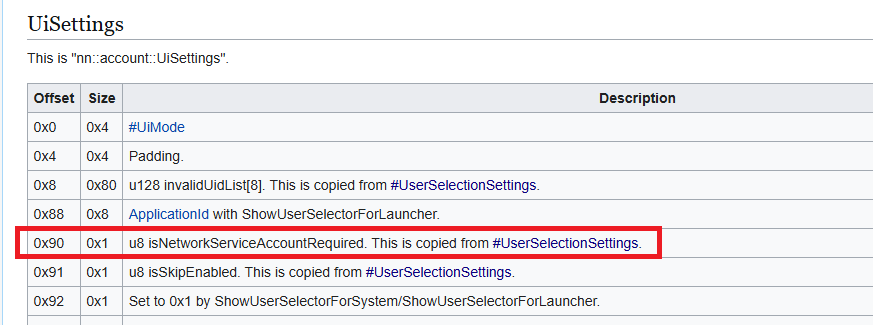

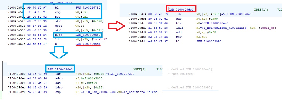

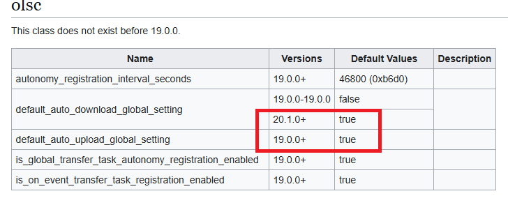

i still heavily disagree with deploying atmosphere config files to end users systems. It is beyond the scope of what both sys-patch and the overlay is supposed to do.
I'm also disappointed you continue calling deploying the configuration file as "Linked account loop fix", despite me telling you it's not.

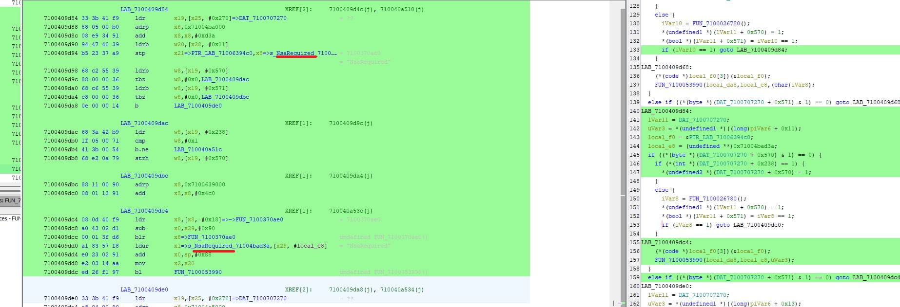

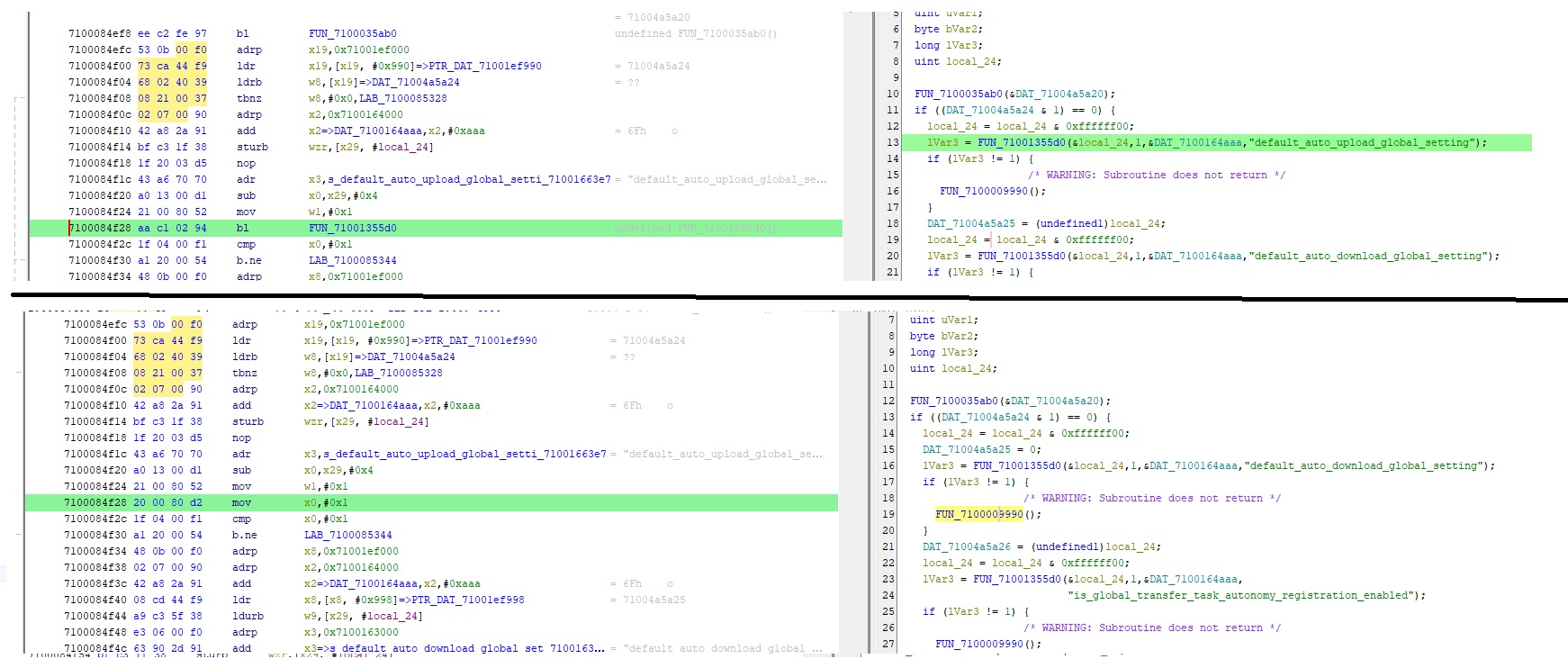

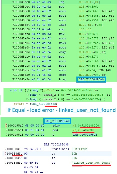

why not just patch olsc itself? I've provided enough information already, and you claimed you were going to investigate.
i guess your LLM/AI couldn't figure it out?
patch constant:
200080D2 (mov x0, #0x1)
cond constant:
.. .. .. 97 (BL)
.. .. .. 94 (BL)
pattern:
all firmwares:
00 .. 73 .. .. F9 68 02 40 39 .. .. 00 .. .. .. 00 (ghidra)
00.73..F968024039..00...00 (sys-patch)
6.0.0 to 14.1.2
offset: 42
15.0.0 to 18.1.0
offset: 38
19.0.0 to 21.1.0+
offset: 42
21.1.0
792DD5A46F44C0BFC017A3BAB9BB347CB51E90E7.ips
50415443480850280004200080D2454F46
085028
0004
200080D2
example implementation into sys-patch:
https://github.com/borntohonk/sys-patch/commit/a4cabed80a528326811395e3638f63842a797b49
https://github.com/borntohonk/Switch-Ghidra-Guides/blob/master/scripts/known_patterns.py#L187-L224

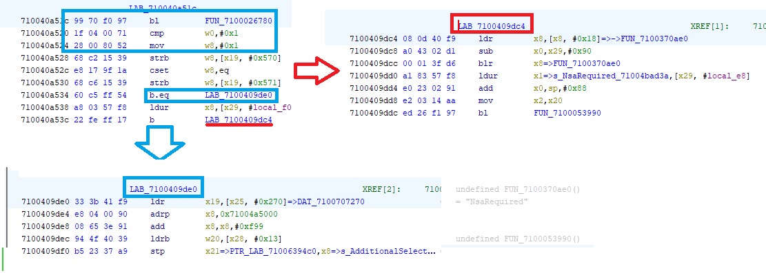

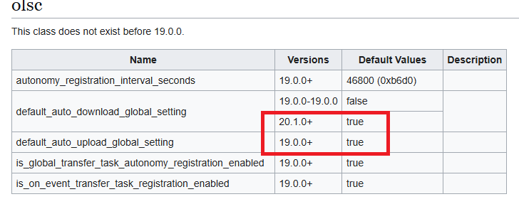

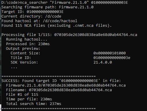

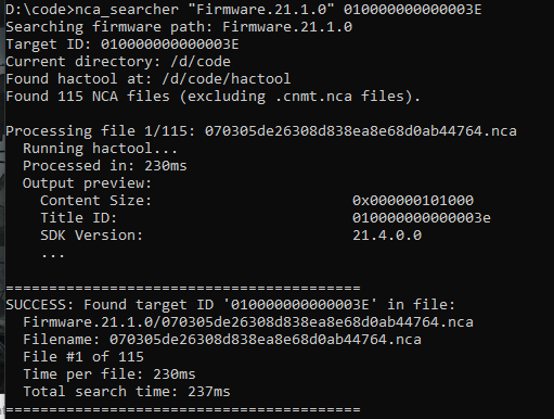

Here's a small tool (source code) I made to search firmware nca files for titleID, I also made a python version but this is pretty quick.
How to compile:
g++ -std=c++17 -o nca_searcher.exe nca_searcher.cpp -lstdc++fs
strip nca_searcher.exe
How to use:
Put hactool and keys.dat in the same folder, then run like this;
nca_searcher "Firmware.21.1.0" 010000000000003E
FYI - you put the wrong address on your IPS patch for 21.1.0 - it should be: 08 4F 2C (according to your picture & IDA)
50 41 54 43 48 08 4F 2C 00 04 1F 10 00 F1 45 4F 46 (Changing 0x1F0400F1 to 0x1F1000F1)
(note: Patch above doesn't fix the loop issue)
So after the offset correction for IPS patch, you should check your patch pattern because...
Pattern for 19+ "00.73..F968024039..00...00"
Pattern Found Offset: 0x084FFE + 0x2E = 08502C (crashes switch)
Probably you need to recheck for FW 21+ (I didn't check any other firmwares) & check the patch because the offset you gave in the IPS crashes the switch, and the "corrected" offset doesn't work.

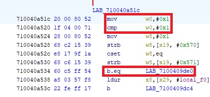

with the header included of the uncompressed binary (.nso0) it is 08502C. You're missing 0x100 (the size of the header)
https://switchbrew.org/wiki/NSO0
the only changes i would make would be:
(OLSC) an arm instruction with ending of 0x94 was found at the designated offset.
(OLSC) Sys-patch for OLSC string still valid for: 21.1.0
(OLSC) Sys-patch OLSC pattern found at: 085028
(OLSC) The ghidra-equivalent pattern used was: 00 .. 73 .. .. F9 68 02 40 39 .. .. 00 .. .. .. 00
(OLSC) The existing bytes at the offset are: 8AC30294
(OLSC) 21.1.0 OLSC buildid (and what .ips filename should be): {'792DD5A46F44C0BFC017A3BAB9BB347CB51E90E7'}
(OLSC) IPS patch bytes would be:
(OLSC) 50415443480850280004200080D2454F46
targeting the Branch Loader above the cmp identified, and patching it to mov x0, #0x1 will skip it entirely. (apparently failing said cmp check causes a crash function to be called of 0x9990)
08 50 28
00 04
20 00 80 D2
(compiled output of https://github.com/borntohonk/sys-patch/commit/a4cabed80a528326811395e3638f63842a797b49 attatched)

Since you already have the patterns, you may as well also set: default_auto_download_global_setting to false since it's just a few bytes away at 0x085060 (and its default was changed in 20.1.0+ to true) you can use the same patch as you already have, but you may as well kill two birds with one stone since you are already setting default_auto_upload_global_setting to false and it's only a few bytes away from that.
Also @bth, I think you should add another patch to sys-patch. With DBI we can change an installed game flag "Edit Parental Controls - Linked Account Required", to force our game to require a linked account to run. We should find which module is responsible for this popup and then disable it so that there's no need for a linked account to play a game, sort of a link account bypass. That we we don't need to create a faked linked account to play some games or need to use airplane mode, or use DBI to remove the flag.
It could be this - https://switchbrew.org/wiki/Profile_Selector - isNetworkServiceAccountRequired

https://switchbrew.org/wiki/System_Settings#olsc
no need to, it defaults to false.

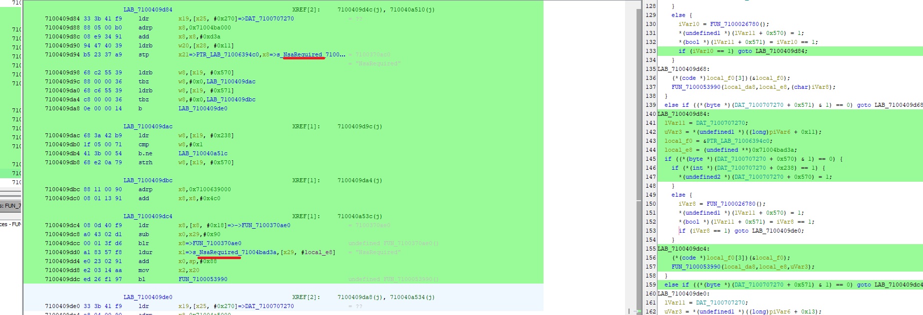

0100000000001007 - playerSelect (LibraryAppletPlayerSelect)
so let me understand this correctly, what you want is to force disable the requirement for linked account, rather than force it to require a linked account...?
depending on that b.eq it either goes to additional select (0x409ed0), or loading the value of nsa required (0x409dc4) (code probably loops over nested list and skips if not equal
patching
710040a51c 99 70 f0 97 bl FUN_7100026780
to
710040a51c 20 00 80 52 mov w0,#0x1
will have the cmp of w0, #0x1 be equal
710040a520 1f 04 00 71 cmp w0,#0x1
causing
710040a534 60 c5 ff 54 b.eq LAB_7100409de0
to be equal, meaning it goes to LAB_7100409de0
forcefully not ever going to 0x409dc4, where 0x409dc4 is NSA required

Hmm strange on this page it says it was false upto firmware 19.0.0, but then changed to true at firmware 20.1.0 - https://switchbrew.org/wiki/Switch_2:_System_Settings
Maybe for switch1 it's different to switch2 ?
As for the linked account thing, when a game is launched it must check the user account to see if it's a linked account, because some games will not launch if the flag for the game (probably in main.npdm) is for a linked game, There's a check " isNetworkServiceAccountRequired" which could be set to false which would make the game think it doesn't require a linked account, Either that or we can patch the account settings to report back that it's a linked account, even if it isn't.
https://switchbrew.org/wiki/Profile_Selector - isNetworkServiceAccountRequiredView attachment 547763

clearly the olsc system_settings from set_mitm atmosphere feature already accomplished what we wanted, which was just one entry, the upload one, which defaults to true.
so i don't see any reason to also patch download to false, which already defaults to false.
The switch 2 is not the switch 1.

to me it sounds like an obvious situation, that something that requires a linked account, but can't find any, would log... and this would be that.
identifying what exactly is in x10 and x13, would be step 1 of many.
