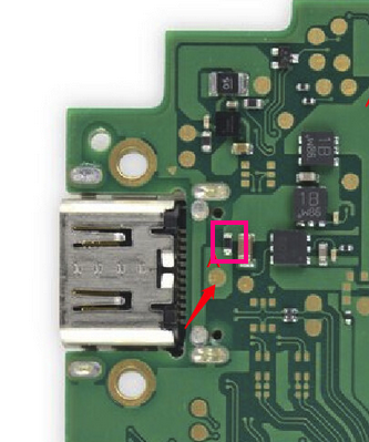

I need to find the fuse 1 for my switch, where is it??
This is why you use daybreak brothers
What's that?
Found this picture so it might be on the other side :
But if the fuse is broken, it is likely caused by something else.
Thanks for that! Just checking if the fuse works or not, my switch isn't turning on at all, VBUS has no power, but the fuse and m92t36 chip are all good... It might be BQ24193, but i can't find the capacitors or a place to check the voltage. I also need to know how to check m92t36 properly
