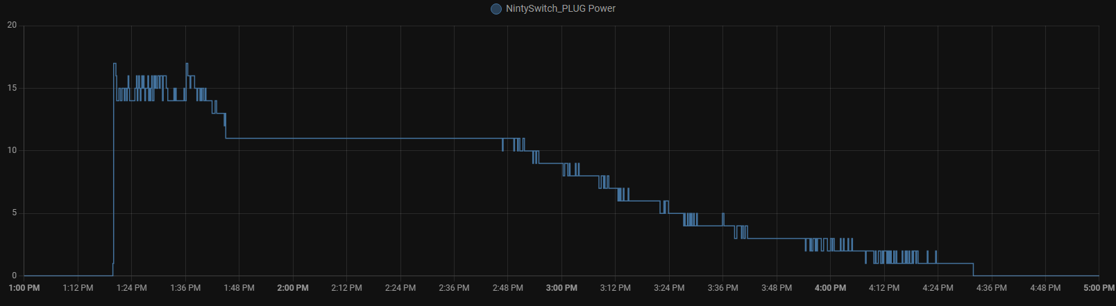

switch actually charge up the battery at full blast when its plugged in and in low battery state.
basically switch consumes about 16-19watts of power to charge up the battery from 0% to 10% after that, from 20% to 80% it charge around 10watts, beyond that, the charge rate goes slower and slower. Yes that little 20% left before full charge, switch basically goes to 5-2watts charge rate.
see image below for my switch oled charge rate over time from 0% charge to 100%. took like 3hours to charge it to 100%.
Not just talking about low battery state, but totally drained dry. It's a thing that you have to leave it plugged in for hours before it will show signs of life, as demonstrated in this thread and others before.
