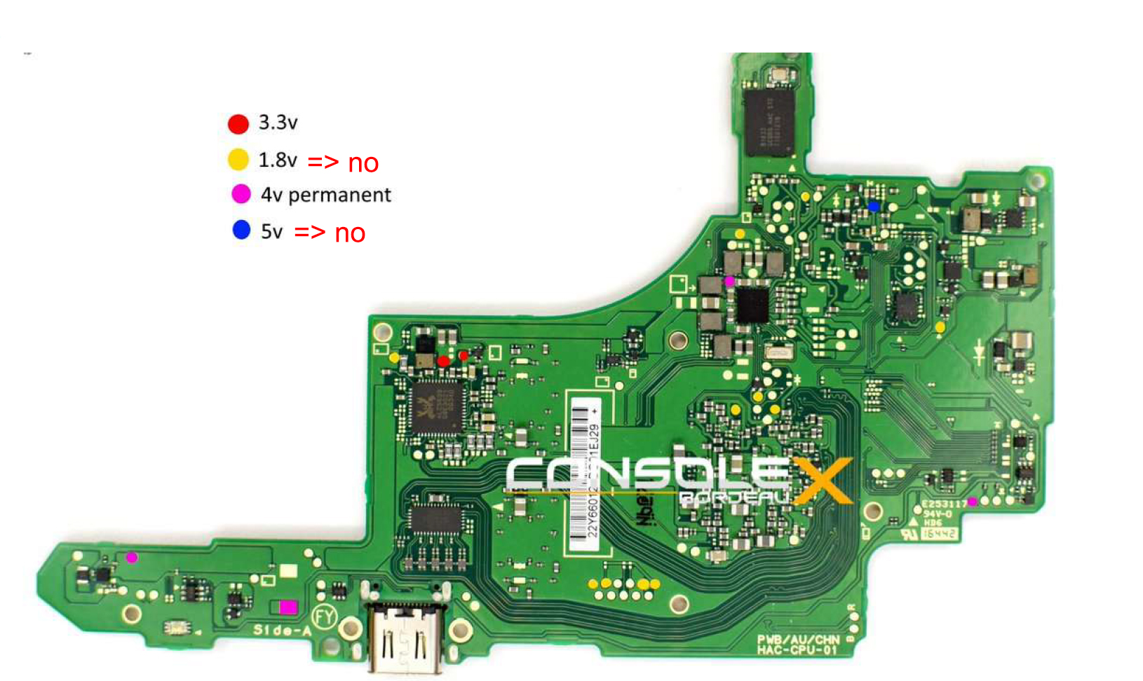

Thanks ! Screen of my mb

Can i check fuse or capacitor ? Got microscope id needed.
If the switch is bricked, there is no activity inside ? No fan ? No lcd backlight ?
After check i don’t have 1.8v and 5v
any idea about deffective component
