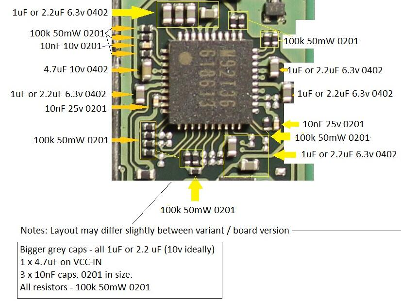

Bought as "for parts". Seller said it would work while plugged in, and had replaced battery with non-OEM battery. When I recieved, it didn't boot beyond the first logo and the black charging screen. I opened and there was a small amount of what looked like water damage around the back side of the usb port. After cleaning with toothbrush and alcohol, it now boots normally, but stops charging at 35% (Known functional battery). It's been plugged in over 24Hr.
Any pointers? Which areas should I be testing?
Pics are after cleaning. Thanks for any help!
Is the charging voltage around 4.2 volt?
If the voltage is lower than the 4.2 volt, your battery pack will not get charged beyond a certain charge,
The corrosion might be shorting some capacitor or mosfet that provides this voltage.
Those should be near the MT92.
Here is some picture with all the values of the components around the M92 :
More schematics and discussions can be found in this thread :

This is awesome! Thanks!! I’ll focus on this area..
