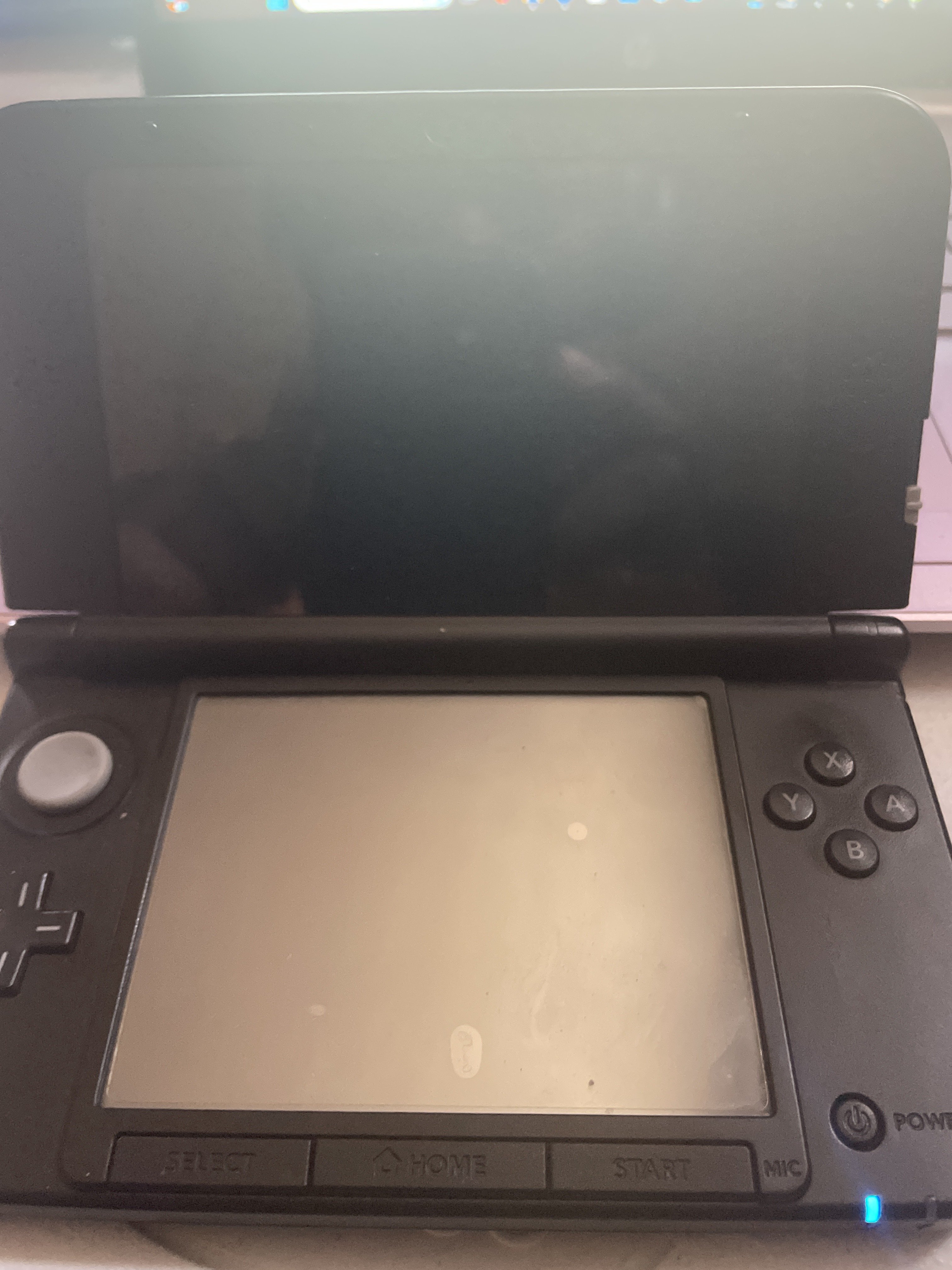

Hey there, first post here so hopefully I'm doing this in the right place I have a old 3ds xl that I modded then tried to region change it but I soft brick it

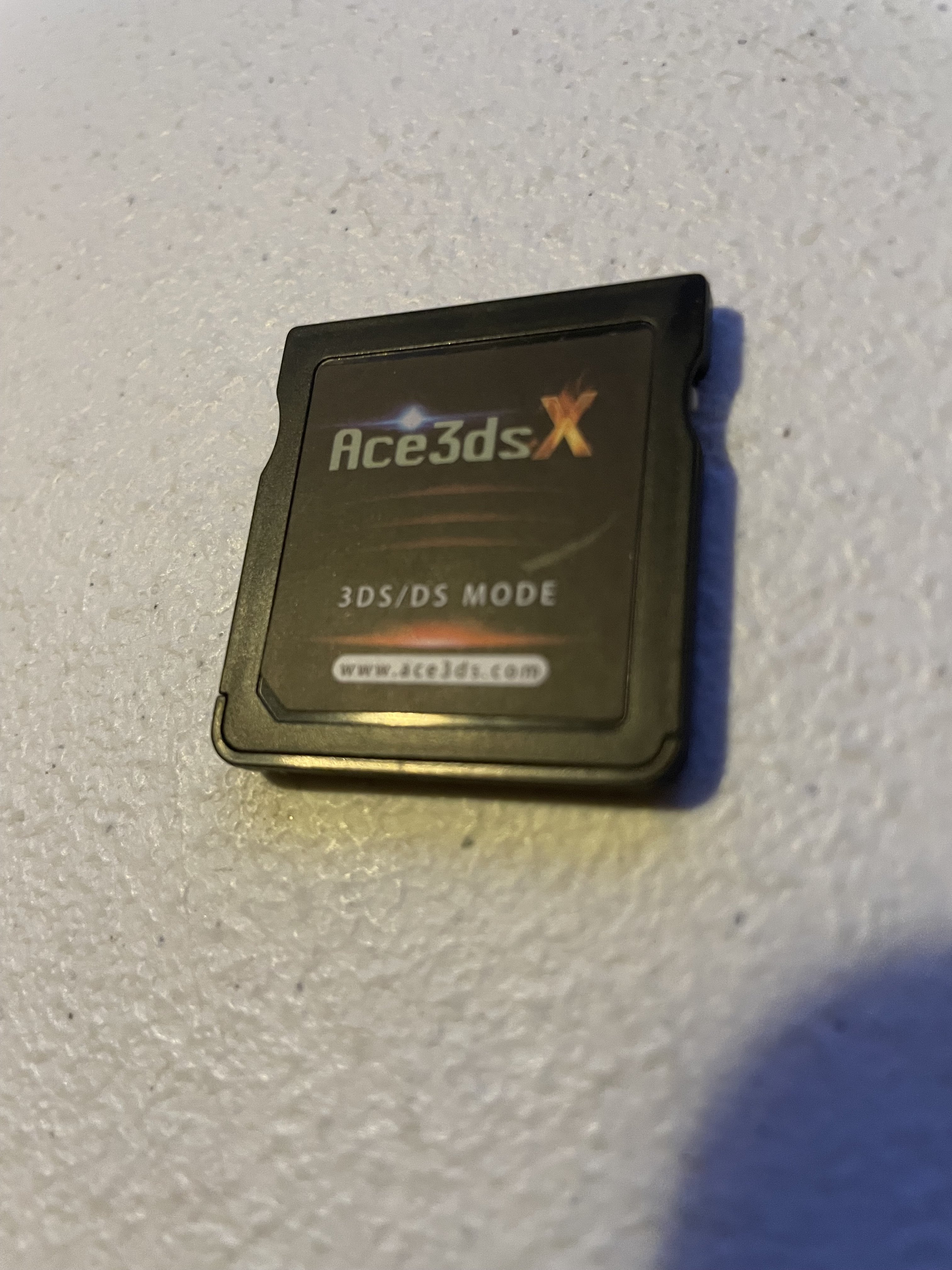

And I just recently got a r4 card to try to use ntrboot to fix it
But every time try do it it just turns off I have the magnet in the right place I’m holding the right button and I have the correct files on my sd card but it still just shuts off any help or suggestions would be appreciated! And again sorry if this is the wrong spot for this kind of post

Can you access the home menu without the sd card?
Anyway it might be the sd card is bad or the files on the sd card are not placed correctly or corrupted. It would help to know more, like what steps you took and when or how the problem occurred.
You clearly did not follow the steps correctly from the guide. If you were watching a video tutorial, then that explains your 3DS in this state, as a video tutorial has the same risks.
Try using your Ace3DS X to boot into your 3DS with the ntrboot method. https://3ds.guide/ntrboot
No I can’t access the home menu when the sd card is out of the console all I can access is luma menu and godmode9 menu
That’s what I’ve been following but it still just shuts off

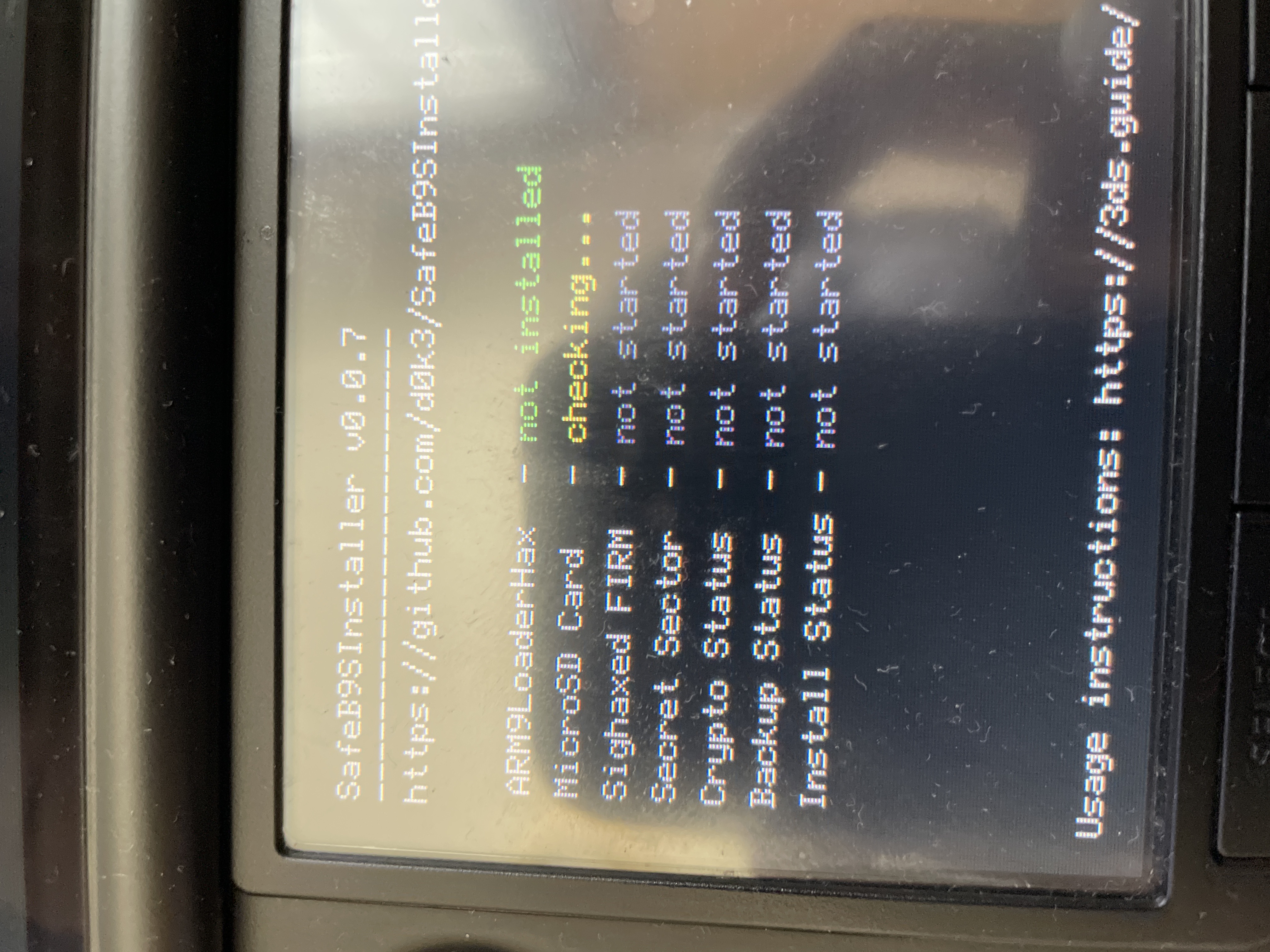

I tried ntrboot again and it now boots into the safeb9sinstaller screen but it’s just stuck on Microsd card checking
