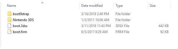

Now here's a screenshot of the current contents of my console's SD card:
  • View attachment 117732

Turns out my boot file was fine in that it was the correct one, what was happening was that my computer was automatically adding a layer of encryption to the files (hence the tiny lock icon on the boot.firm in the screenshot). Maybe this is your problem too.
