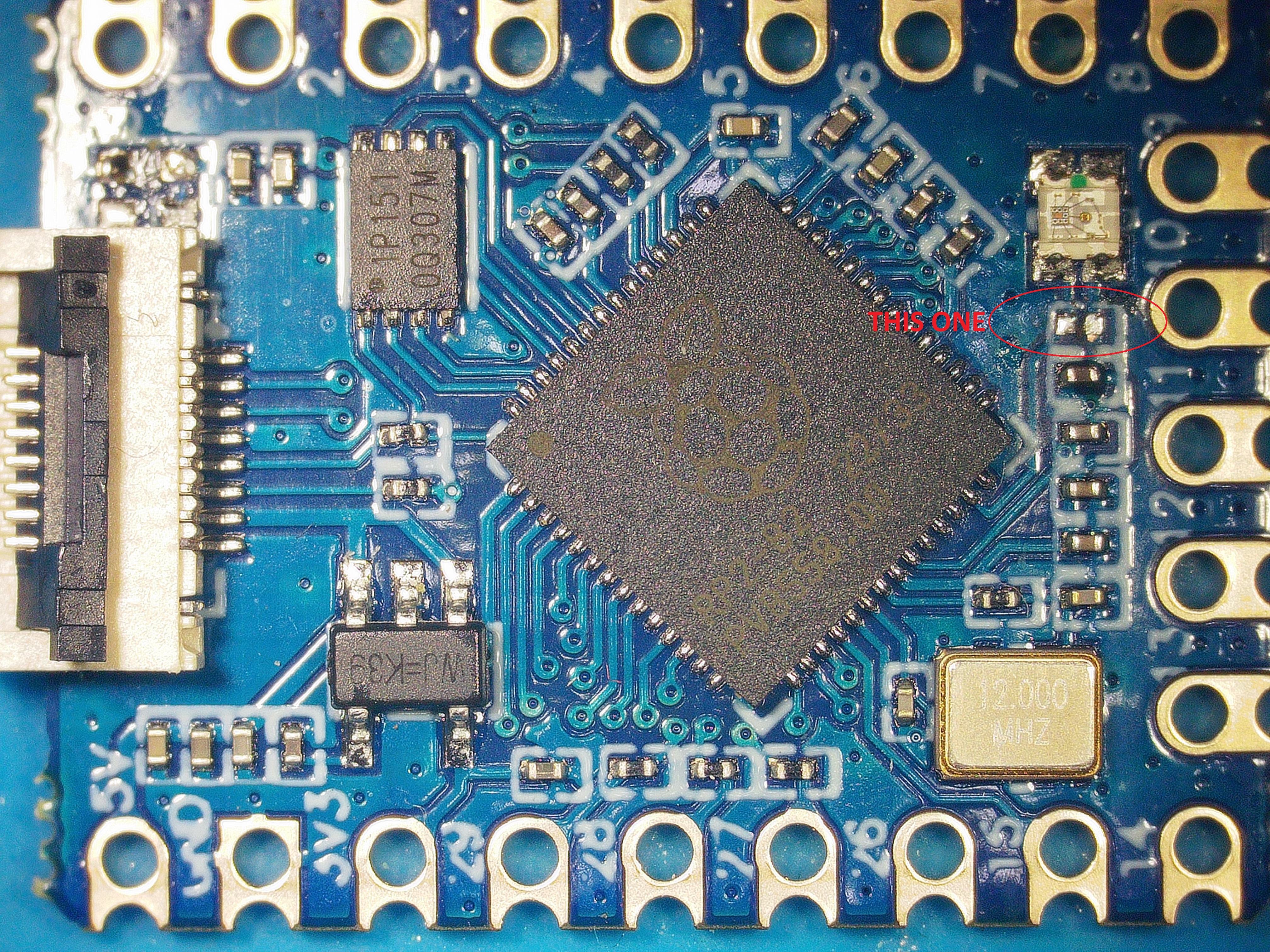

Hi, i bought about 20 RP2040 Tiny from Ali. They were cheap. I wasn't aware that clones existed. So. The led is totally off. I'm programming them with 2.75, so, i've read on some forum that if i remove the resistor near to the led, the led its going to work. So, i did it with one of them, and voila. The light it's on. Even for programming.
So. I have one doubt. Doing this have a side effect? Negative side effect? Can damage the console? Does anyone known this solution??
So, any comment about this subject are very kindly appreciated.
Thanks.

Shouldn't have a problem. That's what I've been doing with the clones from a batch I bought.

If you use the newest picofly firmware from @rehius there is a software-fix recognizing the boards with the pullup resistor so you dont have to remove it.
Good to know, I think I will have to buy from ali, because from waveshare official its more expensive to send to my country, I will take a risk with clones, thanks for your answer too
