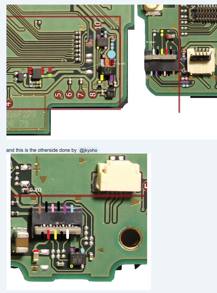

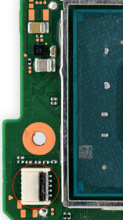

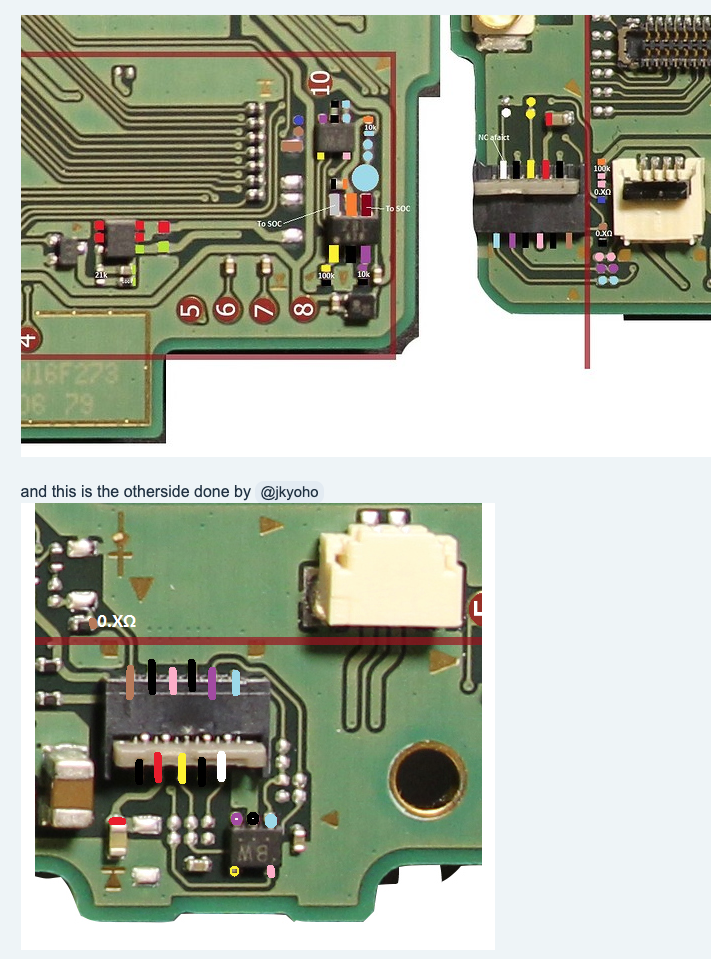

Hi, I have a Switch, the right Joy-Con no longer works. It's not the Joy-Con or the rail. What are the components that control the right rail, please? thanks

The joycon rails has a ribbon that might have a crack in it, or it might not be seated correctly in the connector.
Cracks can occur due to aging or when the Switch was modded.
The joycon connects almost directly to the APU/CPU so if your Switch was modded, check for scratches on the PCB.
jkyoho already made show measurements around the connector
More info here :

Thanks for your reply. I forgot to mention that it was an OLED Switch. I've already tested several controllers and nothing works. I looked at the Switch and nothing works. I just wanted to know which component manages the power supply to the right Joy-Con. Thanks again for your attention.
SHOW picture from your actual right joycon connector on the board.
FYI, not charging or not recognize from console are different scenario of not working, defines your symptom with detail

Hi, the OLED Switch doesn't recognize or charge the Joy-Con. I changed the connector, thinking that was the cause, but it didn't change anything. Thanks for your attention.
