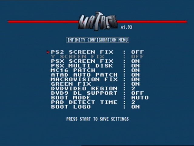

If it is really Matrix then try the following Combinations please:
Boot the PS2 directly into PlayStation Mode by pressing/holding the
Button when you powering on the PlayStation 2 (Game should already inserted please)
It that is not working please enter the Matrix Settings Menu by pressing/holding the
Buttons on Power Up.
and maybe try/set the PSX Screen Fix to ON please.

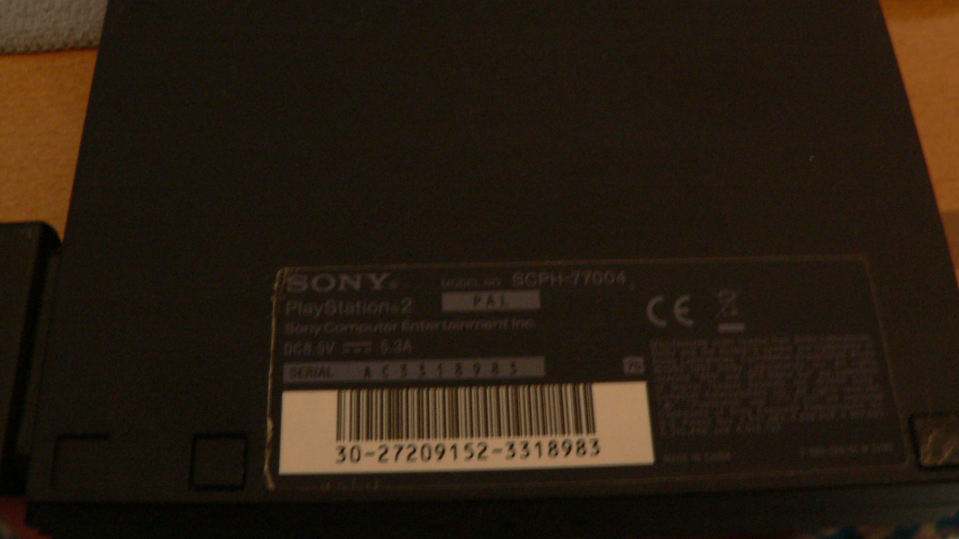

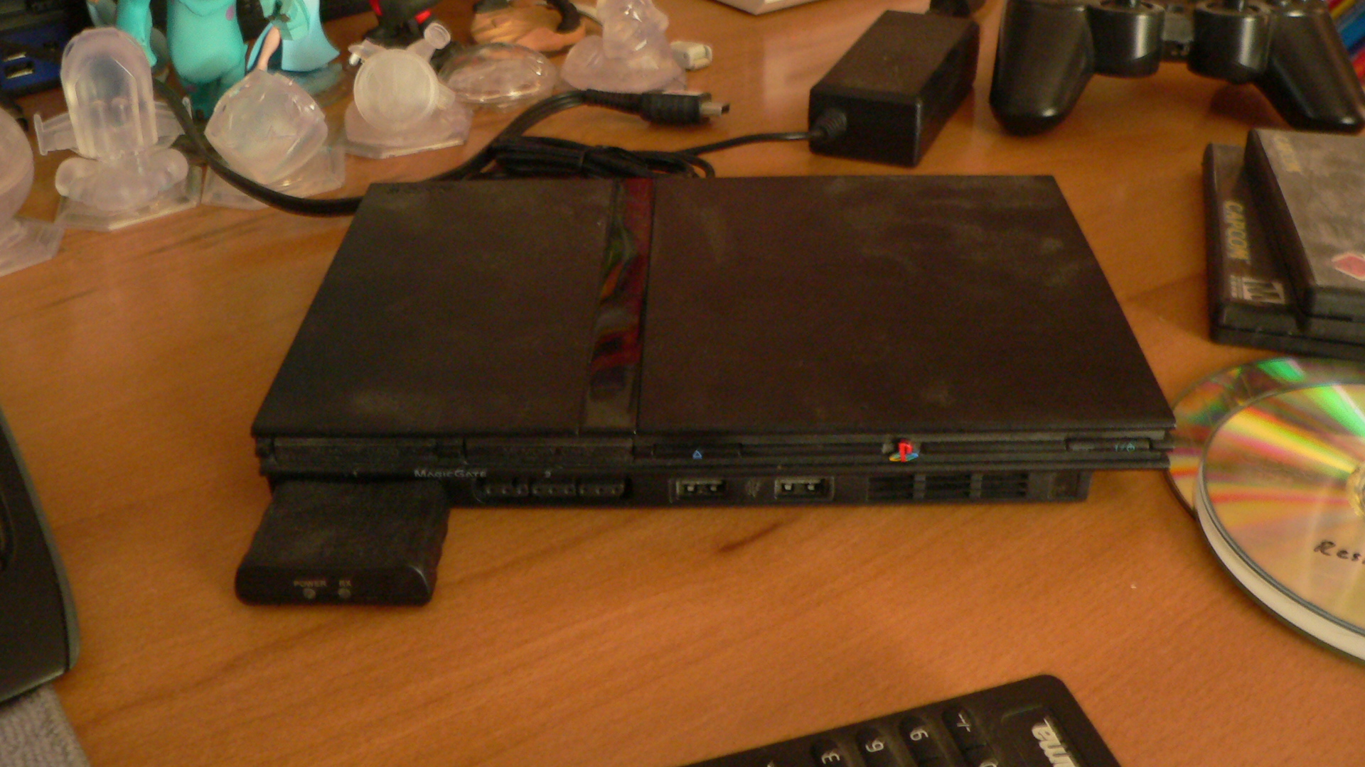

I tried it with an SCPH-77004 and (I think) a Matrix Chip.
It could also be a Modbo (Clone),the only Way to find it out is to open the PlayStation 2.:)

I used
- US Resident Evil 2 Dual Shock (I think it was burned 4 Years ago...)
- Resident Evil Directors Cut German from today (16x Speed)
- Resident Evil 2 German also 4 Years "old"
The Results are as expected,the US Version was "stubborn" but finally it also worked
Honestly I tried it the first Time to play PlayStation 1 Backup Games on an PlayStation 2.
Usually I use it only on the PSX.:)
A little Video from the "Test" if you like.
Thank you.:)

Thanks for the replies :) Been trying some more things (older writers, slower speeds), and have only been using Verbatim discs, but so far it really is just these Resident Evil's refusing to boot. I gave Dino Crisis a go, that boots but into the anti piracy screen, so I patched the bin file and that works perfectly now.
Tried holding circle on boot, no difference. All the options in the Matrix menu were on, so I tried a variety of off/on, still cant get them to boot. In the menu is shows Matrix v3.1m USBADV Edition, and when booting a PS2 game on the PS2 logo, it shows v1.93. Not sure what USBADV Edition actually means however.
I'm also using NTSC USA versions of the Resi's. I own UK PAL copies of them, but I wanted to go NTSC in order to have full screen/full speed as intended (something as simple as the footsteps really shows how slowed down the PAL versions were). For the brief moment Resi 1 worked, it was glorious seeing the game as intended.
I noticed a couple of quirks on other games. MGS for example, doesnt show in proper full screen, it's like its still in PAL mode, and shifted higher up the screen. Same with Dino Crisis on the main menu, but as soon as I enter gameplay, everything gets set correctly (and when I use the ingame reset, the main menu displays correctly).
As suspected,a Modbo/Clone Chip.
So "Issues" are maybe "programmed"....:(
