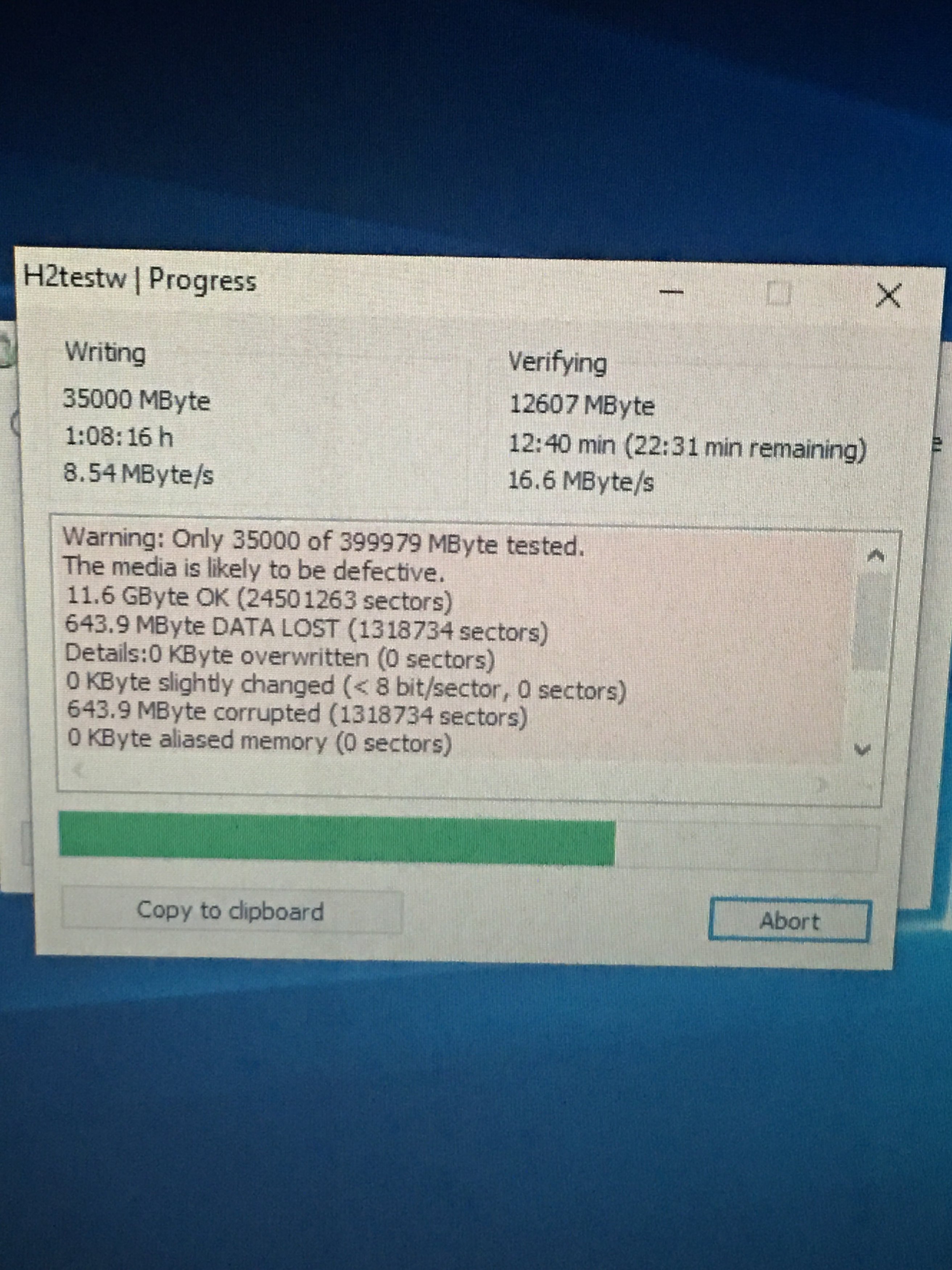

UPDATE 2: I uploaded the test results H2testw and I guess it confirms its a fake SD card and that where my problem is. I dont know if I feel more ashamed or angry to get caught with this. I guess ill leave this post up to help out any other poor soul that this happens to.
UPDATE: SD CARD might be FAKE!!! I paid alot of money and the sd card came in official packaging. H2testw right now! I will let you guys know.

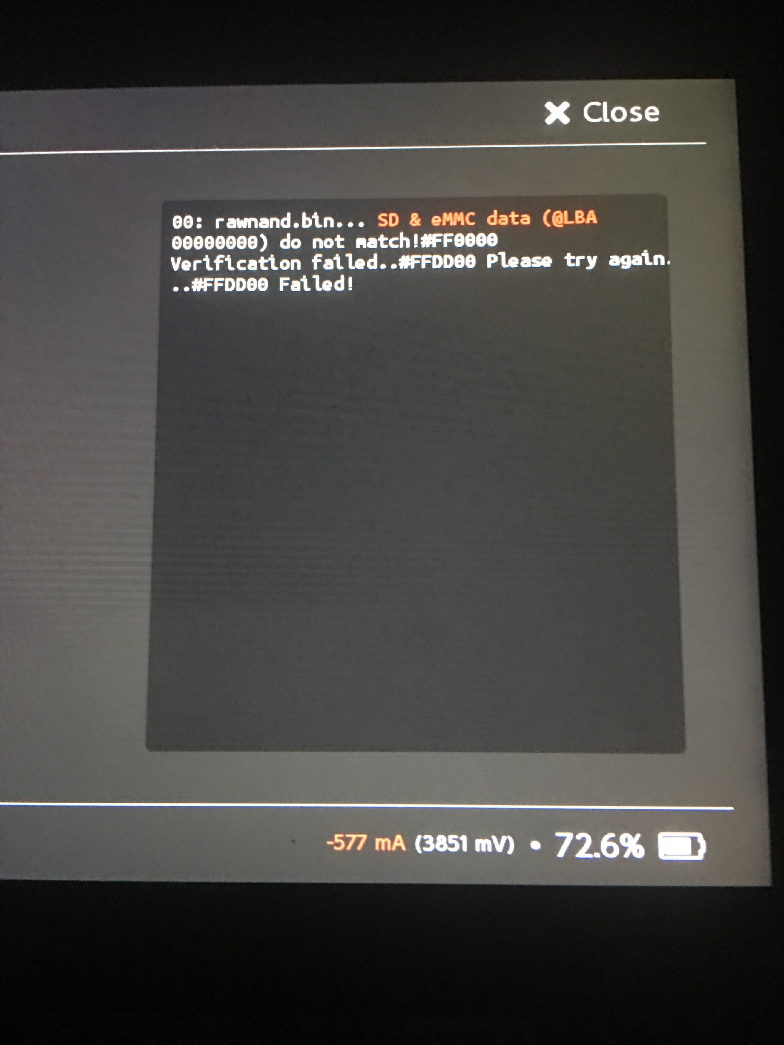

Attached is 1 image of rawnand.bin failing verification. I dont know why and ive googled alot but no answers. And I did try guiformat.

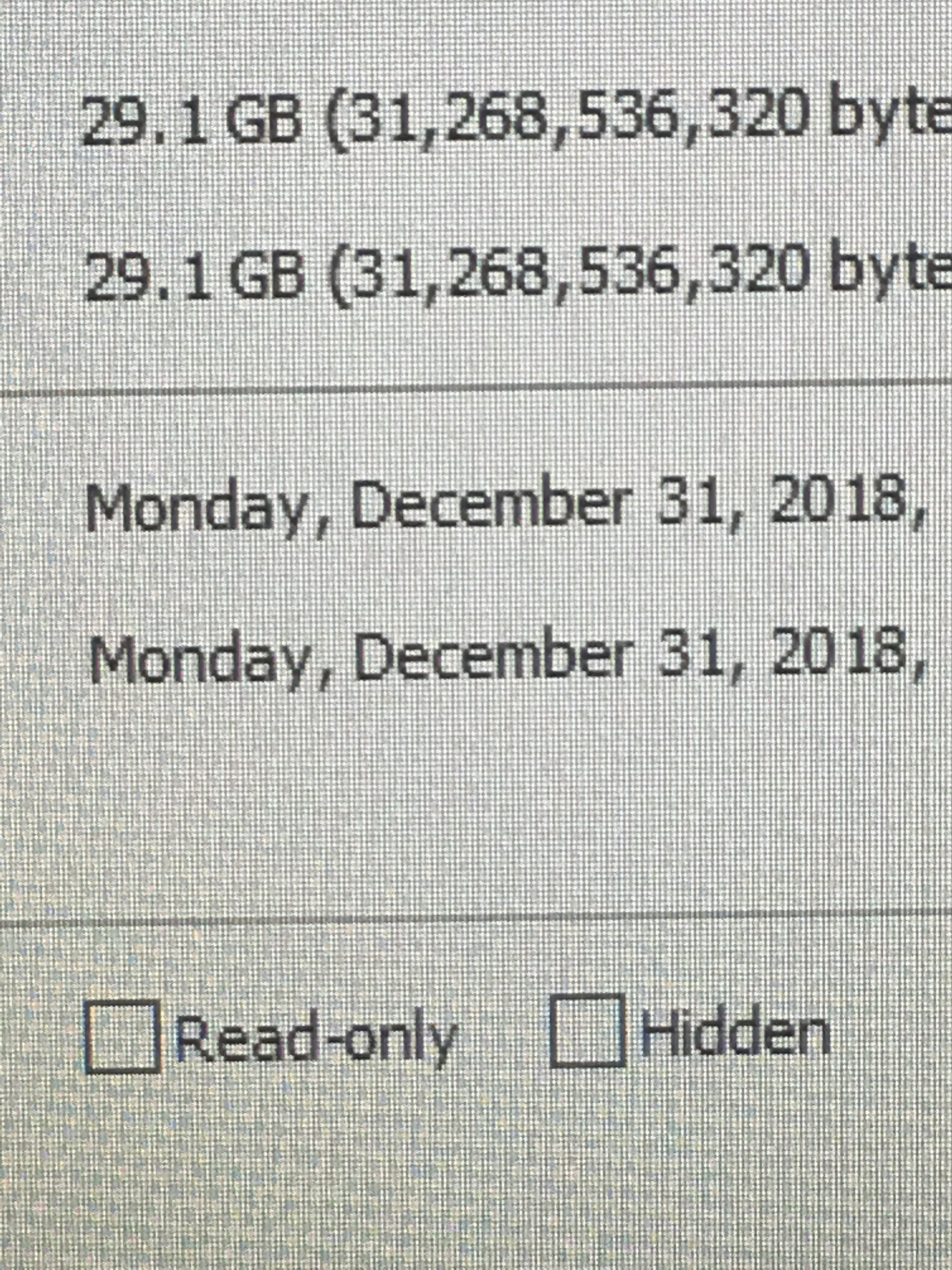

The other image is rawnand.bin size. It seems to be the right size and doesnt look corrupt.

Clean switch. Trying to make backups using hekate (5.0.1) before moving forward. and i wont move forward until im sure my nand is good to go plz help

delete the dumps and try again. even if it doesnt look corrupt, theres that chance that evern one little byte of data could be corrupt and causing problems.
I did 4 times. Verification fails on different percentages, like sometimes 0% or 5% or 40%.
I dont know if its my SD card exfat format 400gb causing it. And it seems no one else is having this problem, only this 1 post i found but it was a bug in a lower firmware of hekate.
Everytime i try a backup it takes a long time, ill keep trying until it works or someone helps me. If it works ill post that it did. Plox help someoneeeee.
