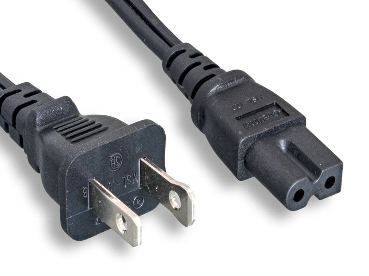

Can I use a ps4 power cable for a fat ps2

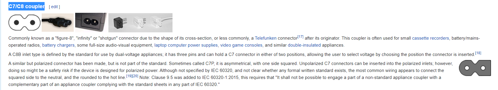

I don't have a PS4 myself, but after a quick Google search, it seems it uses a figure 8 (IEC type C7/C8) connector. If that is correct, then it should be compatible with the phat PS2 as well. Besides, the power conversion happens inside the PS2 itself, so as long as the connector fits, and is meant to be plugged in a wall outlet, there shouldn't be an issue in terms of electrical compatibility
