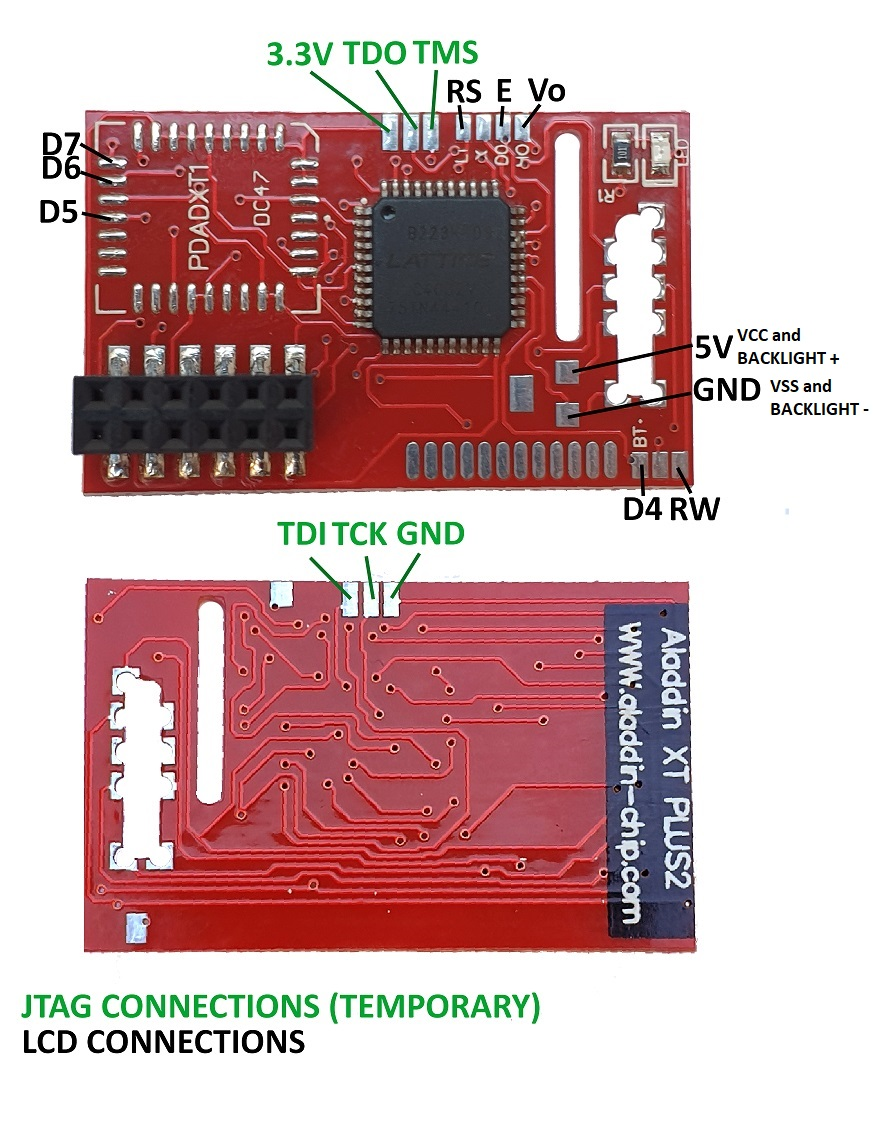

You must have prior soldering experience before proceeding. This is in no way, shape or form, a guide on how to solder.

3. Next, use a set of male-to-male jumper wires, and solder the JTAG connections from the Aladdin chip to the FT232 adapter as follows:
Aladdin XT+
FT232RL
+3.3V +3.3V
TDO RTS
TMS CTS
TDI RXD
TCK TXD
GND GND
(ENSURE THAT THE JUMPER ON THE FTDI IS SET TO +3.3V AND NOT +5V!)
4. Open a new terminal window inside of the current directory of "/bin/" and type "sudo ./openocd -f openocd.cfg" (no quotations) and press Enter. OpenOCD will wait until a debugger is connected. Then, in another terminal window, type "xterm -e telnet localhost 4444" (no quotations), from there, you can send commands to OpenOCD.
5. Inside of the Telnet window, type "svf" followed by the filename of the SVF file you wish to program (i.e., svf "1MB OSSUPPORT.SVF"), then press Enter to write it to the chip.
6. You're all set! :D
