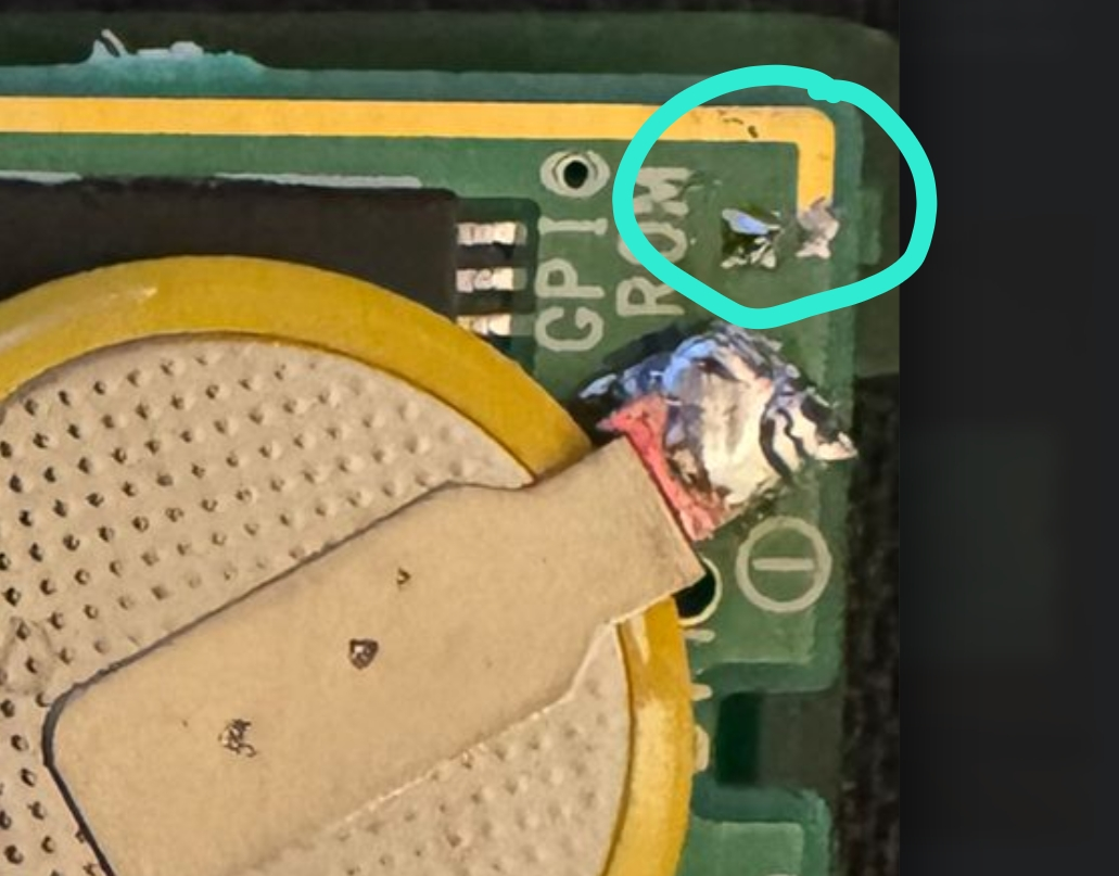

Hello, im unable to dump my copy of pokemon emerald since replacing the battery.
its kinda weird, it plays perfectly fine and backing up the savedata works flawlessly but dumping the ROM gives me data integrety errors or incorrect dumps with every method I tried (GB Operator, GBxCart, GC to GBA Link Cable dumper)
I attached a few pictures from my copy maybe there is something yall see. I try to dump it tomorrow without the battery, maybe thats the problem but not sure.
its a german copy if that helps

thats the next step I try, i was just posting this thread in advance to check if maybe someone sees something unusual on the board that i miss

Do you always get the same ROM dumped or does it change between dumps? If it changes try cleaning the contacts some more with some proper IPA 90%+ and a q-tip until the q-tip stops getting dirty.
If you don't have any IPA at home you can also gently use a regular pencil eraser, just don't go too ham on the pins.
Edit: on some closer inspection, the leg of the battery on the left side is a little close to the pins of the chip there, maybe double check you don't have any shorts there.

i removed the battery to make sure the legs dont short anything out but sadly same results

That's not an md5 I am seeing anywhere, so chances are pretty high it is a bad dump. What's the label say, any markings for a revision? There shouldn't be any for Emerald / Smaragd but who knows.
Also, what software did you use to dump the cart when using the GBxCart RW? If you used insideGadgets's own software you could give LesserKuma's FlashGBX a try. That one has a few extra diagnostics tools on board.
Last but not least, just for a giggle you could drop the ROM into gbata and check if that thing can either recognize any damage or thinks it's a valid dump and spit out some extra information about it.

If you're getting dump errors "but the game plays fine", I would wonder if some part of the ROM is broken. I have a Pokémon Blue cart with what I can only guess is a damaged ROM, given how the contacts are squeaky clean but the Nintendo logo check still fails. Unless something else went wrong, you may have damaged the ROM itself when swapping the battery somehow - or it was already damaged and you just didn't know.
I would suggest dumping it multiple times and making sure you have the same checksum across all dumps - if you do, it's most likely not a contact issue, but rather a damaged ROM. Of course, depending on where it's damaged, it might be fine. Not likely, but possible.
