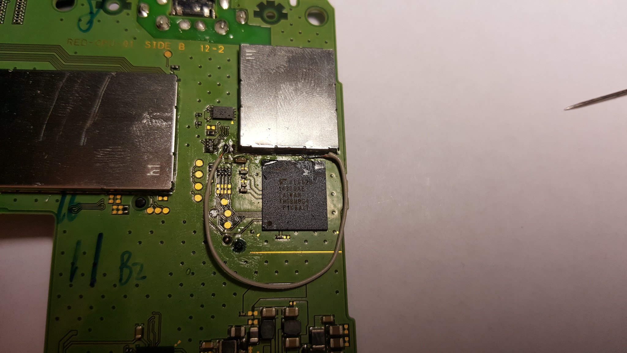

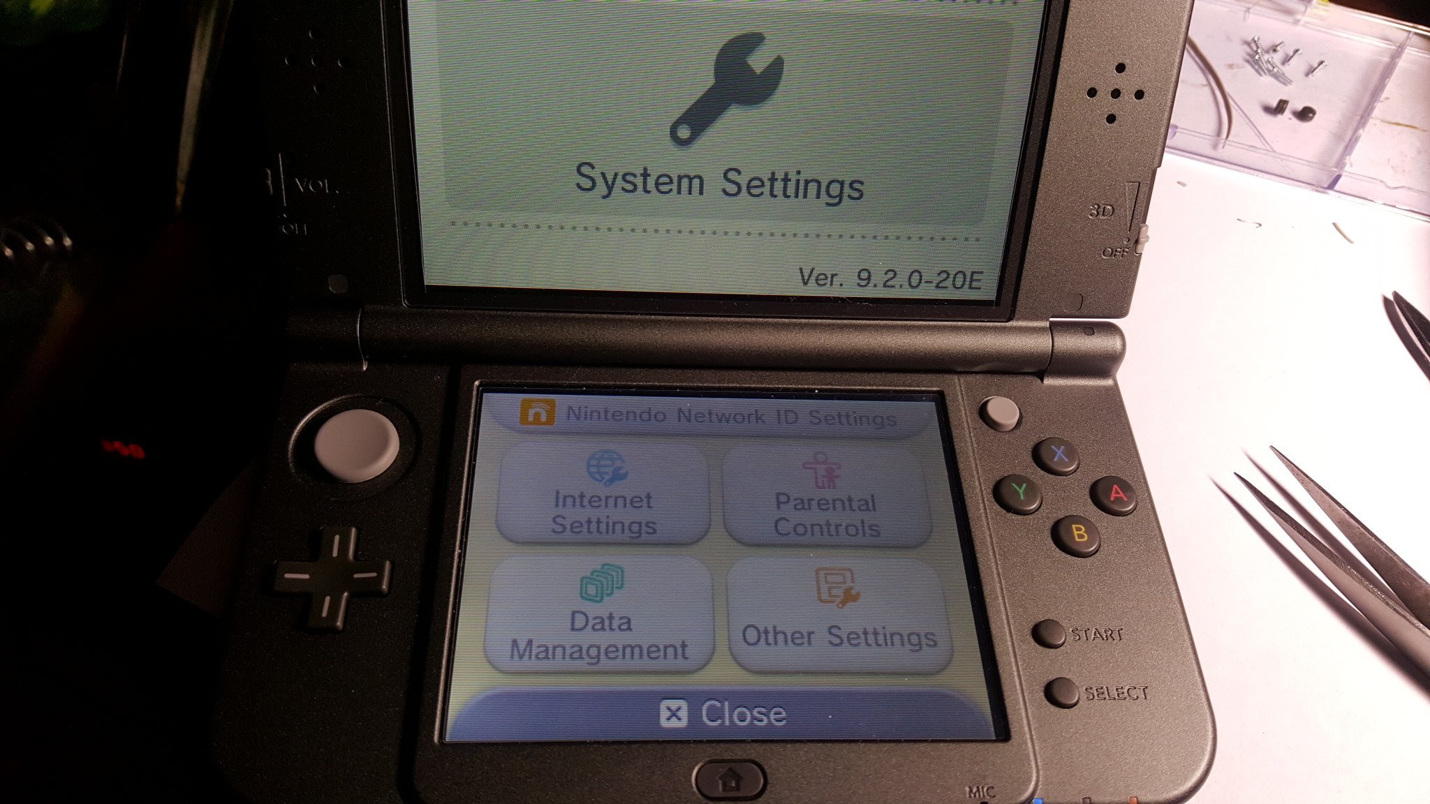

Ι have the following problem :
After a succesful downgrade 10.4 to 9.2 the coslole was in complete working order . After that , i have decided to removed the 4 cables CLK ,DATA0 SMD and GROUND because for me they are not usefull now in 9.2fw .
After console assembly i try to power on and i see the blue bottom screen as before in hardmod work.
i have disassebly the console and i found clk and the upper solder pad are missing . This is cause the problem for that mallfuction ?
Please can you help me and tell me what is wrong?
Can i fix it ?
If solder a cable (bridge) just like in the photo solve my problem?
i have already uploaded 2 photos of my problem to be more clear .
Thank you in advance for you hospitality and help who i found in your site
Best regards,George!

well i cant see you photos maybe upload them and post the links to them lol imgur is a good image host
but fixing the solder points should hopefully fix your problem since you are not getting a working circuit which is causing an error from the sounds of it

The images are ready.
If solder a bridge you think solve my problem?
Thank you for your quick response!

well if the 2 are linked then soldering a bridge should hopefully fix your issue, if not something else may have been damaged on hardmod removal

The 1 console I messed up, I tore off the bottom left joint. Never could get it fixed, and I tried bridging it with only solder. Isn't there a micro via under that one? It must be connecting to something somehow... The OP is extremely lucky to recover from that.
With that said... NEVER pull on a wire when desoldering, and NEVER use more heat than when you are soldering. The first step to desoldering is to ADD MORE SOLDER. A good joint does not melt easily with an iron, but nothing conducts heat better than liquid solder. As soon as you melt new solder onto the joint, the joint will melt and you can suck it up with a solder sucker or some braid. The wire will just come off naturally.
